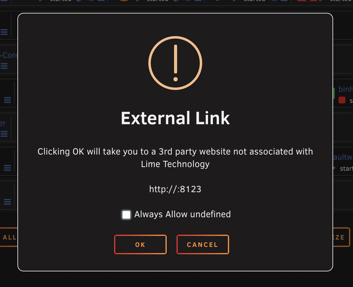

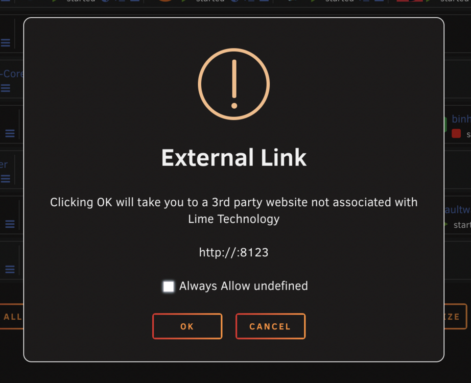

[Plugin] FolderView2
I recently did an update to 7.1.4 and now my docker containers are acting up in various ways. Sometimes when I click the WebUI link, it opens up a blank Chrome window with the following URL: about:blank#blocked And other times, I clock on the WebUI link, and I get this pop-up which I've never seeing before warning me about an external link. However, when I clock the "OK" button, nothing happens, it's just broken. I can't seem to find a rhyme or reason why these errors are happening. It happens in Chrome and Firefox and I've tried on two on different computers. I seems to be related to the FolderView2 plugin since the problem doesn't happen if I disable the FolderView2 Plugin.

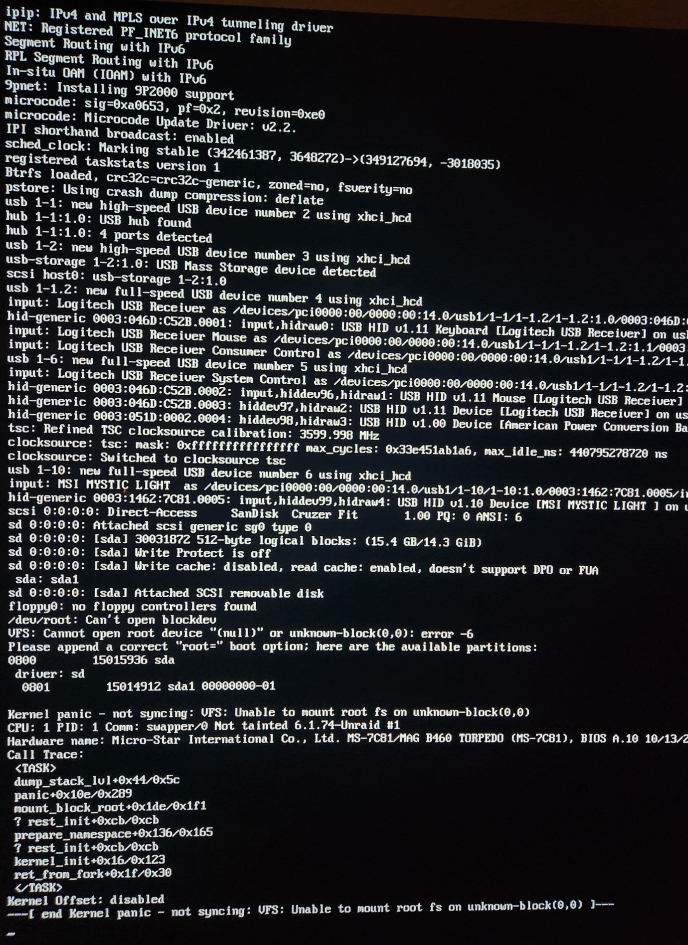

Thanks so much itimpi! Copying over the bz* type files and config.txt from a zip from the UnRaid website fixed the issue and allowed me to boot back up into UnRaid! Before copying the files over, I had Windows do a file error check on the drive but it found nothing. However, when copying over all the files on the drive to my computer as a backup, I did notice that the copy process froze on one of the bz files. My guess it that there was some corruption or other problem where that file was. Do you think that this a sign that my flash drive is on its way out?
Kernel Panic not syncing VFS error after clean reboot
I did a clean reboot of my system an hour ago and now see this error. I didn't make any changes to the server config. I was just troubleshooting a fuse hidden file issue so I thought a reboot would fix that. I don't think that is related to this sync the fuse file was on a mount point, not the actual config for the flash drive. Any thoughts on what I should do to test? I assume I might need a new flash drive but before ordering a new one I'd like to try out other options.

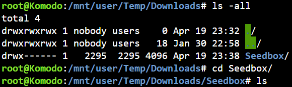

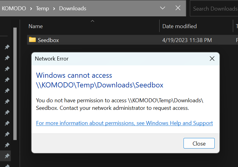

I have moved the mount to /mnt/addons. How do I now properly get /mnt/addons to be shared over SMB to my Windows computer? Can I turn it into a share somehow or is there another method?
Share contains sshfs mounted directory | Can't access directory within Windows, but can in Unraid
I have a share called Temp. I have mounted a remote share over sftp with sshfs (using user scripts), and had it mount at /mnt/user/Temp/Seedbox The user script is as follows: #!/bin/bash sshfs -o reconnect,ServerAliveInterval=15,ServerAliveCountMax=3,allow_other,ro,port=22,IdentityFile=/root/.ssh/seedbox/id_rsa [email protected]:/media/ /mnt/user/Temp/Downloads/Seedbox If I navigate to that directory within Unraid, I can get into that folder and see the files within it totally fine: However, if I try to access that folder through the share in my Windows computer, I get this error: I have tried to change permissions for the folder but am unable to and get the following error: chmod: changing permissions of 'Downloads/Seedbox/': Read-only file system I do want that directory to be Read-only, but I also want to be able to view it through my Windows computer which has mounted the Temp share. How to I make it so that I can access this folder properly through my Windows computer, and not just directly from the Unraid?
