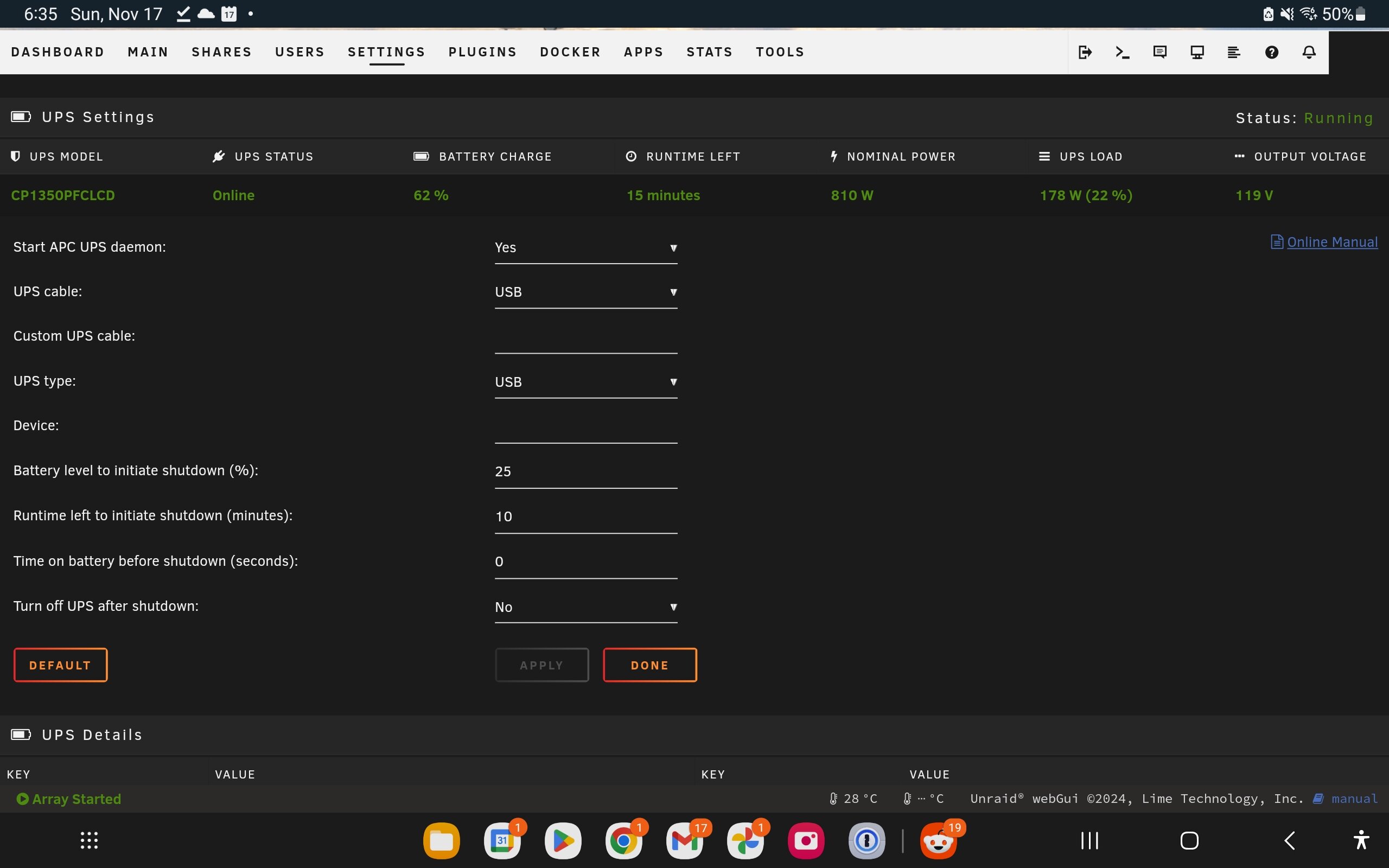

Had a power outage over night and according to the email notifications at 12:35am the power went out and at 1:00am the "remaining battery charge below limit on UPS Tower" and shut down the server. When i started the server back up, it said an unclean shutdown. Not sure why it would. The only thing i can think of is Disk Setting - Shutdown Timeout set to 120. Maybe thats too long or too short? Looking at my plex logs, the last playback was at 11:20pm. I dont have any VM's that could keep it hung up, just dockers (plex/arrs...) Any ideas why? tower-diagnostics-20241117-0626.zip
