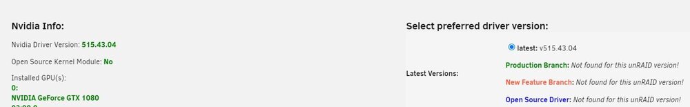

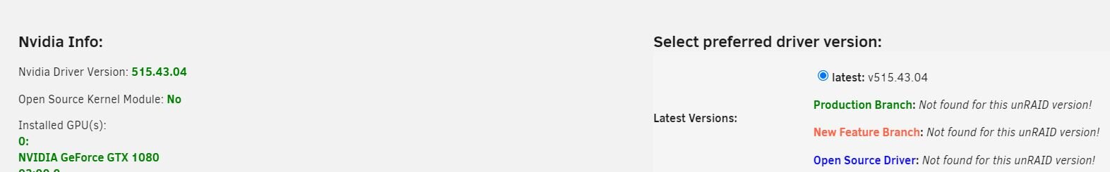

  3. Hi to everyone. One question there I have faced issue when ffmpeg (inside fileflow docker) give me an error about outdated drivers for nvec encoding (required 520 minimum). But I have only 515.43 available in Nvidia driver settings, while I can see latest 555.52 linux driver on Nvidia web site available. Is this my issue? Or it is not available for installation with Nvidia drivers plugin?
