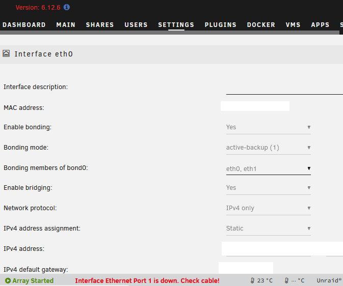

  2. I only have 1 NIC connected to my home network. So are you saying that there could be an issue with the 2nd NIC on the blade I'm running my unraid server on then?

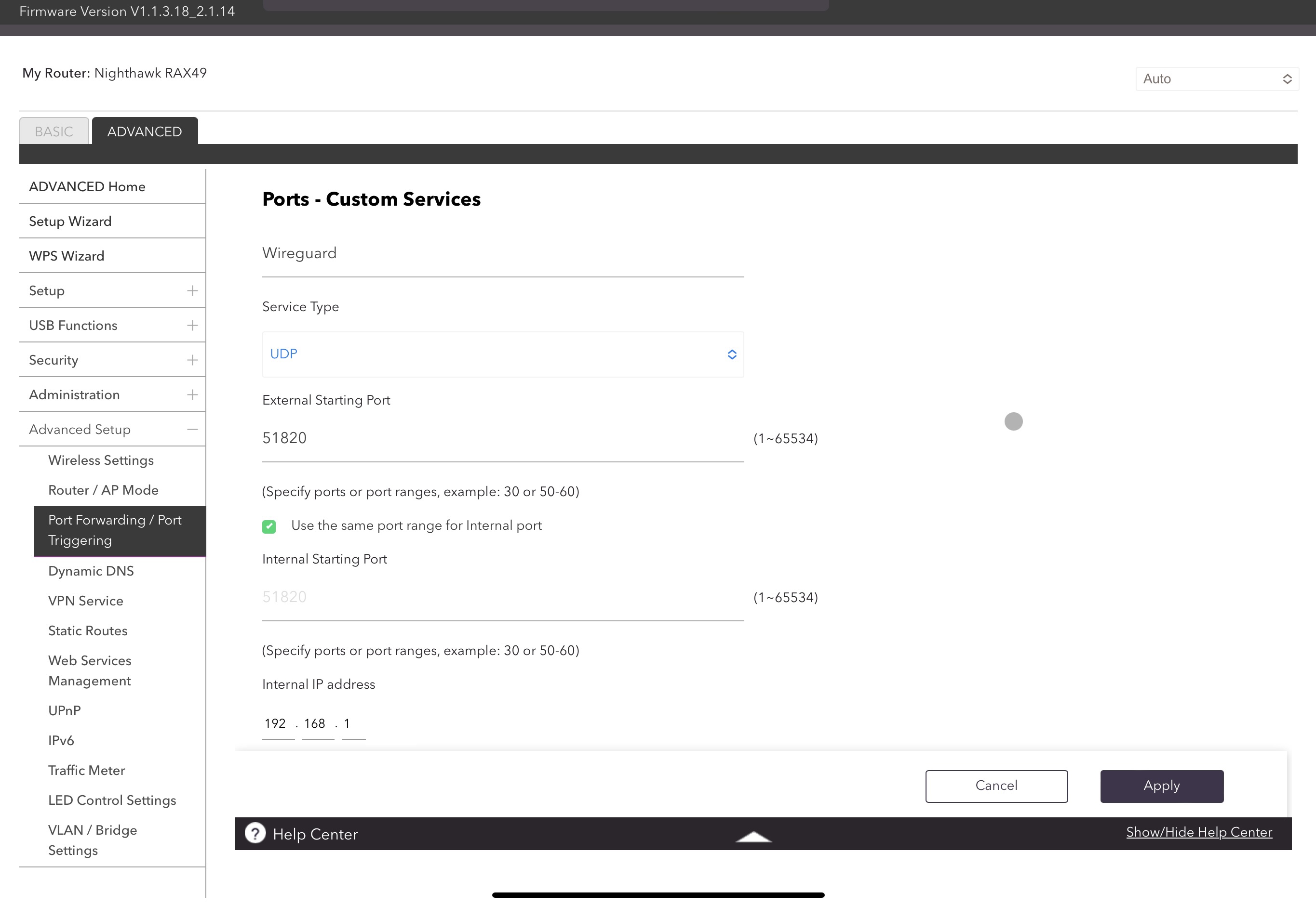

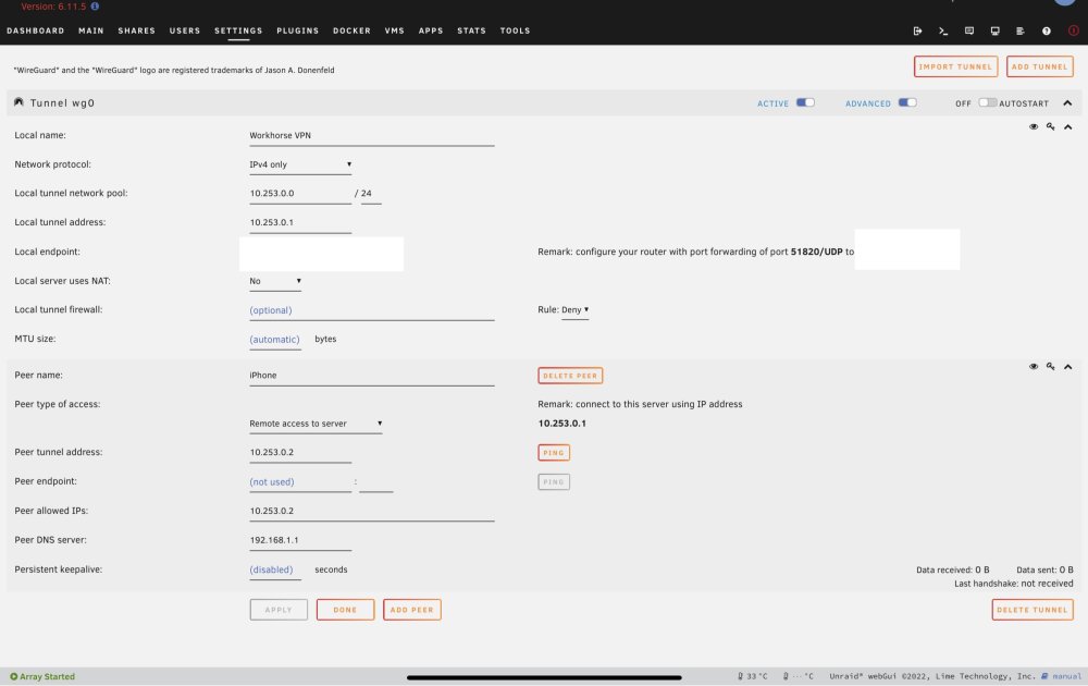

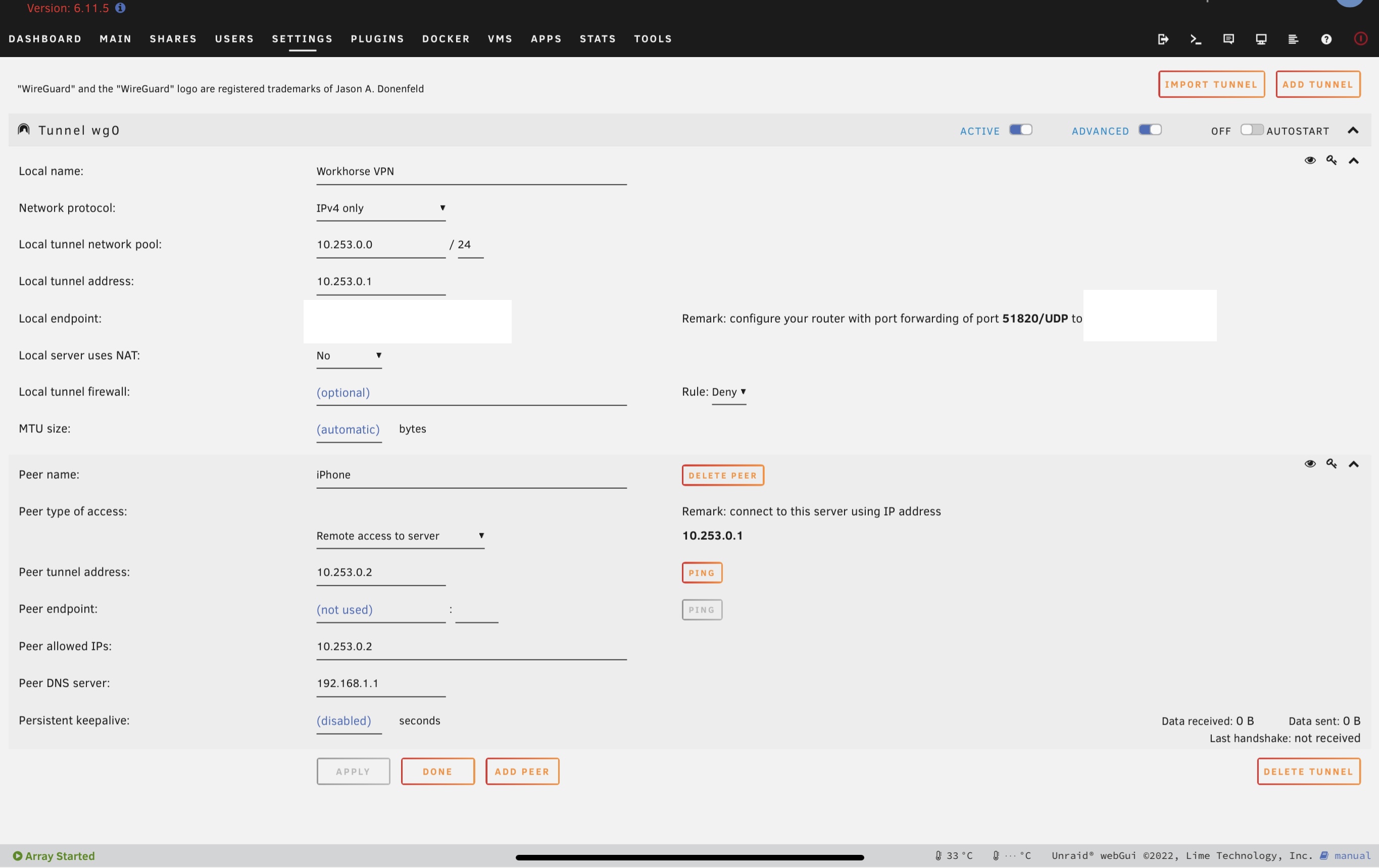

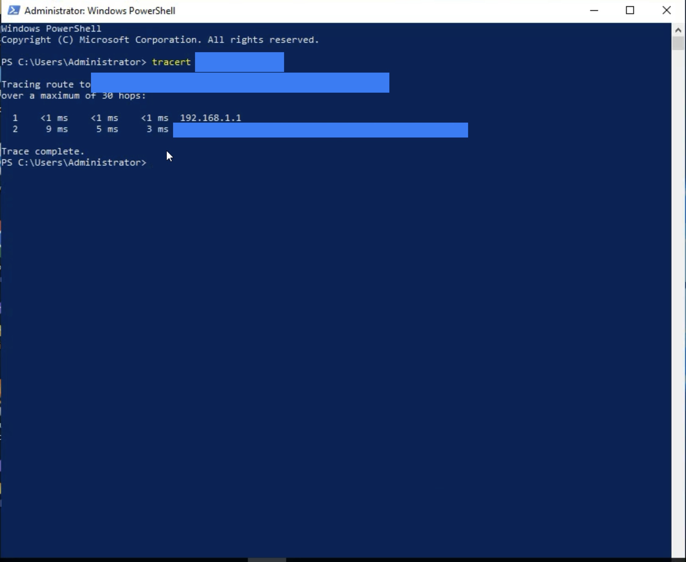

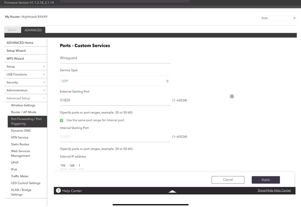

  4. A few months ago i replaced my router. I then also proceeded to update unpaid OS to its current version at that time. I tried to use WireGuard after all this ands it wasn’t working. I then got busy with home and work and wasn’t able to get back around to troubleshooting the issue. Now i have been able to get back trying to troubleshoot the issue and this is where i stand. Long story short i went back to a clean slate. Remade my domain on DDNS deleted the original tunnel created when i had WireGuard working. Followed steps on page 1 and it’s not a complex network and to no avail still unable to connect to server from external means. When i go to do my port forwarding on router it doesn’t seem like it works. And even the tunnel screen shows that it still doesn’t see port forwarding connected via the server. I also tried upnp connection and nothing worked while trying to connect that way either. After each change made on the router i did perform a reboot since i wasn’t sure if it would need a reboot for change to take, because i know that was 1 of my issues the first time i tried setting it up in the beginning a few years back. I go into the logs on both unraid server and router and don’t see the IP of server. I also did a trace route to see if my ISP is using CGNAT. And am not 100% sure if that may be my issue. I have attached photos to see if maybe anybody else sees something i missed. And I understand the photo of tunnel setup screen says forward port but that is already set in my routers port forwarding. Any ideas are greatly appreciated.

  6. I will look into the updating process to go from the version I am at now to whatever the newest is. If it seems like too much of a task I may have to wait until after the holidays and then try. But I will check the first 2 posts again in the thread and make sure I didn’t miss anything. You don’t think I would have to go back to nothing and re set up everything again do you? I mean with WireGuard. Not server. 😂 😂
