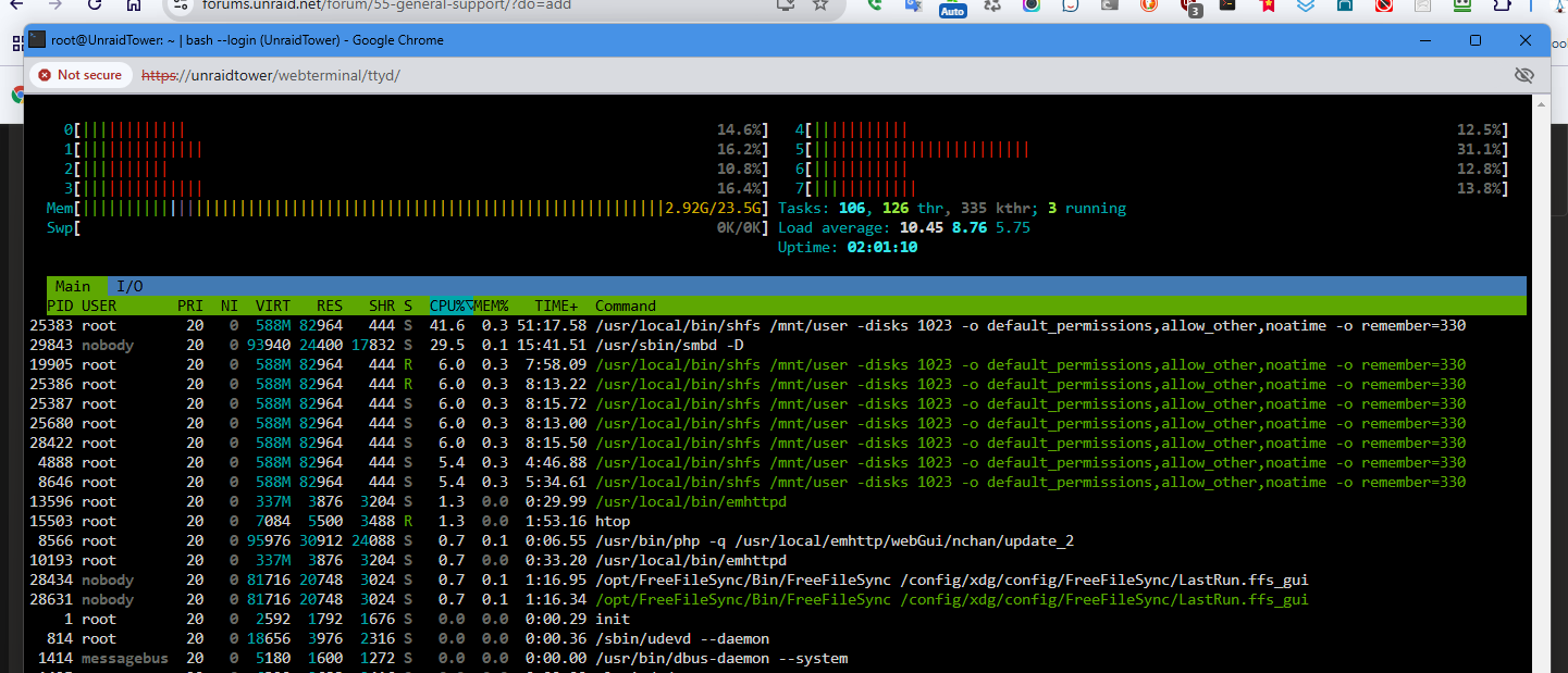

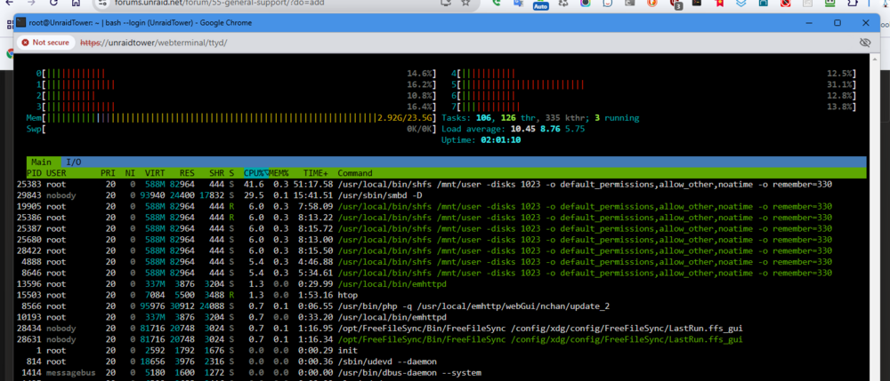

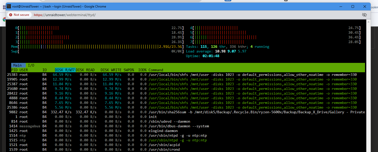

  5. Thanks for the detailed response. I should have mentioned that I run iperf docker on my unraid and have a 10gb network. I tested that part prior to posting and the throughput is over 700mbs. I run automated periodic smart tests on all my drives, checked that but perhaps I missed something so I will look at it again. Can you expand a little on resource exhaustion you mention? I will look closer at the htop stats over a longer period of time. Appreciate your time and comments.
  6. Would like to understand this SMB behavior in a file transfer using FreeFileSync on a Windows 11 PC to an Unraid Share. The share uses reconstruct write and writes directly to array, no cache is used. The file transfer (example is using larger files so that small file size does not skew the result) starts at 120Mbs and gradually drops to 0, climbs back up and repeats this behavior. Using htop, on both the main and io tabs, the behavior is also shown, logs do not seem to indicate any disk or network issues (though I may have missed something) I assume there is some type of cache or resource exhaustion issue but I do not understand it. Attached are clips of the htop screens, the file transfer screen on the Windows 11 PC, and a diagnostic with my logs. I attached clips so the drop and recover process could be shown dynamically You can see the drop to 0 at 1.20 mark on the FreeFileSync MP4 Any information or insight appreciated. FreeFileSync Recording 2024-11-17 122430.mp4 unraidtower-diagnostics-20241117-1241.zip
