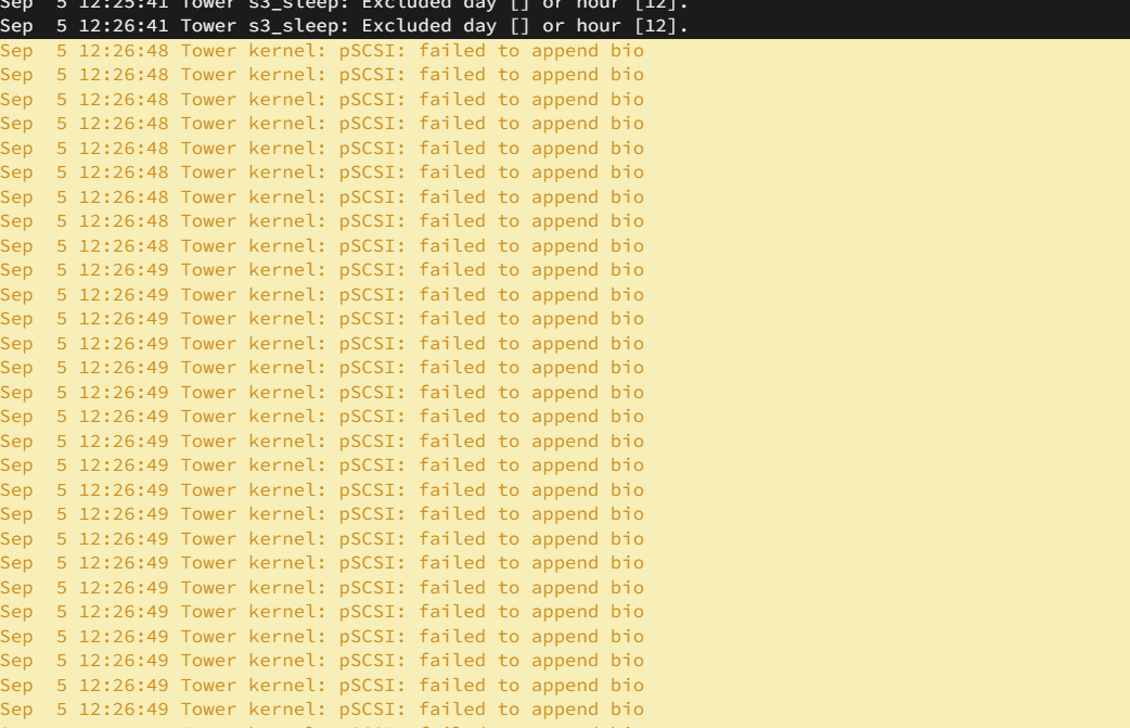

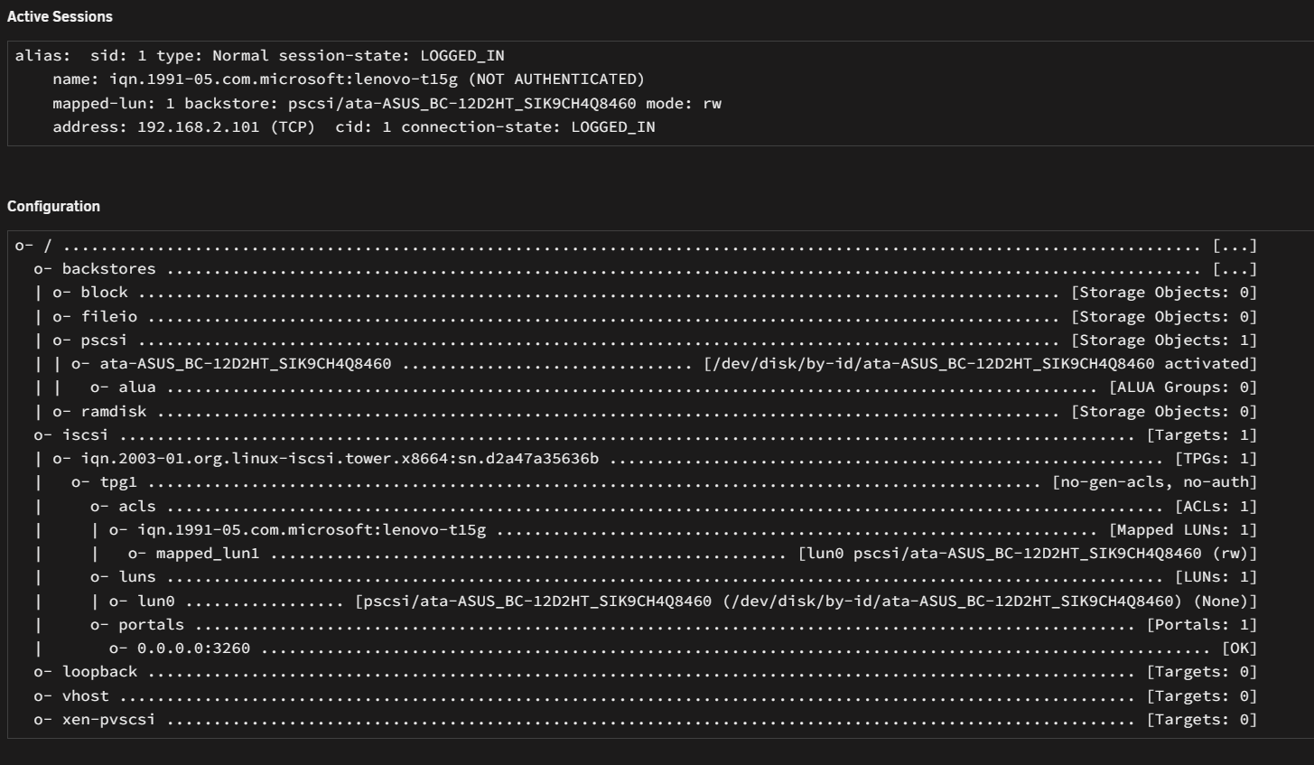

  2. I used your plug-in to link a Blu-ray drive, with the following configuration. I tried the hard drive and it worked, but the Blu-ray drive didn't. I saw that the blackstore type was pscsi, so I suspect I should use block instead. However, this happens automatically when adding the drive. Where can I modify it? the unraid logs said: pSCSI: failed to append bio
  3. Here is the config, HDD works well., DVD driver had been remove and LUNS had been deleted
  4. thanks,I have use your iSCSI Target plugin and connect with a harddisk by windows iSCSI Initiator, it works well, but I also want to connect a DVD driver, it can be connected , but when try to read disk, it is leg and dont' work very well
