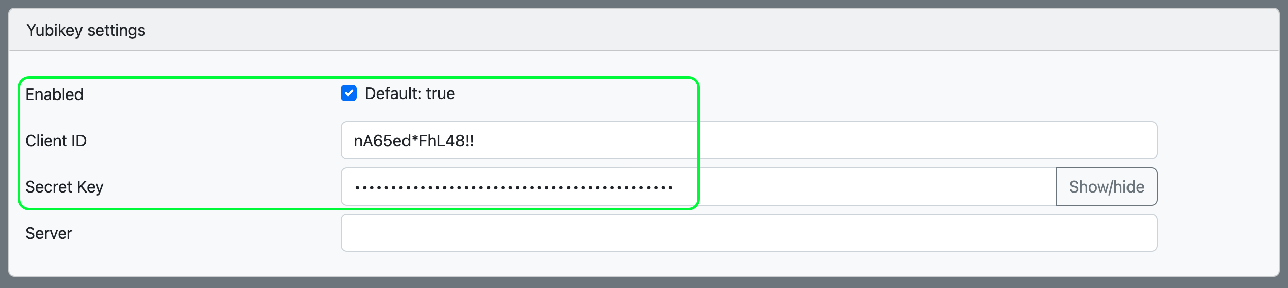

  4. you need to access your admin panel and turn it ON. In the admin panel under 'Yubikey settings'. You also need to generate the environment variables `YUBICO_CLIENT_ID` and `YUBICO_SECRET_KEY` Save. Then just log into your Vault and go to (top right) Account Settings > Security > Two-step Login > Yubikey Manage.

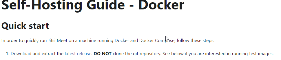

  25. -The docker-compose and the jitsi docker image stack needed updating. -Also noticed the official Jitsi self host guide points out NOT to clone github instead to download from stable release. -So i just blew it away. I recommend doing the same.
