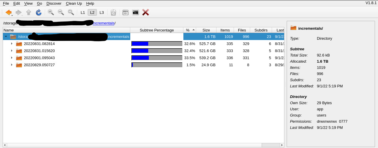

  7. df reports the same usage yeah. I made more sparse files so now the reported total size is 2.2TB root@Antec:~# df -h /dev/md7 Filesystem Size Used Avail Use% Mounted on /dev/md7 9.1T 2.2T 7.0T 24% /mnt/disk7 This is what the QDirStat docker shows when I look at folders that only contain those sparse files:
  8. root@Antec:/dev# stat -f /dev/md7 File: "/dev/md7" ID: e508de7bfbef56ab Namelen: 255 Type: tmpfs Block size: 4096 Fundamental block size: 4096 Blocks: Total: 2048 Free: 2048 Available: 2048 Inodes: Total: 2028594 Free: 2027960 All drives give the same result...
  9. I stumbled on a problem with how free disk space is presented by Unraid on the main tab. I recently added a new disk to my array. It appears as there is already 1.77 TB of data on it. However I know in reality there is much much less data. Using rclone I accidently created a bunch of "large" sparse files that use 0 bytes of storage. The actual size of all files on that drive is under 20 GB. On a smb share I see the sparse files as having size zero. Using ls -l I get 0 size for the sparse files. Using ls -s I get the large size that uses no actual disk space. From what I understand, this looks like a bug.
