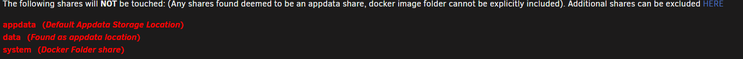

  4. Yes, it turned out some of Sinusbots files were being detected as appdata, I moved them out and all is good.

  6. Hi All, my data is located in a share named data. I need to fix permissions however when I go to new safe perms I get "data (Found as appdata location)" Im not storing any appdata here, I think unraid is getting confused because the name is data? Ive combed through the dockers and cant see any issues. I can run the command to fix the permissions myself, but id like the ability to use the GUI.
