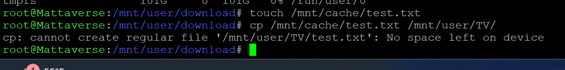

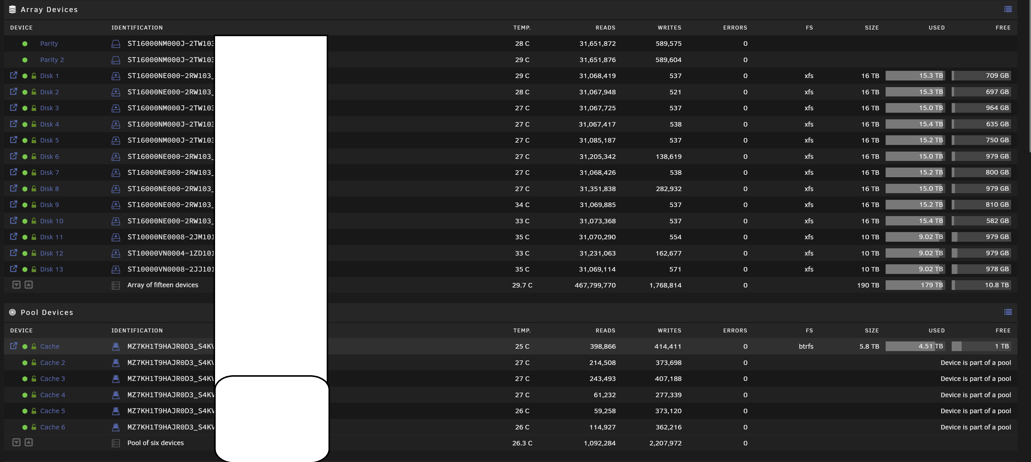

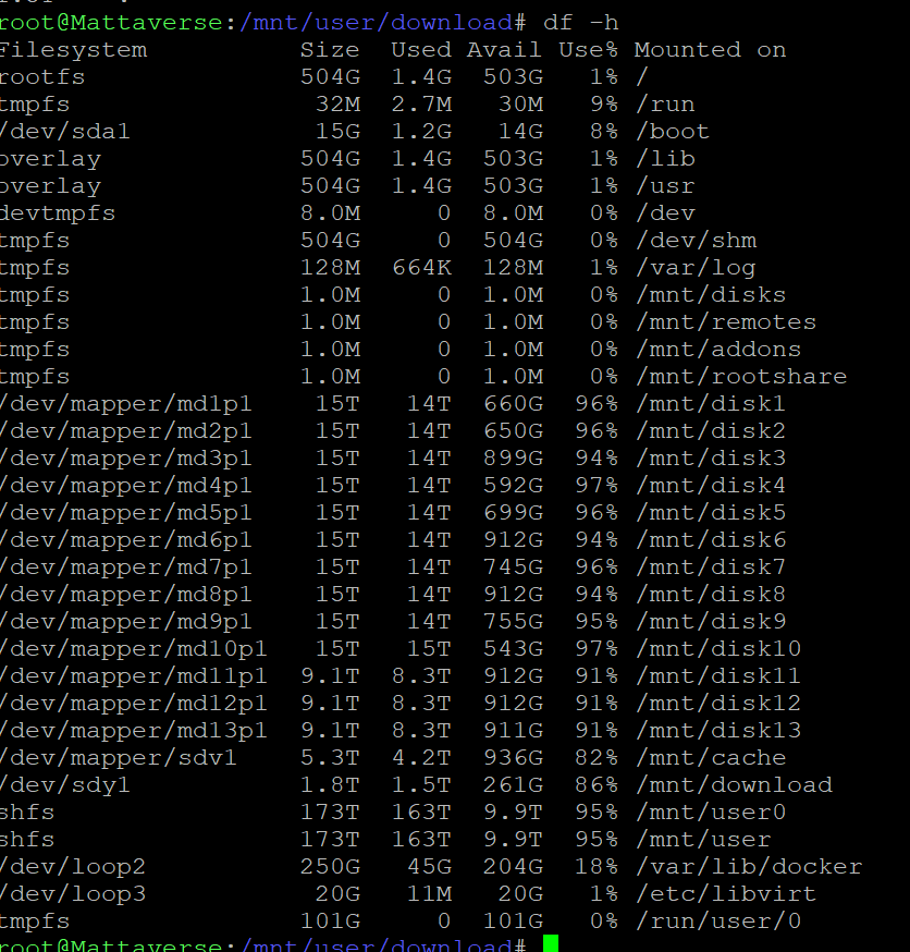

  4. Hi All, struggling with an issue. My array is telling me i have 10TB free but i can not move anything onto array as i get No Space Left on Device. Cache is fine, but cant do anything with the array. Have attached my diag. mattaverse-diagnostics-20240701-2032.zip
