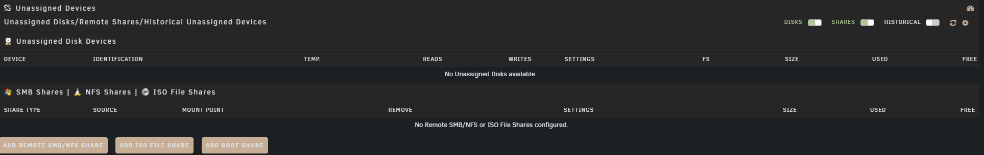

  1. I have a problem, mine remote share mounts are most of the times not shown. only after a reboot of the server then maybe I'm lucky sometimes. is there a fix for this, I already reinstalled the plugin and deleted all files from UD, but still no luck. also I've seen an error when changing settings and saving it. 1. 2. 3.
  2. Hi, I also have received the same error for the last few weeks sometimes. I was able to solve it with this command after looking into the .err logfile 2022-01-05 23:39:32 0 [ERROR] mariadbd: Can't create/write to file '/var/tmp/ibXXXXXX' (Errcode: 13 "Permission denied") 2022-01-05 23:39:32 0 [ERROR] InnoDB: Unable to create temporary file; errno: 13 chmod 777 /var/tmp
