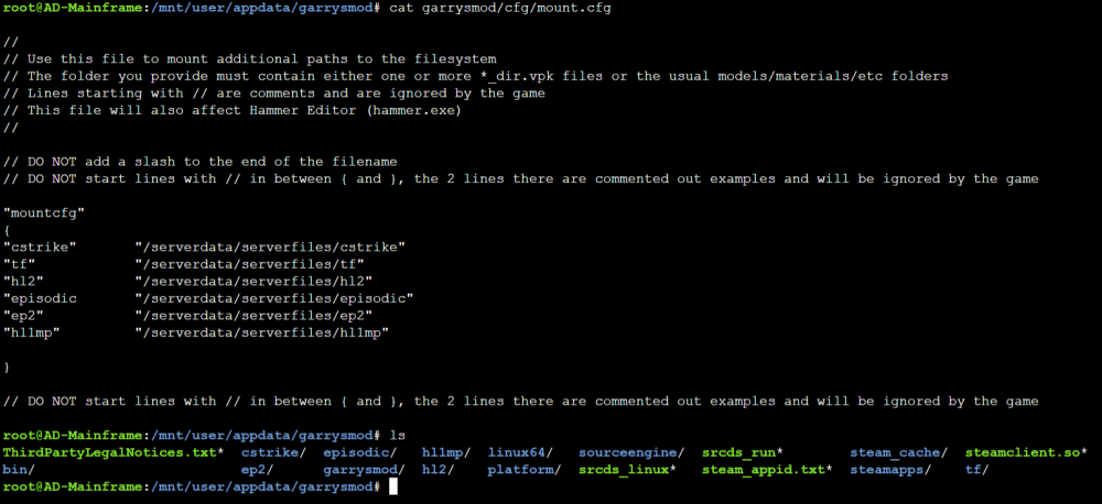

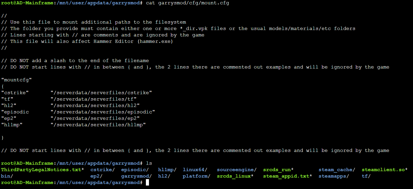

  15. Hey, i have a problem. I wanted to set a password on my garrysmod server. This is normally done by editing the server.cfg in garrysmod/cfg/ and adding sv_password "PASSWORD" to it. However i cannot connect to my server using that password. Gmod tells me it is wrong. Have you encountered this yet?

  17. So after a little bit more talking the solution was found to be moving the data folders of the needed games to the appdata/garrysmod folder with the server install and change the mount.cfg to /serverdata/serverfiles/data_folder_name for each game. Thanks again btw
