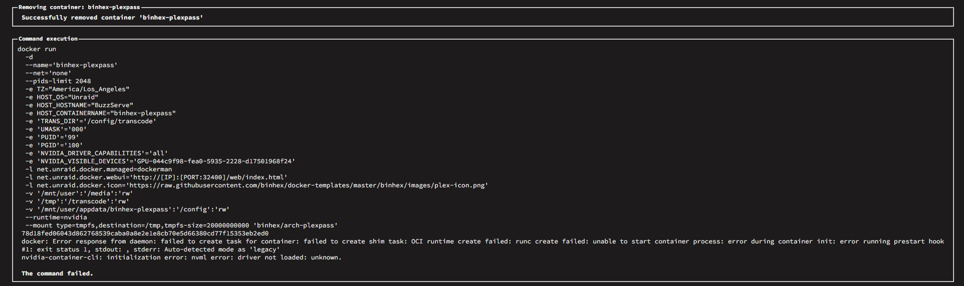

  1. I had to downgrade to the Production Branch. Unraid wasn't seeing my GPU under the v590.44.01 driver. Problems fixed!
  2. Working through an issue after updating to 1.43.0.10389-1-01 and updating Unraid to 7.2.2. After the update, the docker image gave the "Execution Error - Server Error" message and failed to start the container. I tried rebooting/removing/reinstalling the image; this was my result: I came across this: Docker Fails to Launch GPU Containers with NVIDIA Runtime, but Podman Works - Docker Engine / General - Docker Community Forums Seeing how that post identified their container issues related to their GPU, I removed the host keys related to my nVidia GPU in my configuration the container was at least able to start. Seems like there's a CUDA issue with the driver version vs. the one I had installed? Anyways, this at least got my docker container back up and running so I can troubleshoot the rest of the issues. Wanted to post this here in case anyone else was having an issue.
