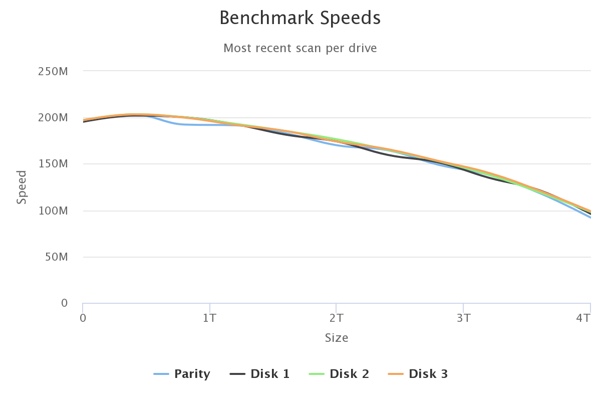

  1. Ive been having an issue with parity suddenly becoming slow, tried reboots and stopping all docker containers with no luck. (Currently getting 8MB/s when previously I had 65MB/s) After reading some posts on here people suggested updating LSI firmware but im not sure where to start. I have a IT mode flashed Dell H310 which I did a few years back and have no clue how I did it. Could someone assist in helping me find the right files and a guide on how to do this? I did find this but not sure what to put into the broadcom website to find the correct firmware. (lspci shows `LSI SAS2008 PCI-Express Fusion-MPT SAS-2`) Also Ive attached diagnostics and a diskspeed graph incase its not this causing an issue.(
