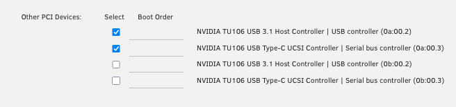

Thanks for your post. Beg to differ, but according to post "Two Win10/i440fx GPU passthrough VMs work flawlessly, but new Win11/Q35 gives BSOD -please help" they do show up as Other PCI Devices as per his screenshot below. He is using Unraid 7.1.4 as am I

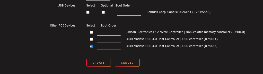

They are definitely bound 0a:00.0 VGA compatible controller [0300]: NVIDIA Corporation GP107 [GeForce GTX 1050 Ti] [10de:1c82] (rev a1) Subsystem: Micro-Star International Co., Ltd. [MSI] Device [1462:8c96] Kernel driver in use: vfio-pci Kernel modules: nouveau 0a:00.1 Audio device [0403]: NVIDIA Corporation GP107GL High Definition Audio Controller [10de:0fb9] (rev a1) Subsystem: Micro-Star International Co., Ltd. [MSI] Device [1462:8c96] Kernel driver in use: vfio-pci 0b:00.0 VGA compatible controller [0300]: NVIDIA Corporation TU117 [GeForce GTX 1650] [10de:1f82] (rev a1) Subsystem: ASUSTeK Computer Inc. Device [1043:871c] Kernel driver in use: vfio-pci Kernel modules: nouveau Pic of them not showing in Win VM template Old Win VMs that have a GPU passed thru still run Ok using the GPU that was passed thru. Hoping you legends can help as I'm out of ideas
