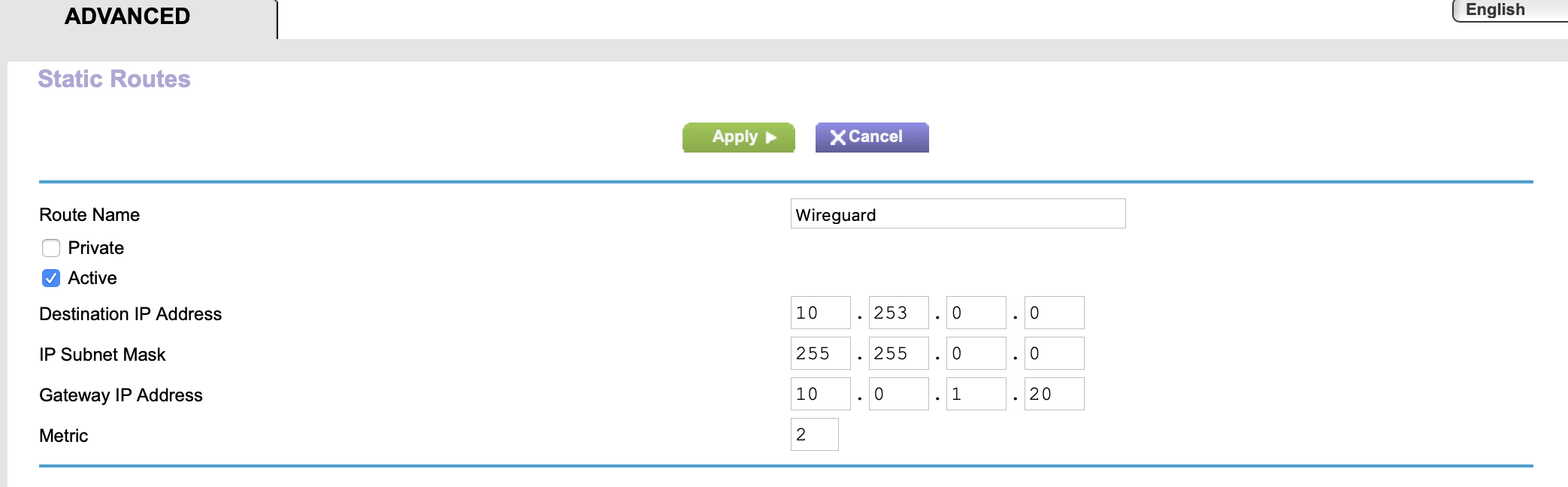

  8. Squid, Thank you for the reply. I created a static route in my netgear router but I still am unable to connect to those containers. Screenshot attached of my router configuration. The Unraid machine's ip on the lan is the 10.0.1.20 I think I have everything else right though. I tried checking and unchecking the private box.
