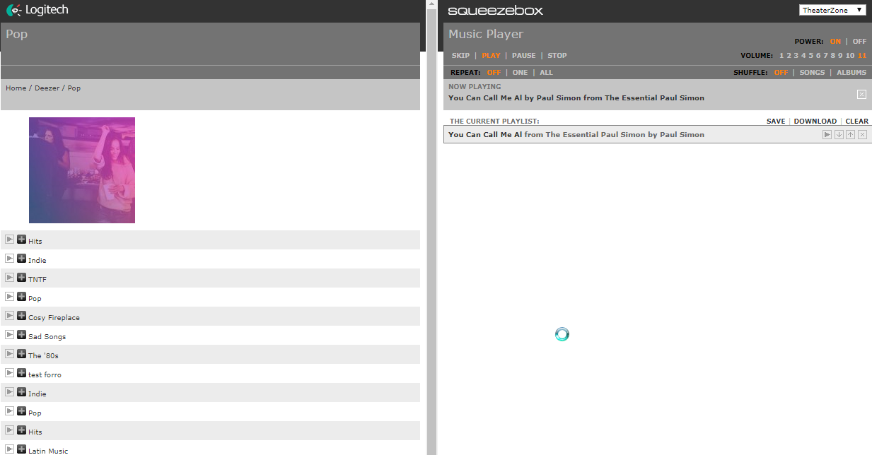

Not sure what the heck is going on. The Default skin is even worse. Then there is a "Light" skin that, well, I won't even discuss. I've tried removing/deleting the docker files and starting over again. I've tried the different LMS dockers, but still getting that awful view.
[support] dlandon - Logitech Media Server
Anyone else get a new look to the server? Don't personally like it, is there a way of changing it back to how it was? This is my server view now:
