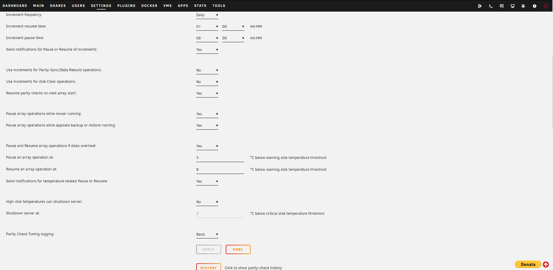

  15. Great ideias. Before updating to the latest version you pushed I realized that plugin was pausing and resuming as it should so I took the logs. Another issue that I realized is that warning temperature is set to 60 and pause threshold set to 3 degrees below that but it's only pausing in a higher temperature like 61 or 62. tower-diagnostics-20220405-1235.zip
  16. I will test this new version and report with logs here. You said that if parity was paused bacause disk overheating and if it spin down before reaching resume temperature so it would be treated as cooled down and parity should be resumed. Just as an ideia wouldn't be a better option keep the disk spinning in that situation until it really cool down and so resume parity would make sense? I think that if parity resuming when disk spin down would have trouble if it's still warm and pause parity again and restart again after spinning down and so...

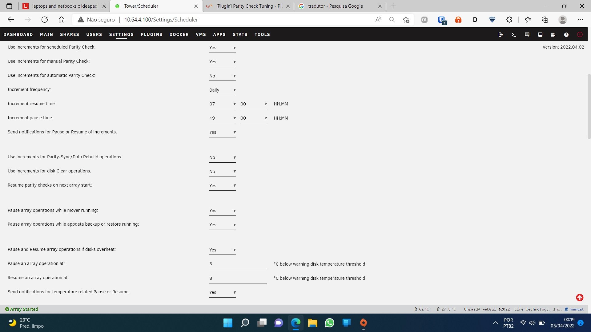

  17. so i enabled increments for manual parity checks and changed increment pause and resume times to extend the parity window. tower-diagnostics-20220405-0011.zip
