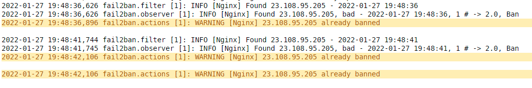

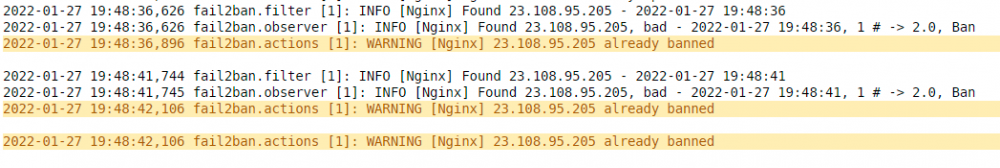

  7. I am not sure what I did wrong. The difference between yours and mine is just cloudflare. I do not have subdomains proxied via cloudflare. I am trying to set it up for nginx. the logs displays ip is banned (I am using vpn to test the fail2ban). But I can still access the services. I asked in the reddit to see if I can get quick response. Here is the link to the detail issue and configuration I am using, fail2ban detecting IP but not blocking : fail2ban (reddit.com) I saw you were using different config for the action. So I gave second try with exact configuration like you and still stuck with the IP not being actually banned. Any idea?
