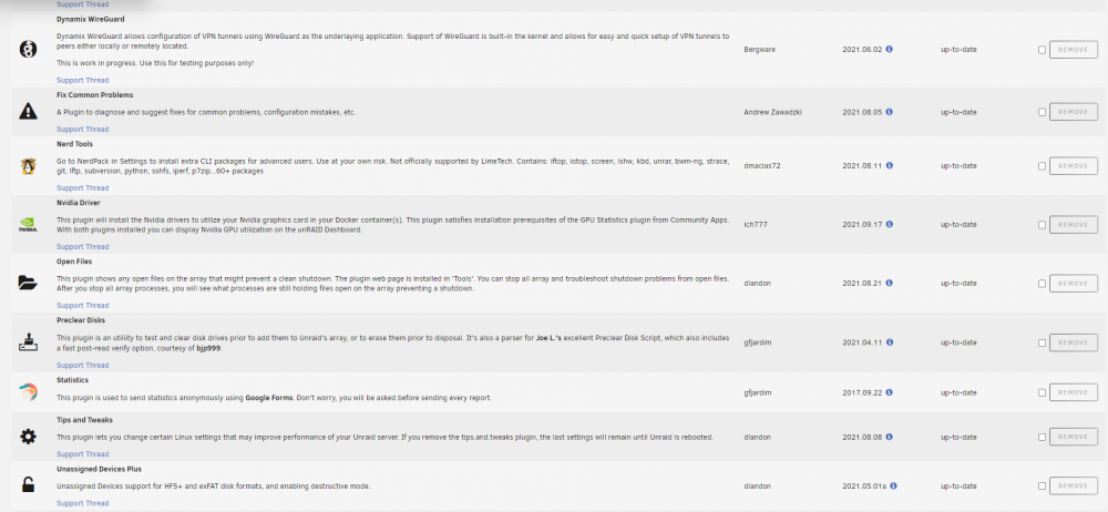

  1. Hi guys! I'm having some trouble getting my new Quadro P2000 to show up properly. It shows up in Tools > System Devices as [10de:1c30] 0a:00.0 VGA compatible controller: NVIDIA Corporation GP106GL [Quadro P2000] (rev a1) but nowhere else. When I attempt to open Settings > Nvidia Driver, the page never loads. If I try to run the command nvidia-smi as instructed at the top of this post, nothing happens at all. The terminal just freezes. I've uninstalled and reinstalled the Nvidia Driver plugin. Here is my plugins page: And attached is my diagnostics file. Please advise, thanks! Edit: One other thing that is probably important - I noticed once I installed the card into the HP Proliant DL380 G8 server, it stopped using the onboard VGA output for the local CLI. Maybe the machine itself is taking control of the GPU, but I'm not sure how to prevent that. counterpart-diagnostics-20211207-1951.zip
