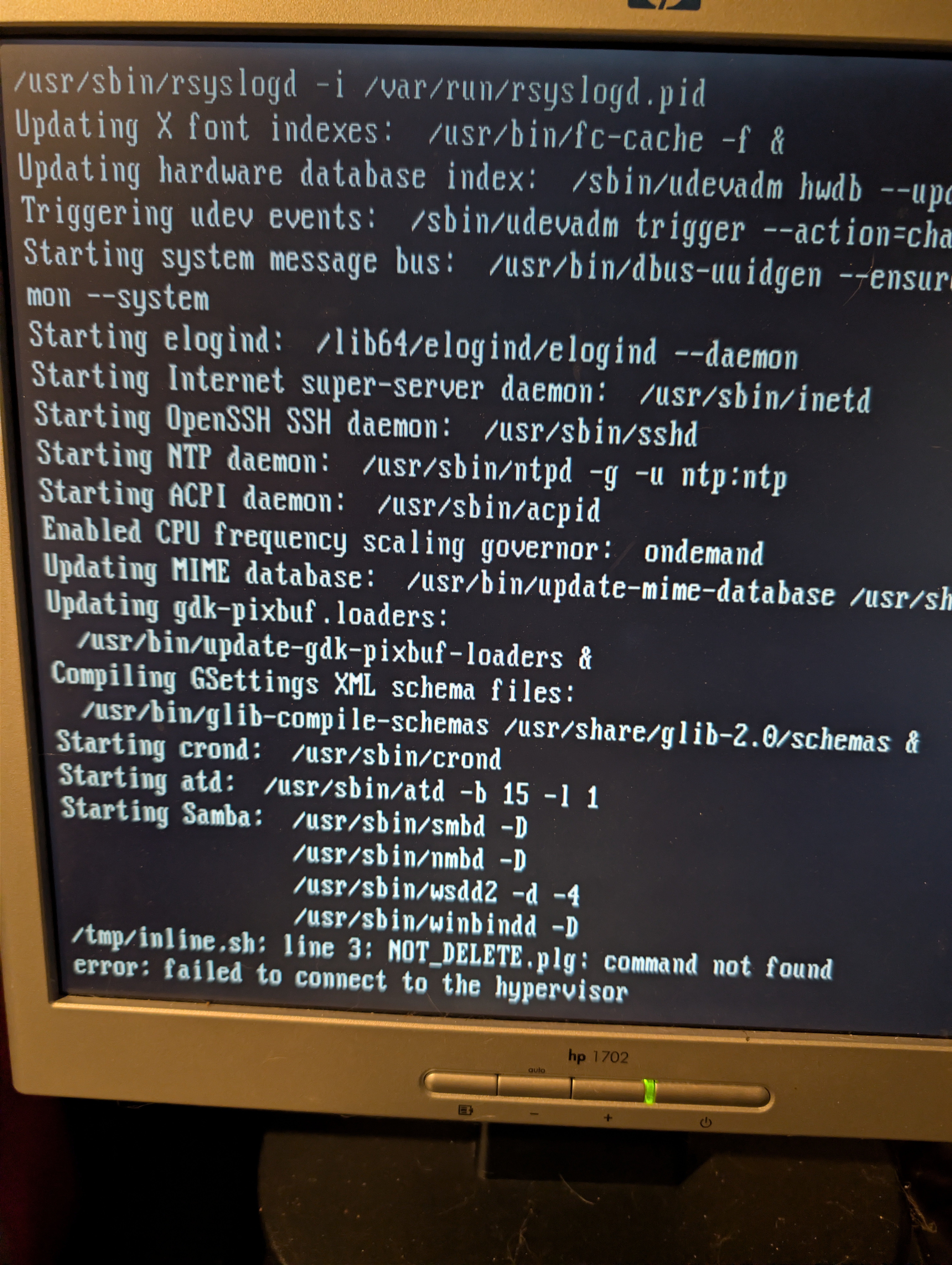

Boot Failure
I dont quite recall. I know i was using it in an earlier version, but dont know if i am in this one. I guess i just need to disable all plugins and see which one is causing it as suggested above.
Boot Failure
Diagnostics Attached. I pulled these from the WEB while in SAFE mode. tower-diagnostics-20260814-0858.zip
Boot Failure
No the machine is running on bare hardware not on a VM. I was able to boot the server in Safe Mode (no plugins, no GUI). I havent changed any plugins in quite some time and not sure how that would be causing an issue connecting to the hypervisor on boot. Any insights on how i can get this back to running normally?
Boot Failure
I am getting an error about being unable to connect the hypervisor on boot and it halts. I cannot get into the GUI.
