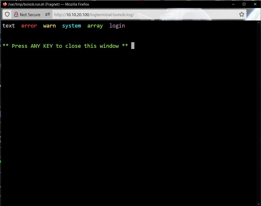

  2. Hi, Thanks for the reply. This is a image from the log option when left clicking the docker icon. Can you guide me in a a newer way to connect my sonos app to Navidrome ?
  3. Hi there, i know this is an old topic, but i am trying to install the "bonob" container to connect to Navidrome, but i cant get the container to run. It shows that it installs correctly but on the docker page, it reports as stopped. Even if i start it manually, after a few seconds it shows as stopped again. I try to view the log, but it only shows a "Press any button to quit the page". I am running unraid 7.1.1
