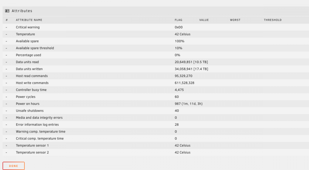

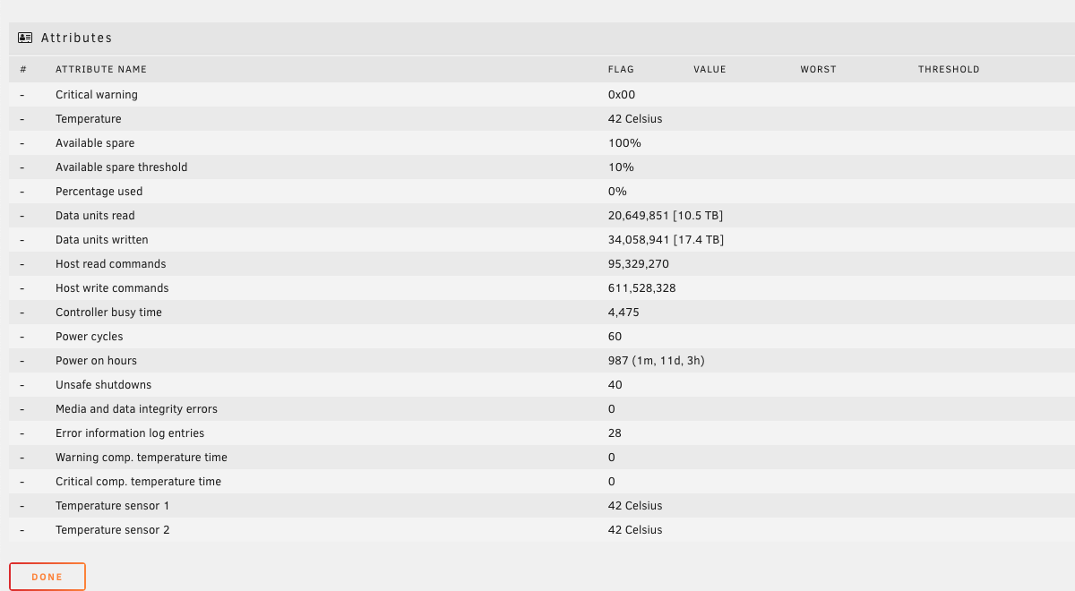

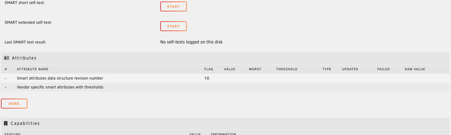

  10. Dear friends, After I updated my server to unraid 6.9.2 I cannot see my drives attributes in the GUI. The only one that shows up is my nvme. It has been a while, and I cannot figure it out why. In my diagnose files, attributes are there. @FlorinS how did you manage to find which plugging was conflicting? The only difference I can think, besides the NVME been NVME, is that NVME was installed after my unraid server was updated to 6.9.2. I look forward to hearing from you guys, Lucas Mendes whitehouse-diagnostics-20210803-0937.zip HDDs and SSDs NVME

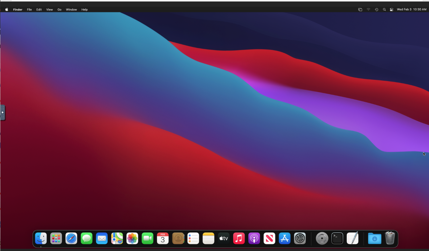

  19. I had the same problem with Macinabox BigSur after removing the graphic card and trying to get back to VNC. I also had to change the controllers that were on bus='0x00' slot='0x01' to slot='0x02' to fix the problem. Thank you!!!!! This community is AMAZING!!!!
