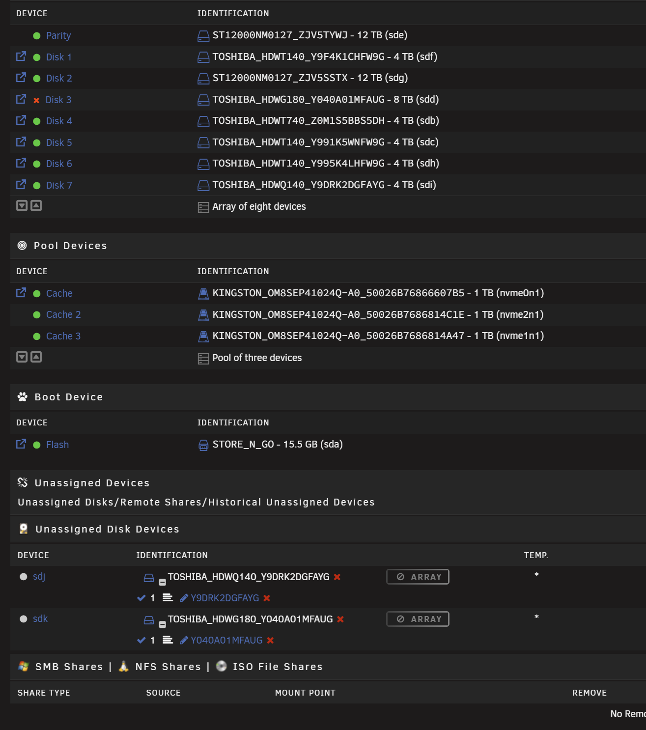

All those files inside Lost & Found doesn't make sense cant determine any of those files belong to where. Lucky Disk 3 are mostly my Media collection and now I've check with Radarr and those listed Missing and I've need to source those missing media again.

Hi @JorgeB Thanks for the suggestion. I've try to replace the 8TB with another spare unit and now its rebuilding as i scare of loosing any data and felt more save to rebuild from the parity. Just a question is there a way to make it faster on the rebuild as i notice the rebuild only around 160MB/s Is there anything that i can tweak on the Disk Setting to improve the throughput?

I got alot of files in lost & found folder. what should i do. seems there are alot of corrupted files before this and whats my next step?

Below is the detail from the check filesystem status. What's the next action plan? Phase 1 - find and verify superblock... bad primary superblock - bad CRC in superblock !!! attempting to find secondary superblock... ....found candidate secondary superblock... verified secondary superblock... writing modified primary superblock Phase 2 - using internal log - zero log... ERROR: The filesystem has valuable metadata changes in a log which needs to be replayed. Mount the filesystem to replay the log, and unmount it before re-running xfs_repair. If the filesystem is a snapshot of a mounted filesystem, you may need to give mount the nouuid option. If you are unable to mount the filesystem, then use the -L option to destroy the log and attempt a repair. Note that destroying the log may cause corruption -- please attempt a mount of the filesystem before doing this.

ts-p500-diagnostics-20250728-2054.zip Hi @JorgeB Here's the latest diagnostic log after reboot.

It it save I can just power down the Server and reconnect the Drive and power. because i notice both drive 3 and Drive 7 are on different enclosure. Once power on how should i do to reenable the drives? Because i only had 1 parity.

I just notice that 2 drive suddenly was unassigned error array and one of the 8TB drive was disable and I don't understand what's the problem and by looking at the dashboard I'm also confuse one of the unassigned drive are still active and the other one are Disable. What should i don now. ts-p500-diagnostics-20250728-1804.zip
