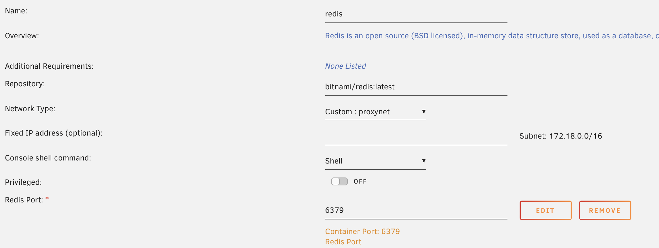

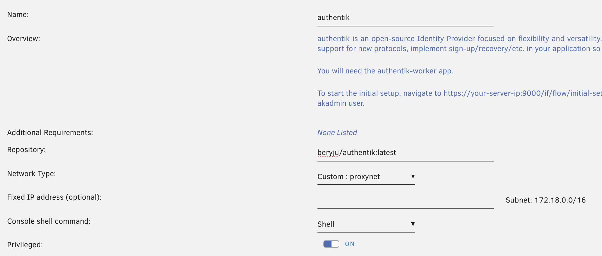

  16. Hey, have had an annoying issue for the last couple months and can't wrap my head around it. Authentik just randomly crashes (which blocks access to my services) and upon further inspection in the Docker logs I find the following (repeated like multiple times, rest of logs normal): I'm running beryju/authentik:latest Docker container on Unraid in a bridge network and it works fine, but now just randomly crashes sometimes. Tried replacing the hostname 'redis' with my local ip, didn't change the issue. When checking redis, it ran without any issues during the crash. Did anyone have a similar issue or has an idea what's going on here? Redis and Authentik are running in the same docker network called proxynet (just as adviced by spaceinvader one). Also Redis is running without interruption, so it should be able to connect. Does anyone have an idea what could be the issue? Thanks for any help! (Attached two screenshots of Redis and Authentik configuration)
