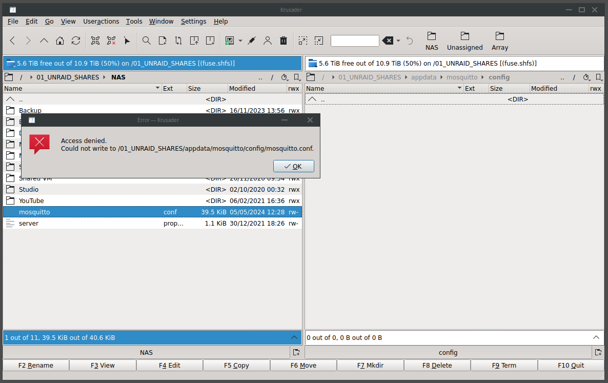

  3. Seems like it is only the mosquitto docker container appdata folder i am being denied access to.
  4. I didn't think about that. Thanks, here is the diagnostics file. vault-diagnostics-20240505-2010.zip
  5. I have somehow lost access to my appdata folder? Or at least Krusader has. Why? And any suggestions on fixing this?
