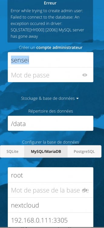

  10. here it is, If now on I'm not responding quickly it's because I'm going to work. Thanks Hummm, I did try to setup with a wrong mysql password, and I've got the same error!!! Stange, I can connect to the db using docker exec....

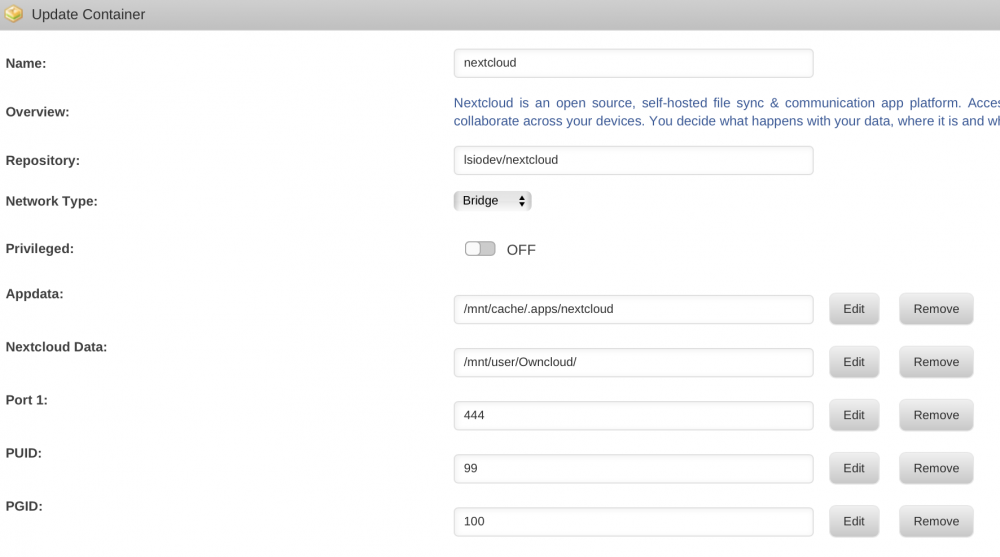

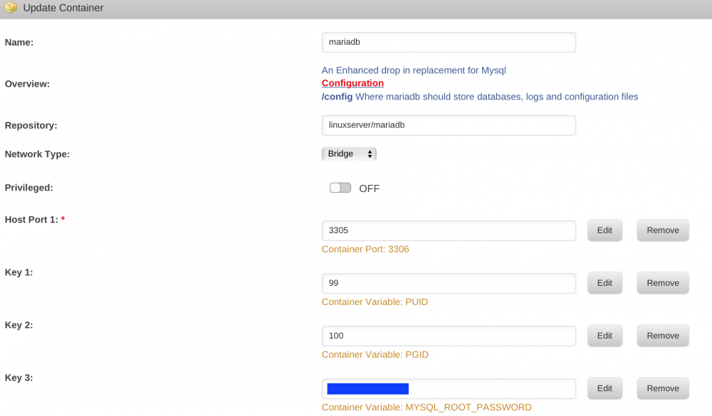

  12. Hello there, and first for all, thank you all for your hard work. I'm trying to setup nextcloud and before posting I've spend 2 days reading ALL the post about it. But when I try to setup an admin account on nextcloud, I have this error : 2006 Mysql server has gone away.... I'm using mariadb in a docker with the setting posted in page #28. Thanks in advance for the help.
