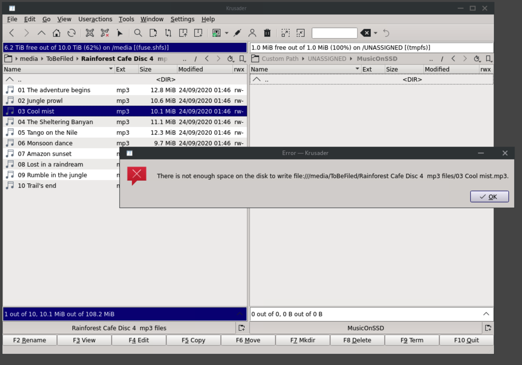

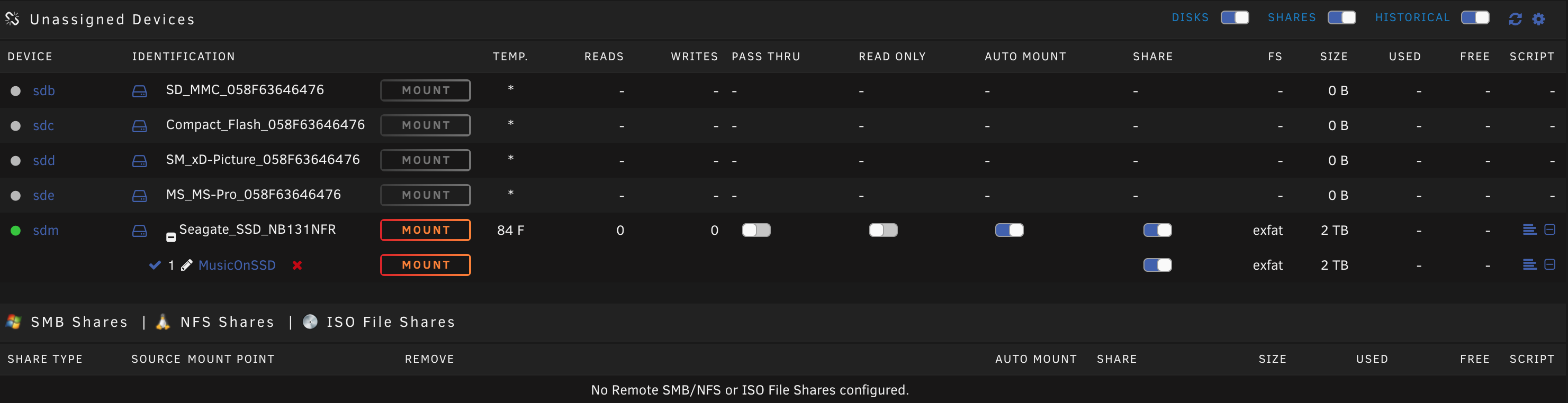

Attached. You can see in the Krusader screenshot it's showing my UA drive as 1MB free out of 1MB ? Clearly in the other screenshot you can see it's a 2TB drive. No sure what I messed up where Edit: I was able to format them by hitting the red x - and I chose exfat - but now it won't mount.
Hi guys, I've got UAD and UAD+ installed but running into a bit of a problem: I plugged in an external SSD that I formatted in ExFat and Fat32 - and every-time I try to copy files to it (inside Krusader) I get an error that the that there is not enough room on the disk even though my source is only about 500 MB. Yes, destructive mode is enabled. I formatted it on my Mac, so I thought that my be causing issues....so I a tried to format it via UAD and I can't even find that option! Thanks for any guidance.
