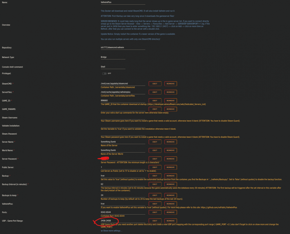

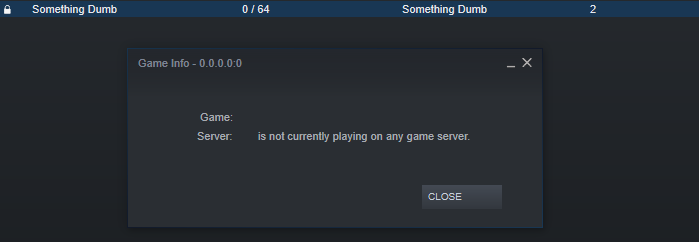

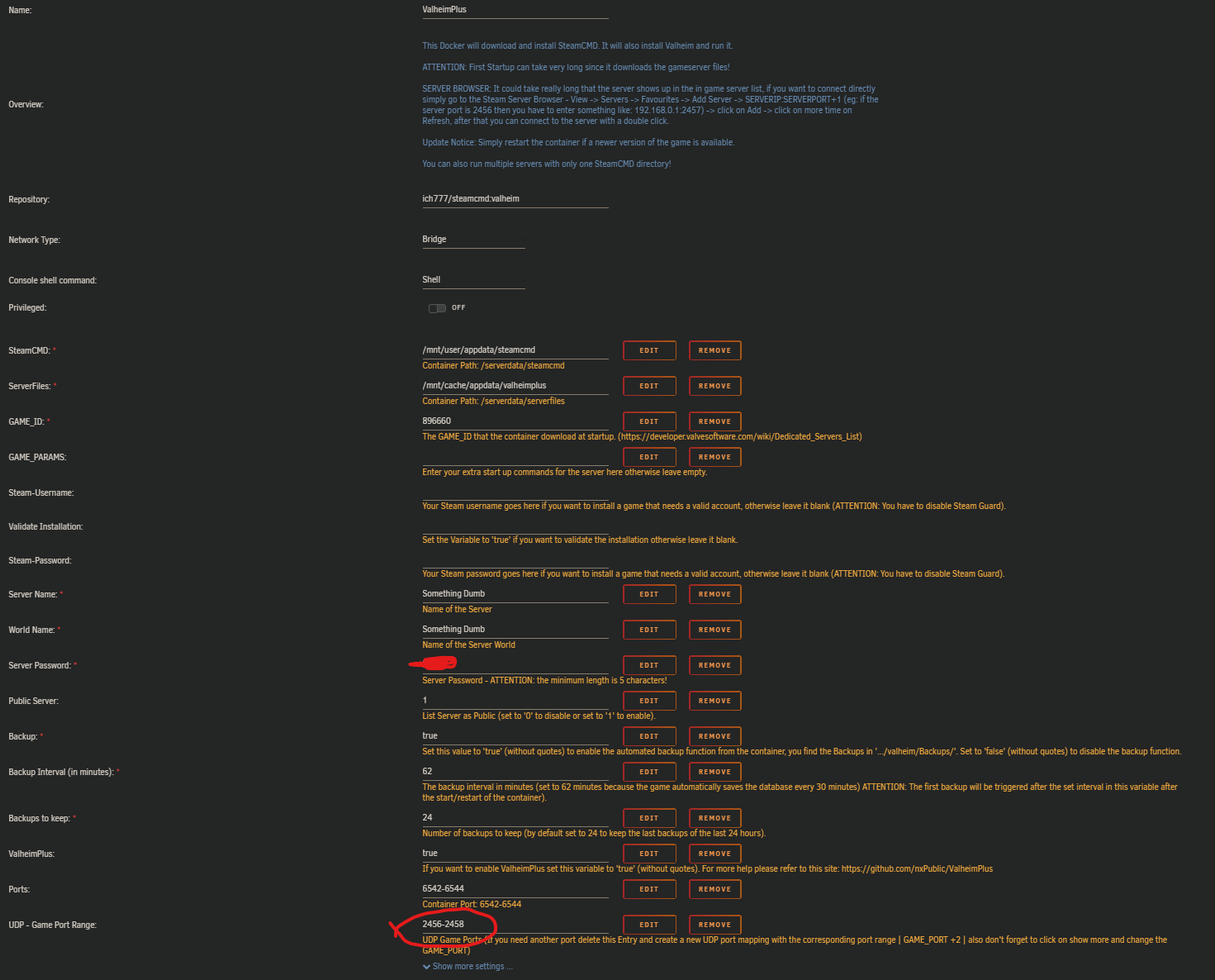

  18. @ich777 Just as an FYI, the Valheim docker update re-added the default game ports to my second container making it so it wouldn't launch with the first container running defaults (because ports conflict obviously). Not sure what caused, but I will note that my second container was running ValheimPlus. Not sure if that would have made a difference but just trying to give you the info
  19. This did help thanks. I didn't realize the GAME_PORT under the extra settings needed to be changed. Working now. Thanks @ich777 you rock. Keep up the great work and know the community appreciates you and your hard work!
  20. OK, maybe I'm stupid, but I cannot for the life of me get 2 of these Valheim dockers to run simultaneously. They spin up just fine but only one is actually accessible. I have forwarded a separate port range and put the correct ports in the container. When I use Steam Server List, the server shows up at the correct port with the correct game name but when trying to join I get this: Please help
