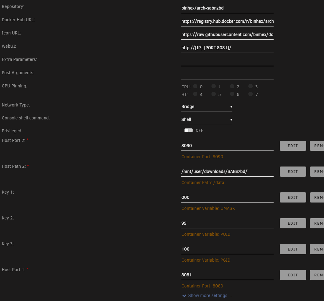

  3. EDIT: I removed and re-added the Host Port 1 field and it's working now. Not sure what happened. My issues return. I managed to get sab working, but sonarr and radarr couldn't see it as they are routed through privoxyvpn container. I routed sab through the same container and got it working, but even though I had changed the port to 8081 (and using it) it had also taken over 8080 which stopped qbittorrent from working and being accessable. I enabled "Host access to custom networks:" and changed the network type to bridge. When navigating to 192.168.1.50:8081 I get the "this page can't be reached" error in Chrome. Can anyone assist please?
  4. Need some help please. I'm unable to change the port numbers. I've installed this docker container this afternoon but it's trying to use port 8080 which is already in use with QBittorrent. I've attempted to change 8080 to 8081 & 8090 to 8091. I've changed it in the config screen, I've removed the values in the config screen and re-added them, I've changed them in the config file and the port mapping doesn't change. The log shows a fatal error as it can't bind port 8080 and I can't access the webui. If you want logs and/or screenshots, tell me what you need. Cheers EDIT: Think I've sussed it, possibly. I had changed the container port with the host port
