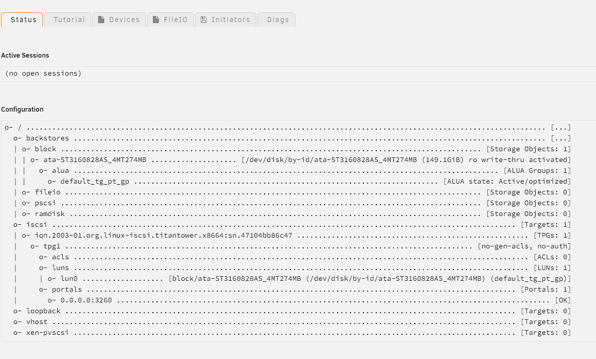

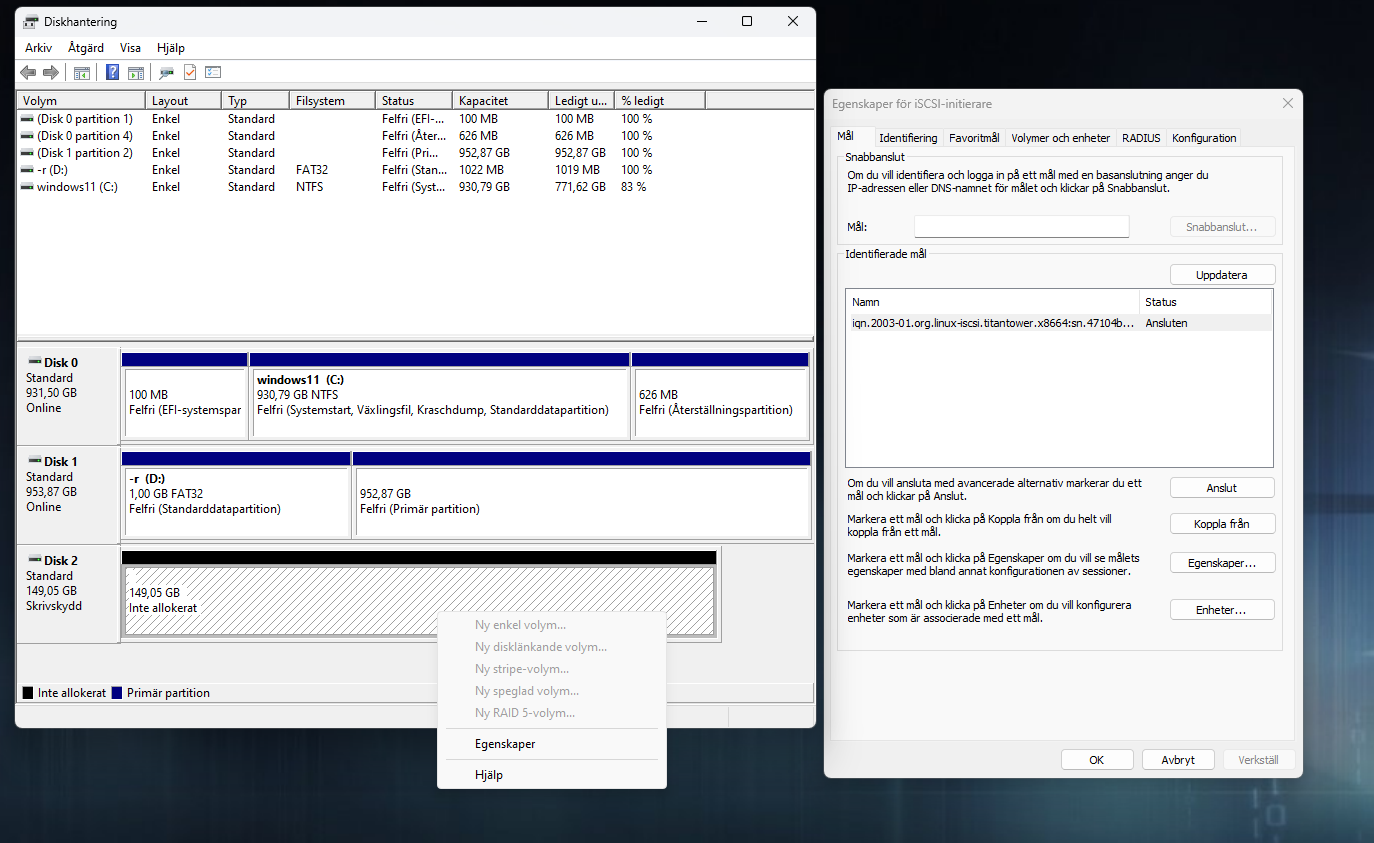

  8. OMG now i just feel stupid the read only thing wasent obies i that it was for ID to the disk but now it works i whan to thank you so mutch fore the help
  9. meaby the disk is bad but in unraid i have used it before but i am emptying an other disk that i can test whit
  10. i tested some disktools an they say the disk is READ ONLY
  11. ok i understand but in the windows side i dont get the initialize disk ! thats the problem
  12. do i nead to have NTFS partition on it ?
  13. its not in use and no file system its the one whit the line over it
  14. this is an test drive do i nead to do something whit it in unraid ?
  15. hmmm its not 100% ok i cant use it

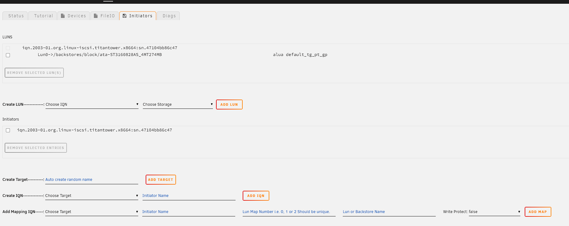

  18. i cant see anything !! here is my pics

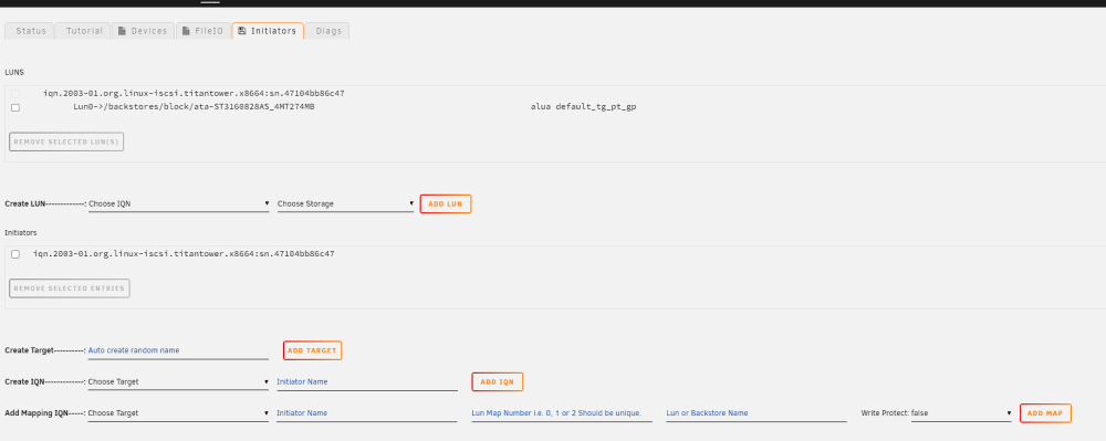

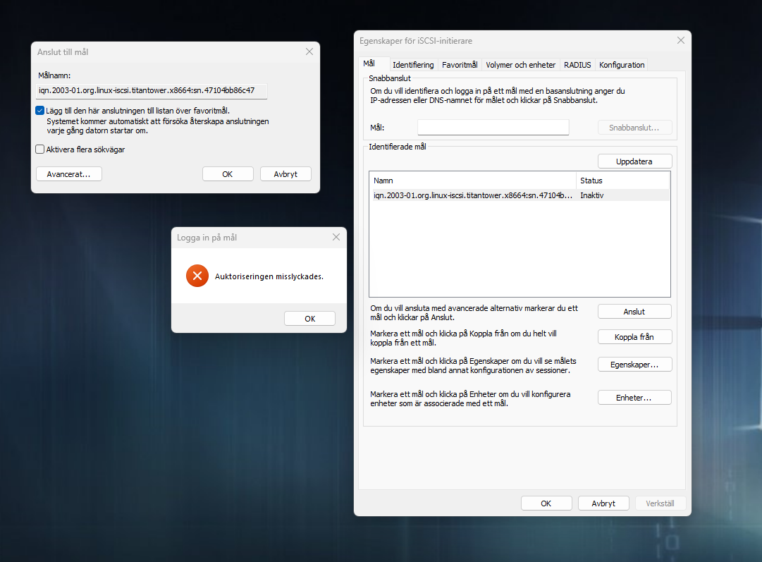

  19. hi al i am new to ISCSI i installed the plugin en uset the guide in there and all seems ok but in windows side i can add the iscsi but when i try to connect it cant i get Authorization failed
