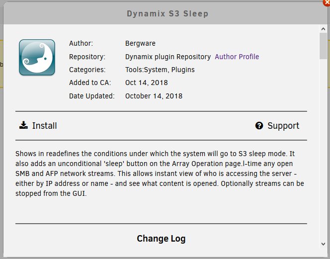

FYI, on the Community Apps tab, the description for the S3 Sleep app has part of the Active Streams description mixed in.
