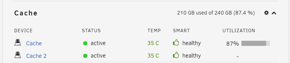

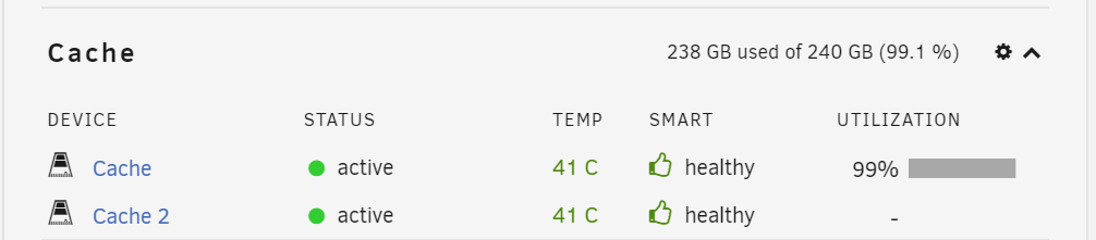

  20. I've ran mover and it's down a little - is it enough?

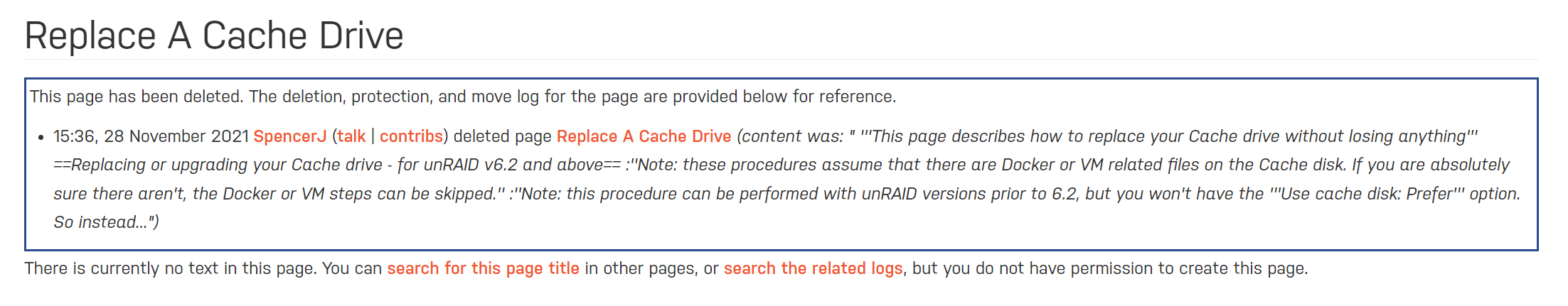

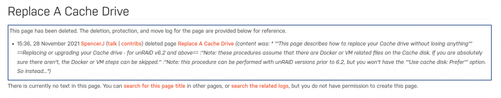

  21. Does anyone know the procedure for changing two cache SSDs for larger capacity ones? I've tried the wiki and it's been deleted Version: 6.10.3 I think the GUI upgrade was a little broken in previous OS versions but i'm not sure if that is still the case or not and i'm not sure if i just need to flush the cache to disk and replace.
