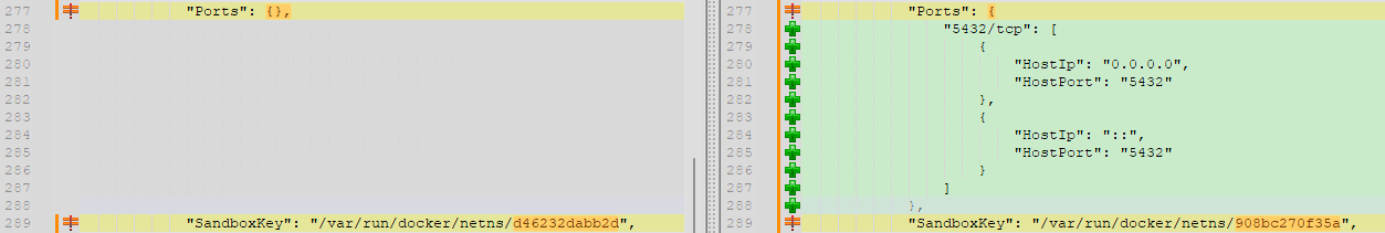

  3. I just changed my docker disk format from BTRFS to XFS due to heaps of errors in my unraid log showing up. Quick google showed a rebuild of the disk was the easiest way to resolve (ignore) it. I stopped the docker service, chose an XFS disk format instead and started it again. I have a user made bridged docker network where all of my dockers have access to so they are able to send logs to my log collector even if they don't have an external IP. Everything was all good up until I tried to start a PostgreSQL docker when there was already one started for another web service. Then I got the error Intrigued why changing only the format of the disk caused this I jumped back to the old disk to confirm I wasn't going crazy and both of the PostgreSQL dockers started up perfectly fine with no port conflicts. They are both being composed using the exact same docker stack, although each in a different stack. I then did a docker inspect on the same docker, composed in both the BTRFS and XFS disk formats, and here is the main difference (minus different ID's etc). The BTRFS 'Ports' section is empty, but the XFS section has the following. "Ports": { "5432/tcp": [ { "HostIp": "0.0.0.0", "HostPort": "5432" }, { "HostIp": "::", "HostPort": "5432" } ] }, Am I running into a bug? Or have I been using a bug with BTRFS and XFS is the correct way it should be?

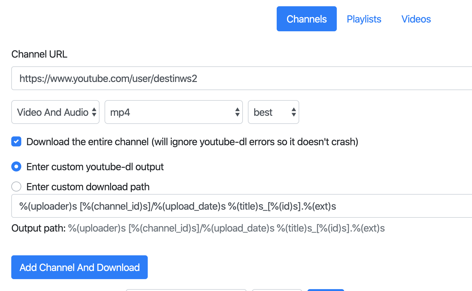

  11. I just tried manually within the docker using the same command but changing the 'bestvideo[ext=mp4]' to just 'best'. This downloaded normal like any other time but it included video. I think when choosing the 'bestvideo' option it's just doing video and it may also be missing the audio part and then needing to join the two?
  12. I'm able to get the whole channel to download now by choose the quality as MP4, it doesn't work when set to 'Any'. With MP4 selected the videos download in the background but my guess is the 'channel' dosn't get added to the bottom of the gui until all videos are downloaded. I have noticed that all the videos it does download don't have any audio. Nothing in the logs about it. {"level":"info","msg":"received a request to add a target","time":"2019-12-20T11:02:27Z"} {"level":"info","msg":"executing youtube-dl command: /usr/local/bin/youtube-dl -j --playlist-end 1 https://www.youtube.com/user/destinws2","time":"2019-12-20T11:02:27Z"} {"level":"info","msg":"DOWNLOAD: {https://www.youtube.com/user/destinws2 Video And Audio Uploads from SmarterEveryDay mp4 [] 12-20-2019 11:02:35 Channel %(uploader)s [%(channel_id)s]/%(upload_date)s %(title)s_[%(id)s].%(ext)s}","time":"2019-12-20T11:02:35Z"} {"level":"info","msg":"downloading video","time":"2019-12-20T11:02:35Z"} {"level":"info","msg":"{ youtube-dl --ignore-errors bestvideo[ext=mp4] downloads/%(uploader)s [%(channel_id)s]/%(upload_date)s %(title)s_[%(id)s].%(ext)s https://www.youtube.com/user/destinws2}","time":"2019-12-20T11:02:35Z"} {"level":"info","msg":"executing youtube-dl command: /usr/local/bin/youtube-dl --ignore-errors -f bestvideo[ext=mp4] -o downloads/%(uploader)s [%(channel_id)s]/%(upload_date)s %(title)s_[%(id)s].%(ext)s https://www.youtube.com/user/destinws2","time":"2019-12-20T11:02:35Z"} {"level":"info","msg":"DOWNLOAD: {https://www.youtube.com/user/destinws2 Video And Audio Uploads from SmarterEveryDay mp4 [] 12-20-2019 11:02:35 Channel %(uploader)s [%(channel_id)s]/%(upload_date)s %(title)s_[%(id)s].%(ext)s}","time":"2019-12-20T11:02:35Z"} {"level":"info","msg":"downloading video","time":"2019-12-20T11:02:35Z"} {"level":"info","msg":"{ youtube-dl --ignore-errors bestvideo[ext=mp4] downloads/%(uploader)s [%(channel_id)s]/%(upload_date)s %(title)s_[%(id)s].%(ext)s https://www.youtube.com/user/destinws2}","time":"2019-12-20T11:02:35Z"} {"level":"info","msg":"executing youtube-dl command: /usr/local/bin/youtube-dl --ignore-errors -f bestvideo[ext=mp4] -o downloads/%(uploader)s [%(channel_id)s]/%(upload_date)s %(title)s_[%(id)s].%(ext)s https://www.youtube.com/user/destinws2","time":"2019-12-20T11:02:35Z"}

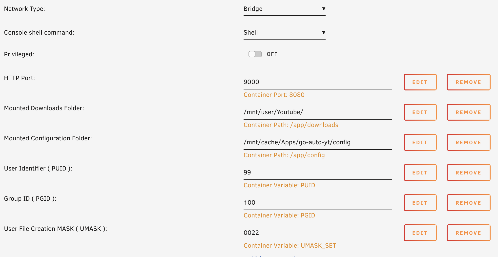

  15. This is the docker settings I have set. Downloads location pointing to my array and config file pointing to my cache directory.

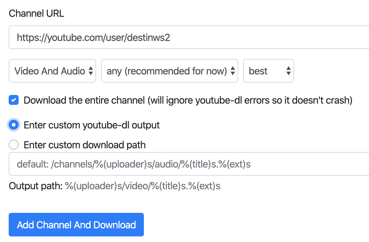

  16. No matter what i set the download folder path to be, or what customised path I set, I'm always getting the same error messages in the logs. I've tried a two different youtube channels but get the same error. {"level":"info","msg":"received a request to add a target","time":"2019-12-14T08:09:58Z"} {"level":"info","msg":"executing youtube-dl command: /usr/local/bin/youtube-dl -j --playlist-end 1 https://youtube.com/users/destinws2","time":"2019-12-14T08:09:58Z"} {"level":"error","msg":"From GetMetadata(): unexpected end of JSON input","time":"2019-12-14T08:10:02Z"} {"level":"info","msg":"adding {https://youtube.com/users/destinws2 Video And Audio any [] 12-14-2019 08:10:02 Channel /%(uploader)s_[UC2LVhJH_9cT2XKp0VAfsKOQ]/%(title)s_[%(id)s].%(ext)s%(uploader)s/video/%(title)s.%(ext)s} to DB","time":"2019-12-14T08:10:02Z"} {"level":"info","msg":"DOWNLOAD: {https://youtube.com/users/destinws2 Video And Audio any [] 12-14-2019 08:10:02 Channel /%(uploader)s_[UC2LVhJH_9cT2XKp0VAfsKOQ]/%(title)s_[%(id)s].%(ext)s%(uploader)s/video/%(title)s.%(ext)s}","time":"2019-12-14T08:10:02Z"} {"level":"info","msg":"downloading video","time":"2019-12-14T08:10:02Z"} {"level":"info","msg":"{ youtube-dl --ignore-errors bestvideo[ext=any] downloads/%(uploader)s_[UC2LVhJH_9cT2XKp0VAfsKOQ]/%(title)s_[%(id)s].%(ext)s%(uploader)s/video/%(title)s.%(ext)s https://youtube.com/users/destinws2}","time":"2019-12-14T08:10:02Z"} {"level":"info","msg":"executing youtube-dl command: /usr/local/bin/youtube-dl --ignore-errors -f bestvideo[ext=any] -o downloads/%(uploader)s_[UC2LVhJH_9cT2XKp0VAfsKOQ]/%(title)s_[%(id)s].%(ext)s%(uploader)s/video/%(title)s.%(ext)s https://youtube.com/users/destinws2","time":"2019-12-14T08:10:02Z"} {"level":"error","msg":"exit status 1/usr/local/bin/youtube-dl --ignore-errors -f bestvideo[ext=any] -o downloads/%(uploader)s_[UC2LVhJH_9cT2XKp0VAfsKOQ]/%(title)s_[%(id)s].%(ext)s%(uploader)s/video/%(title)s.%(ext)s https://youtube.com/users/destinws2","time":"2019-12-14T08:10:05Z"} {"level":"info","msg":"updating latest downloaded video id","time":"2019-12-14T08:10:05Z"} {"level":"info","msg":"latest downloaded video id updated successfully","time":"2019-12-14T08:10:05Z"} {"level":"info","msg":"updating download history","time":"2019-12-14T08:10:05Z"} {"level":"info","msg":"[{https://youtube.com/users/destinws2 Video And Audio any [] 12-14-2019 08:10:02 Channel /%(uploader)s_[UC2LVhJH_9cT2XKp0VAfsKOQ]/%(title)s_[%(id)s].%(ext)s%(uploader)s/video/%(title)s.%(ext)s}]","time":"2019-12-14T08:10:05Z"} {"level":"info","msg":"returning response: {Error ERROR_DOWNLOADING There was an error downloading the target Download: DownloadVideo: exit status 1}","time":"2019-12-14T08:10:05Z"} {"level":"info","msg":"got this data: {channels}","time":"2019-12-14T08:10:06Z"} {"level":"info","msg":"getting all channels from channels.json","time":"2019-12-14T08:10:06Z"} {"level":"info","msg":"successfully read all channels","time":"2019-12-14T08:10:06Z"} {"level":"info","msg":"[{https://youtube.com/users/destinws2 Video And Audio any [] 12-14-2019 08:10:02 Channel /%(uploader)s_[UC2LVhJH_9cT2XKp0VAfsKOQ]/%(title)s_[%(id)s].%(ext)s%(uploader)s/video/%(title)s.%(ext)s}]","time":"2019-12-14T08:10:06Z"} {"level":"info","msg":"got this data: {channels}","time":"2019-12-14T08:10:43Z"} {"level":"info","msg":"getting all channels from channels.json","time":"2019-12-14T08:10:43Z"} {"level":"info","msg":"successfully read all channels","time":"2019-12-14T08:10:43Z"} {"level":"info","msg":"[{https://youtube.com/users/destinws2 Video And Audio any [] 12-14-2019 08:10:02 Channel /%(uploader)s_[UC2LVhJH_9cT2XKp0VAfsKOQ]/%(title)s_[%(id)s].%(ext)s%(uploader)s/video/%(title)s.%(ext)s}]","time":"2019-12-14T08:10:43Z"}
