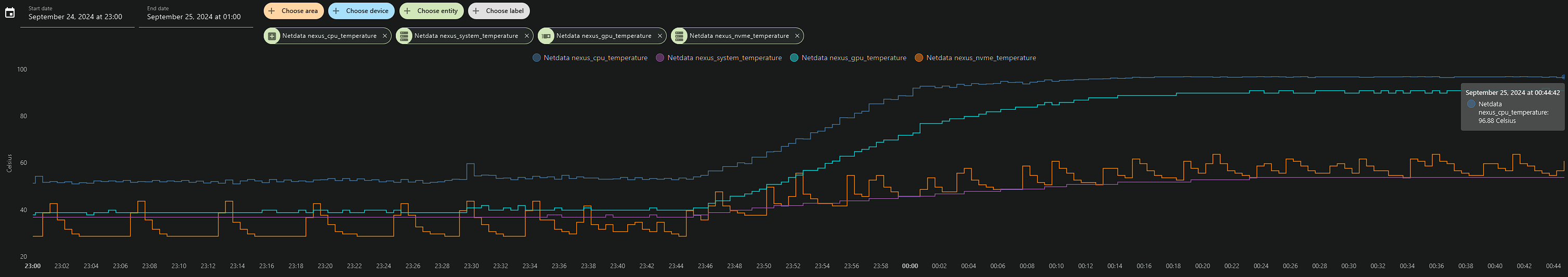

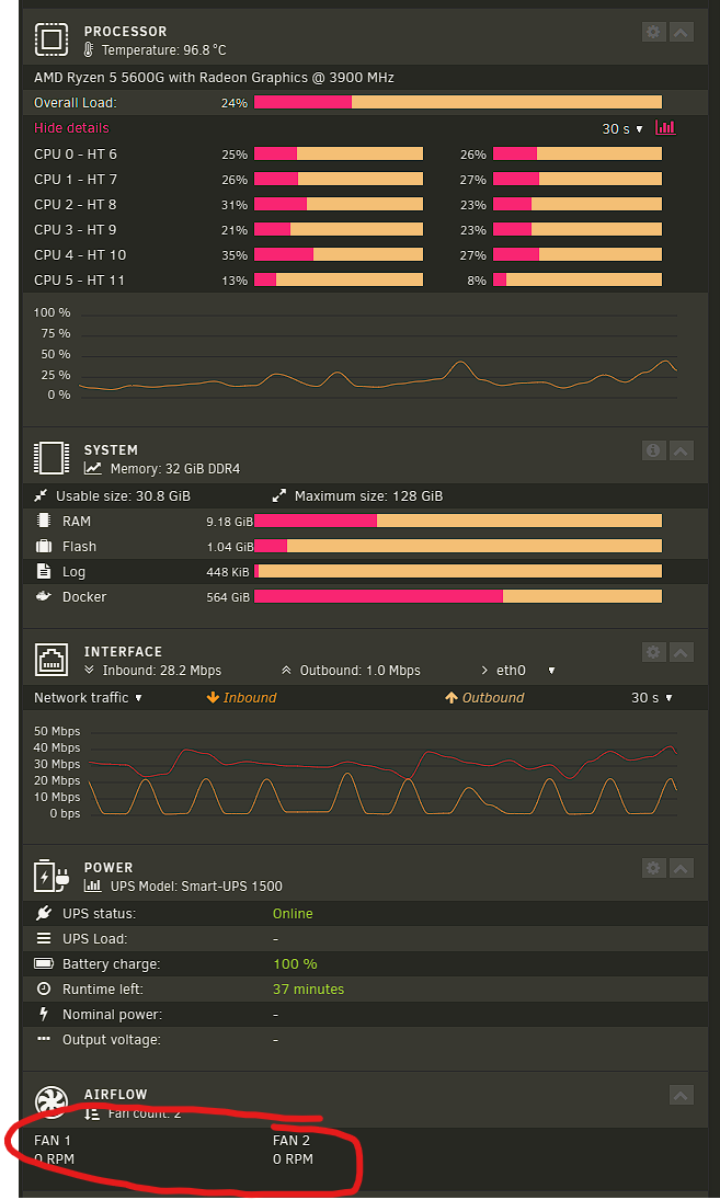

  3. On a Biostar X370GTN I've been fighting this issue for a long LONG time. Checking the logs I always saw: thermal_zone0: acpitz: critical temperature reached, shutting down Since the critical trip point is set to 127 degrees, this is VERY concerning. cat /sys/class/thermal/thermal_zone0/trip_point_0_temp So I started logging stuff via NetData & HomeAssistant. But the data was always inconclusive or gone from the moment the suposed overheat happened. Tonight I managed to catch it whilst it was happening. At first thought that the fan sensors were giving incorrect data, as they all read 0 RPM and going to Settings > System Temp the Array fan speed was completely blank. So I physically checked the fans and I was shocked to find them totally still. I hastily rebooted the system cuz it apparently had been running at 97°C for 45 minutes. WHAT.
