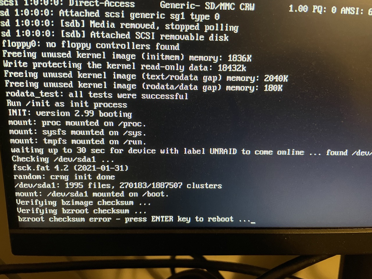

  4. Finally I got my server updated to 6.12.3 yesterday. There was a BIOS update available from May 2023 and I switched back to UEFI. In the past that caused some trouble with my Dell Precision 5820 but yesterday it booted perfectly at second try. First try didn't (Legacy) but did not reboot automaticly either. That's intresting because on 6.11.5. it was opposite. Also I uninstalled gpustat.plg as recommended by update assistant. But I don't think, this caused the problem as the reboot happened at a very early stage in booting. At least it might be worth giving a try if one didn't uninstall allready.
  5. Same here. And there are some others having the same issue since 6.12. obviously. I have a spare server with a Supermicro board / Intel Xeon/ 32GB Ram as well, that one runs flawless on 6.12.3. Not so my Dell (productive) server. Did you try the suggestions? There is no newer BIOS for my Dell so this is no option for me. Maybe removing my graphics cards may help but I did not try this yet. UEFI Boot is is deactivated as this did led to a similar failure for me.
  6. So 6.12.3 is available now. Did someone already give it a try?
  7. Same here. I was able to successfully downgrade to 6.11.5 again by copying all files from folder previous to root. I created a new 6.12.2-USB stick using USB Creator. That one didn't boot either. What is that tmpfs 32M 340K 32M 2% /run thing about? I do have a Plex container running as well. Regards, petjek
  8. Yay! That worked flawless! Is there any need to change settings back to UEFI boot? Any advantages doing so?
  9. Well, no it doesn't. I just updated the Nvidia driver and with the next restart the same problem reoccurs. I made some adjustments in BIOS like switching from UEFI to legacy boot. Unfortunately that didn't change a thing. Actually I think of following the advice to create a new boot stick. I found that on reddit a lot. I was able to copy the config folder from the original stick to my Mac and will have the new stick created soon. Do I have to copy anything else but the config folder?
  10. Okay, UEFI probably was the problem here. I checked BIOS settings, activated UEFI and set the flash drive as the only boot device. First boot led to another error at first but eventually the server booted correctly. Thx!

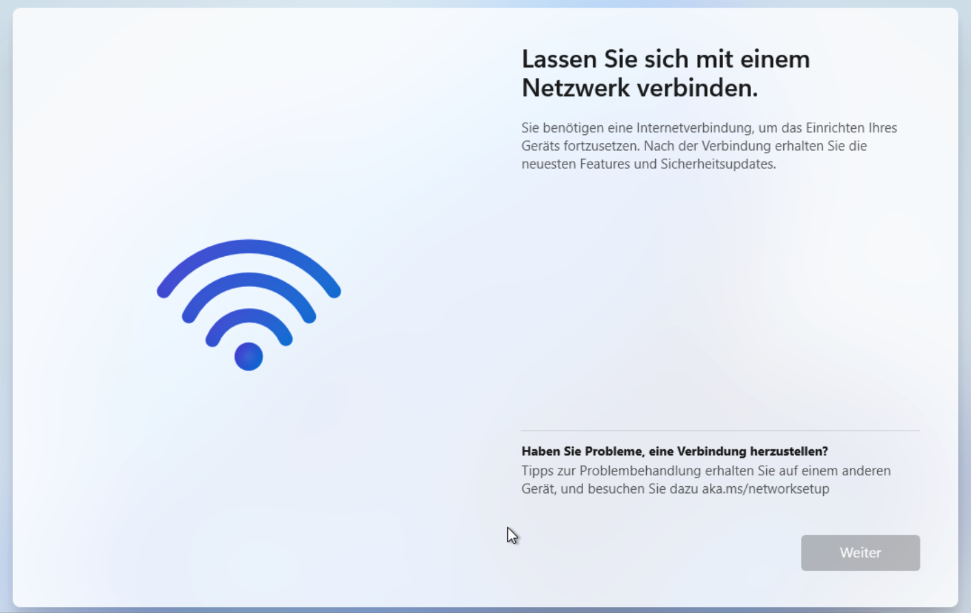

  13. Oh man, sorry. Ich habe schon recht viel im Post gelesen, diesen Teil aber tatsächlich nicht. Ist jetzt durch gelaufen. Danke!

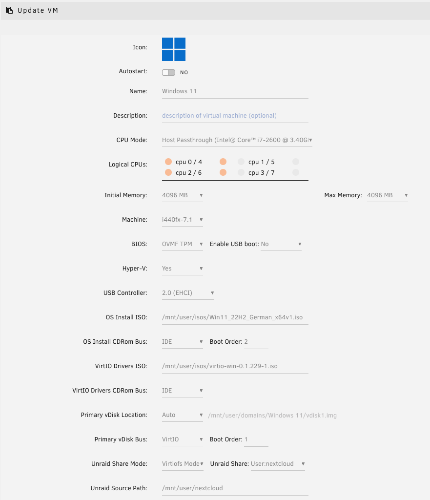

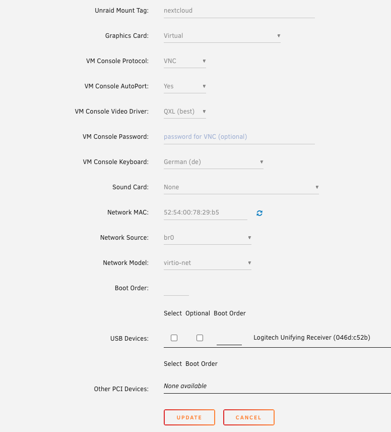

  14. Okay, ich will nicht noch mal editieren. Daher neuer Beitrag. Das Setup startet jetzt problemlos und ich komme zum Einrichtungsassistenten. Da hänge ich nun aber bei der Netzwerkverbindung. Mit ein bisschen goolen bin ich auf den Befehl pnputil /add-driver e:\ *.inf gestoßen, den man in der Eingabeaufforderung eingeben muss. E ist die VirtioCD, nur in welchem der Ordner finde ich nun die Treiber für die Netzwerkkomponente?
