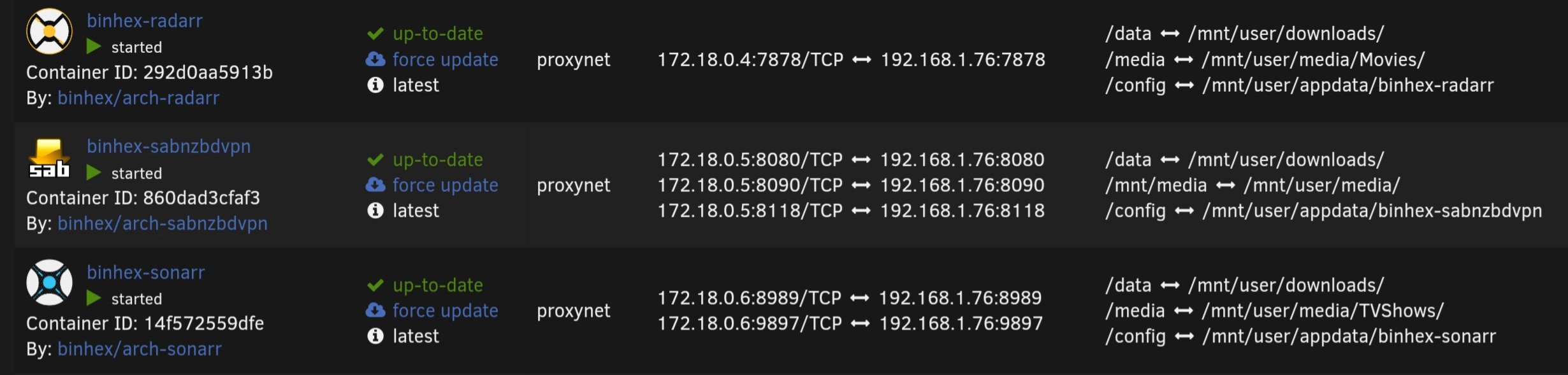

  14. On the subject of mappings, does it matter that sabnzbd has its media folder set within the docker itself differently from radarr and sonarr? Looking at sabnzbd, it is formatted as; /mnt/media whereas radarr and sonarr have; /media

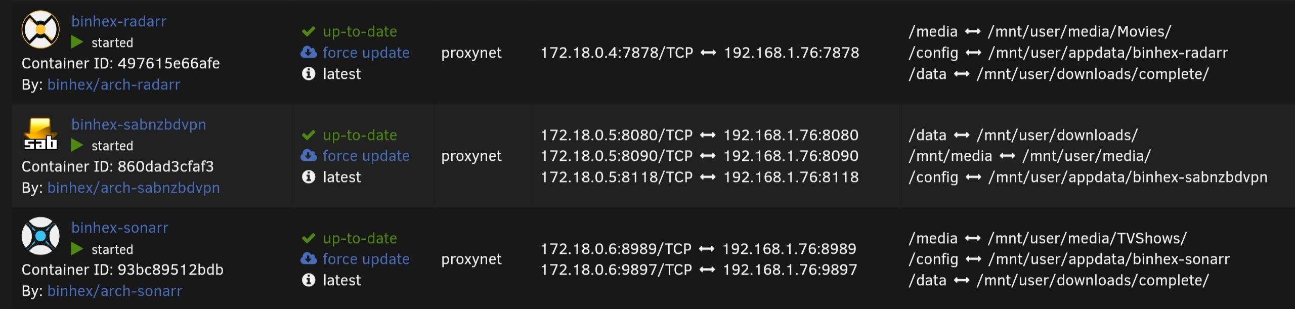

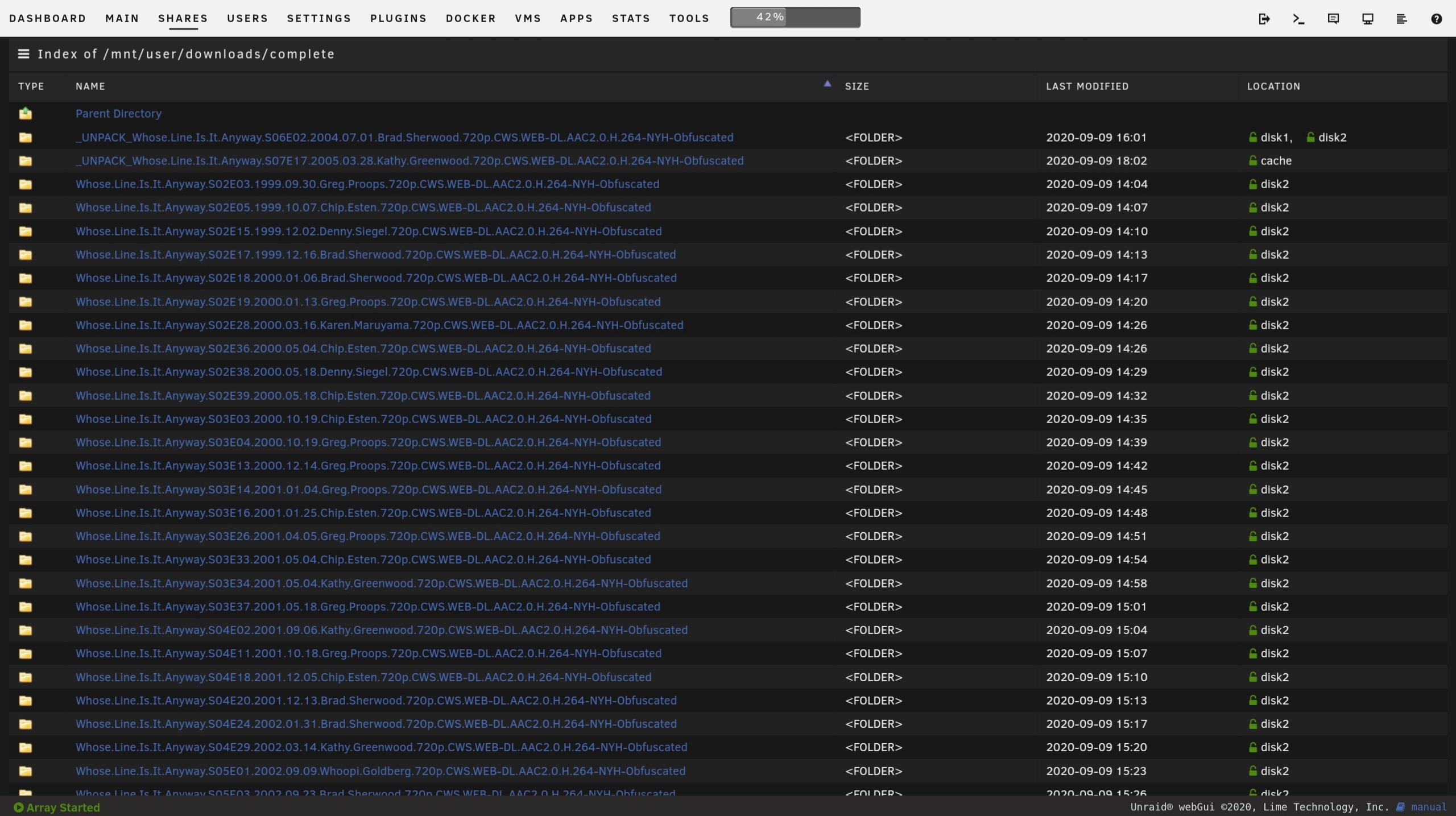

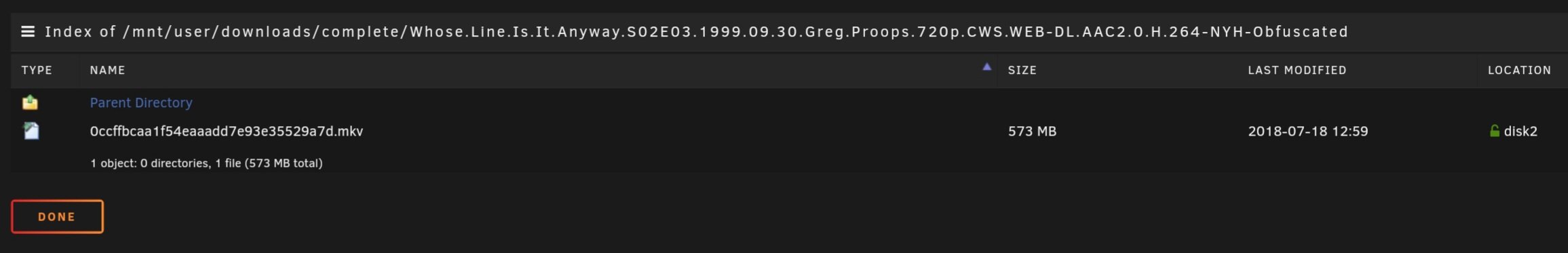

  15. Hi, Many thanks for your advice. I realigned sab, radarr and sonarr and tried a fresh download, unfortunately the same thing has happened. It finishes, is unpacked as an obsfucated file, placed into a folder and moved to the completed folder, however there it sits. I've tried forcing Sonarr to complete another scan, but that does not help. For reference, below is the Sabnzbdvpn log output regarding this latest file;

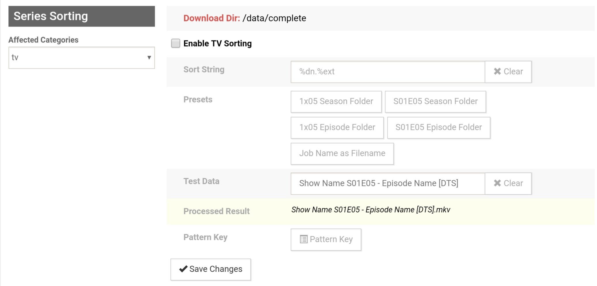

  16. Hi, I was hoping that someone could give me some advice on an issue I'm having with Sonarr. Mainly it has been working well, however I'm having issues with obsfucated file names, specifically with Sonarr leaving them in the downloads folder and not processing them. As you can see from the screenshots below, my folder mappings are correct (or I think they are) and Sabnzbdvpn is set to not sort the downloads, I've left that to Sonarr/Radarr. I've also included a snapshot of the relevant part of the Sonarr log. I can manually go and rename them, move them about and it works, but I want to correct the problem as it is very time consuming. Many thanks.
