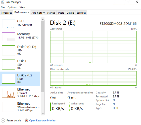

  4. After I update my router today, my local access have a red lock icon instead a green lock icon for local access. Anyone know if that is an issue and how to fix it?
