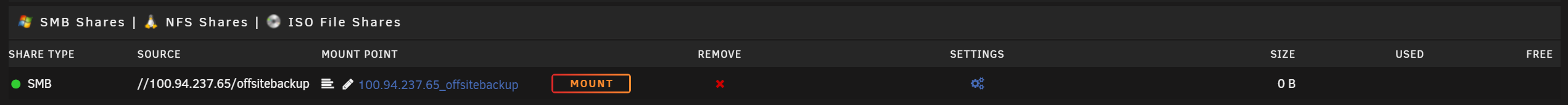

I have been using UD with tail scale on my main machine and a remote machine to use Duplicati for years without issue until recently. The share is supposed to auto mount but it does not. When I click mount I get an error and in the syslog I get the following. I am on 7.0.0 and have been since before this. Any idea? Nothing turning up for that error code I can find. Apr 26 15:05:46 WOLF kernel: CIFS: VFS: cifs_mount failed w/return code = -95 Apr 26 15:05:46 WOLF unassigned.devices: SMB mount failed: 'mount error(95): Operation not supported Refer to the mount.cifs(8) manual page (e.g. man mount.cifs) and kernel log messages (dmesg)'. Apr 26 15:05:46 WOLF unassigned.devices: Remote Share '//xxx.xx.xx.111/offsitebackup' failed to mount.

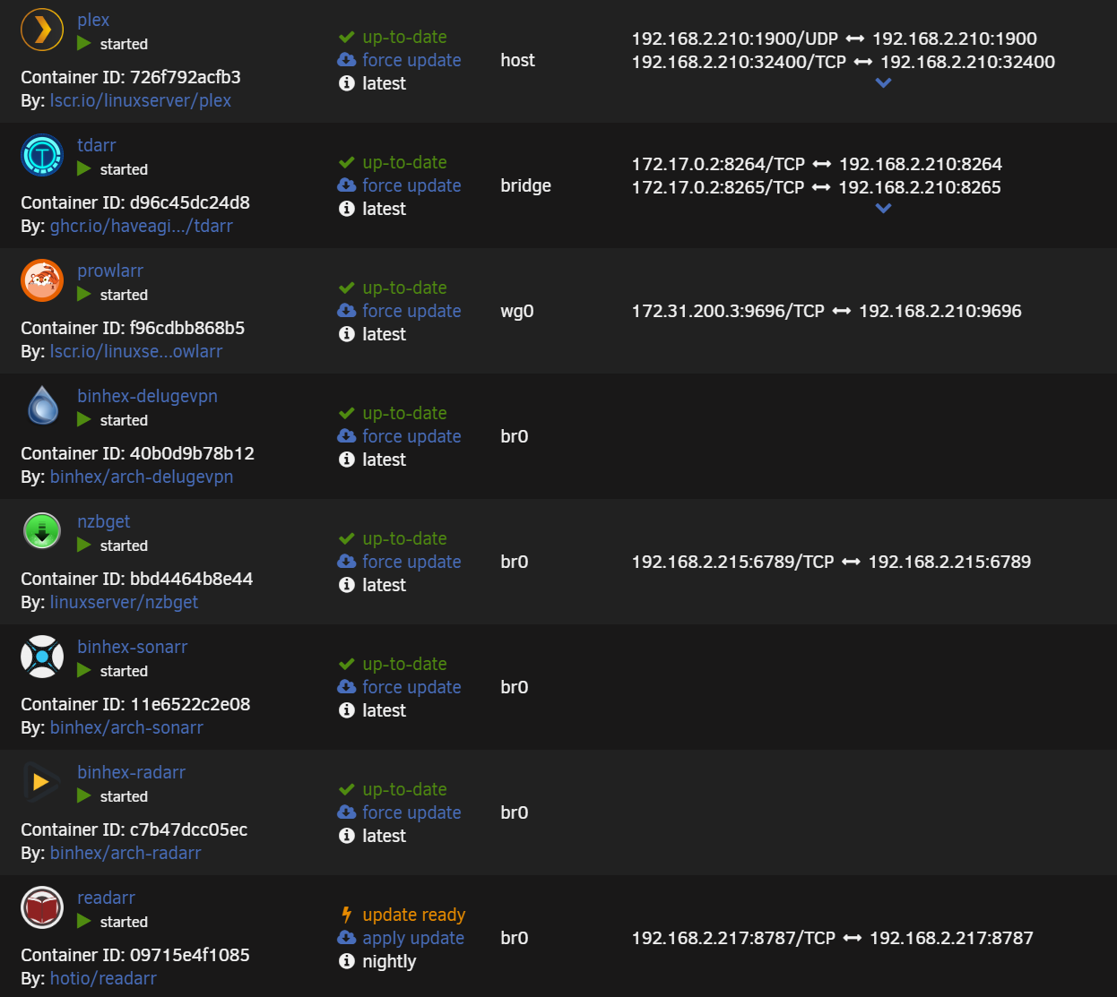

Docker Container webpage port mappings column is blank
Having the exact issue as defined here. All binhex containers and all have a static ipv4 address on custom host br0. All accessible via the ip:port but not using the webGUI link.

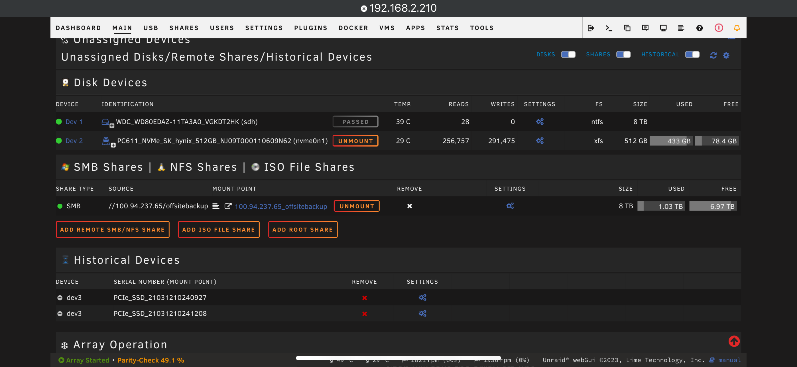

Thank you for your help! More troubleshooting steps.... 1. Uninstalled UD and UD plus, restarted, reinstalled UD and Plus. 2. Moved from Tailscale docker by uninstalling and running appdata cleanup. Installed Tailscale plugin instead as its whats supported now. No change. Was thinking it may have been a Tailacale issue on my Unraid only but doesn't appear to be. Does UD do ANYTHING with the libvert file? I understand thats for VMs and I have 3, but I did restore that when my cache crashed which caused issues with other plugins like USB Manager. There is no check I can click when not mounted, see screenshot. Its not a drive, its a share if that makes a difference. Lastly, anytime I try to access the UD remote share, through Duplicati or browsing it on Unraid, it locks up and will not dismount. When I try it says "target is busy" but it will remain that way indefinitely until I restart the system. I have attached my diagnostics during the problem. wolf-diagnostics-20240117-2103.zip
It does not change orange. I appreciate the tip of Dynamix File Manager, I removed it and tried a few other steps and it did not fix it. Actually had trouble removing the plug in but deleted it from the USB drive. To add more to the problem, if I "share" the remote UD and then in windows file explorer navigate to it, I thought it wouldn't load as it sat and spun for around 60 seconds but DID eventually populate the files inside. When I went to move a 100MB file it just shows one file discovered and looks like it pending but either never moves, or takes longer then 5 minutes to even attempt to move. If I go to the remote servers share directly in Windows (rather then the "share" from UD in my local server), I am able to mobe the same 100MB file almost instantly. Its like through UD and the remote share function, I am getting a tiny fragment of throughput.

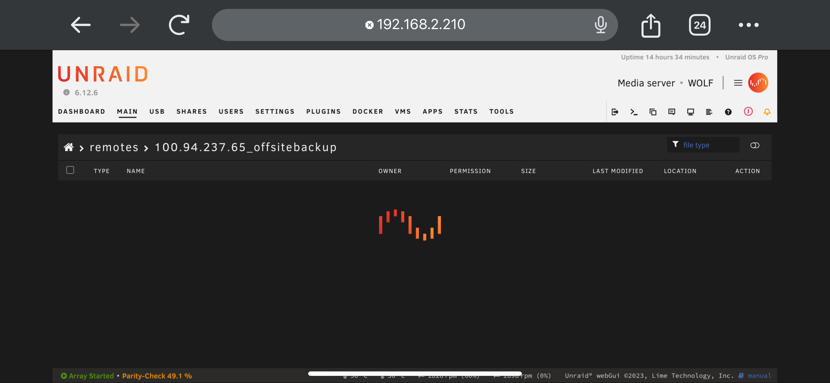

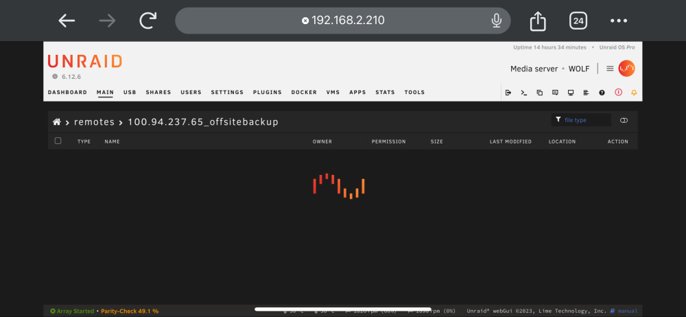

Even beyond a path in Duplicati, when I click the blue path in Unraid, it will not load. Usually I can see files when I click that. At least prior to this cluster of an issue I had with my cache drive. It does show the size and usage correctly. but my path for Duplicati is, /mnt/remotes/100.94.237.65_offsitebackup/
I have been using this plugin for years with no issue until now so #1 thank you! TLDR: Remote share mounts with path via Tailscale and shows green but can’t browse or see files in Unraids dashboard. Just stays loading. My cache drives running BTRFS became corrupt and my appdata backup and restore was 6 months old (not sure why but it wasn’t backing up data, only the xmls). I restored all xmls and reinstalled all dockers and VMs that lived on cache. The system partition on cache was also lost and this may be a part of my problem if UD relies on files in here. I use UD to mount a remote chair that is offsite. I use Tailscale on the server to create the path. I’m out the share via SMB with a username and password. And then use Duplicati to run my back up of essential files. The issue, since I have got the server back up and running, I am able to mount the share and during that process it shows me the various shares on the remote server and I pick my offsitebackup share. The share shows green and online on the UD dashboard. However, if I try to navigate to share on Unraids dashboard I cannot see any files and Duplicati also says there’s nothing in there. When I go to the path of the share on windows, I can see all of my old backups and it works as it should. Any ideas for things to check here? It appears the path via Tailscale is working because it mounts and shows me the various shares when creating the mount and gives me a greenlight. Duplicati doesn’t matter because I can’t even view the files on the dashboard. No errors I can see. Thank you!
