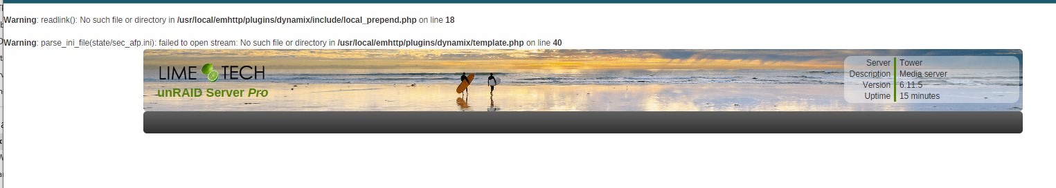

UNraid wouldn't update from 6.2 (either linking directly to the update url or via the update plugin), updated manually by flash drive and now have issue with GUI

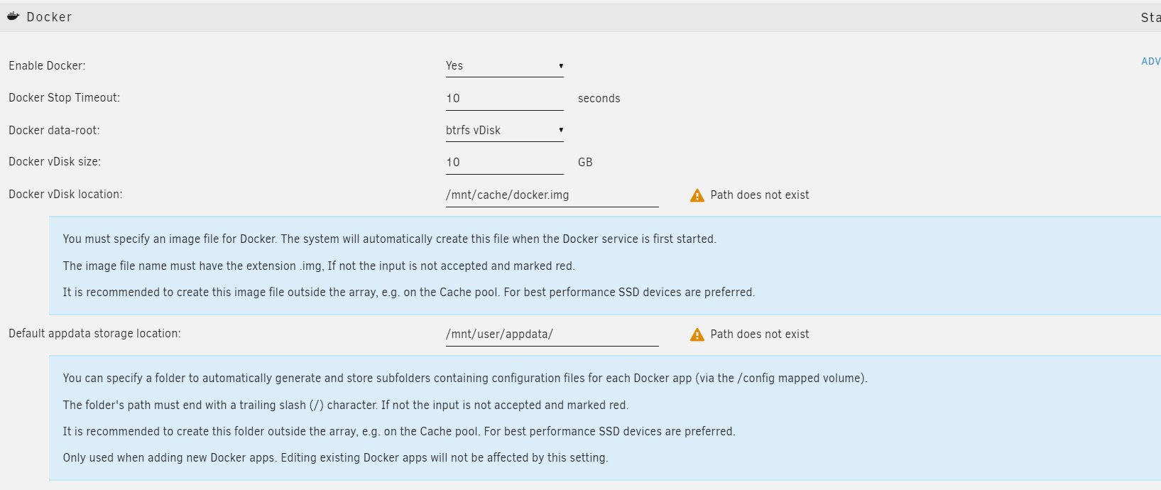

Yeah, I had to specify a path otherwise I run into problem. Hmmm, I could try to make it work from the cache drive. The issue I run into is the "path does not exist" problem I describe above. Can I use MC to manually create the folders somewhere and try again?

Dockers were working before I copied over the CFG files above. After copying it wouldn't work so I added the cache drive (which was unassigned at that point) because the tooltip said that a cache drive was preferred. I'll just take out the cache. Any other suggestion for getting this to work? Re Format: Why do I have to convert to a different format? Is this a functionality that will be removed in future versions? If so, I'll just stay with the current stable version (I was on 6.2 for the last 6 years and that was fine for me). The process looks like a PITA and with all the troubles I'm running into, I'd rather not risk losing my data.

This worked to preserve my settings but now I can't activate dockers. On the settings page, I'M seeing this. Any suggestions? tower-diagnostics-20230216-1631.zip

I ended up manually updating to 6.9.2 and that worked. Then I was able to update to the latest version via the gui. Weird but glad it worked!
