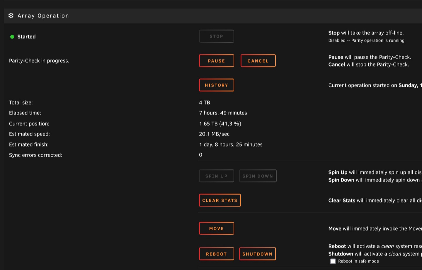

  2. So the Server was running perfectly, until the Parity Check in the morning. I restarted the server and monitored the automatic Parity Check. But strangely, it completed without any problems. The server was normal afterwards. The Rootfs was also not any larger. The Parity Check was completed at around 17 p.m. I monitored the server afterward and at around 20 p.m. it happened. Some cpu cores were at 100% and the web interface wasn't working. I noticed the kernel log is getting updated. That's the only thing I am getting from the server right now.kernel.txt

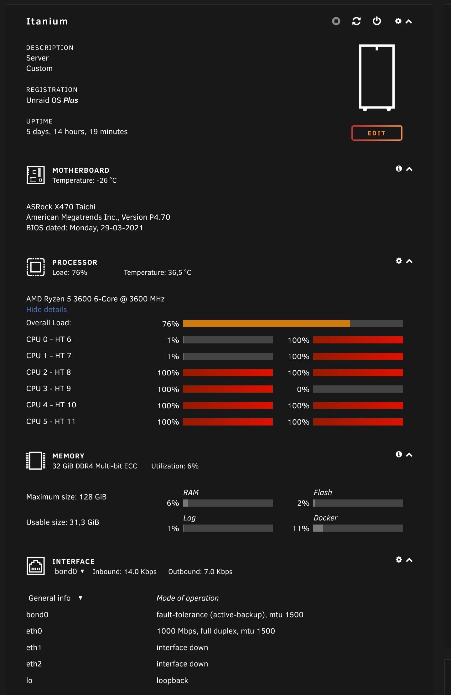

  4. Yes, I should always be active, to my knowledge. I enabled Docker again (i have not a single container installed) to have a new Syslog report. Strangely the server did not crash in the first 24h. But today was the Parity check, it started normally but went for some reason extreme slowly after some time. And also some CPU cores were reporting 100% load. The overall response time was really bad too. I was only able to take a screenshot from the CPU load reporting. After that the web interface did not load at all anymore. Had to press reset again. Syslog Crash2.txt

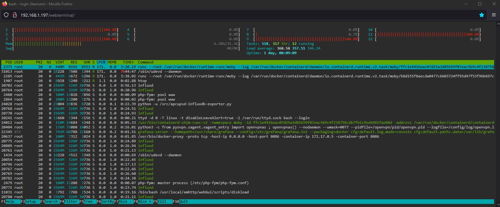

  7. Hi, My unraid server crashed last week for the first time. I had to press the hardware reset and then it came back. Yesterday my Computer was lagging and I found that it was my server through the SMB shares. The Server was under constant CPU load and was really slow, but it responded. htop showed that docker used the CPU (ScreenShot). I tried everything to bring it back but had to push the reset button again. Then i disabled docker and Started the Array and thought that should at least keep it from Crashing. The automatic Parity check started. When i came from work today the server was completely locked up again. Had to press Reset and then copied the important data. 1 Hour ago it crashed again. I literally have no clue what's happening. itanium-diagnostics-20220830-2213.zip
