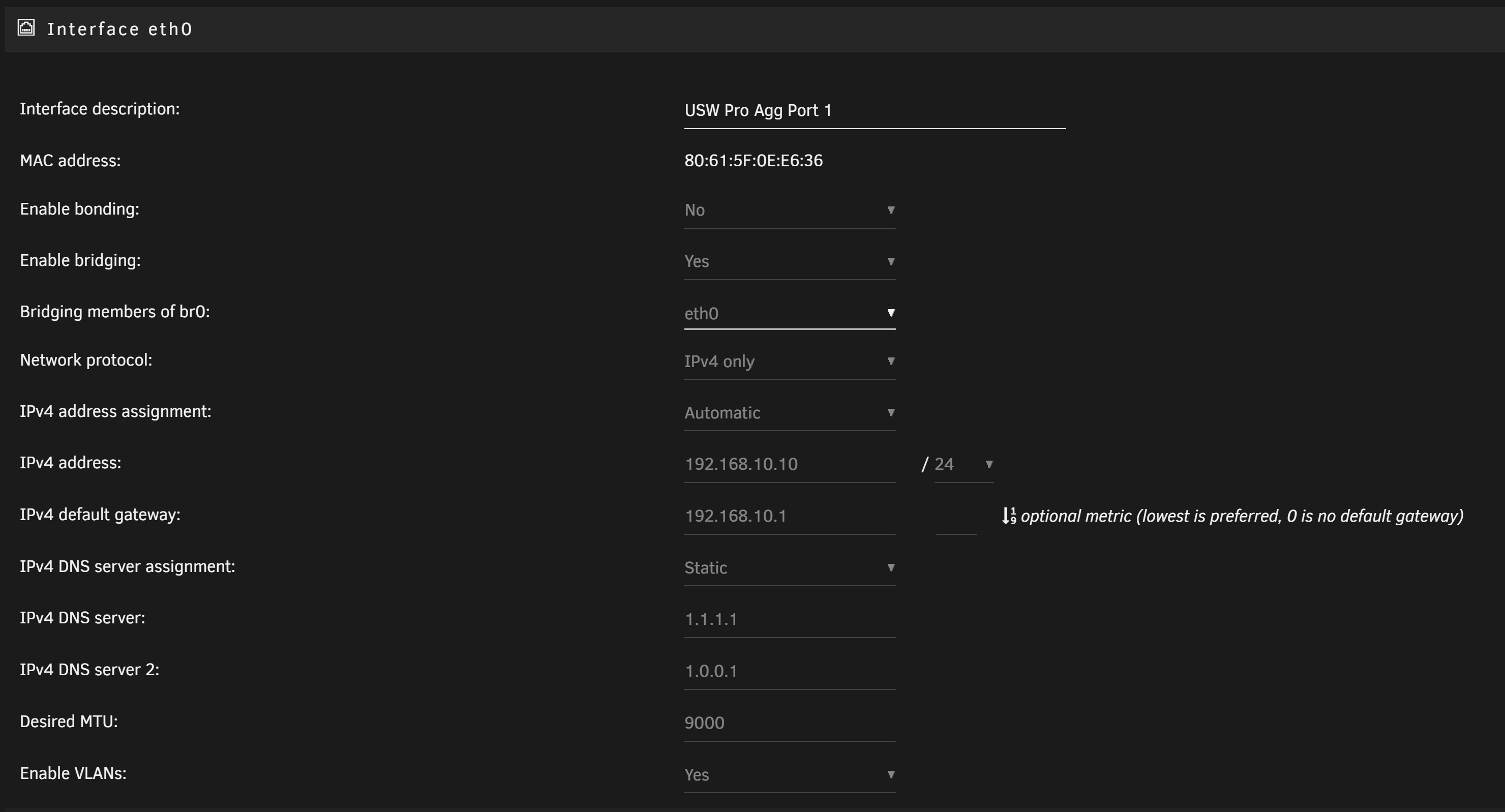

I'm not sure what you mean? I can't select eth1 under 'Bridging members of bro0'. This is my problem.

@bmartino1 Here you go. This is with eth1 Disabled on my switch since it would cause STP errors. Let me know if you would like me to enable eth1 and place it on another network. root@Myers19:~# ip a 1: lo: <LOOPBACK,UP,LOWER_UP> mtu 65536 qdisc noqueue state UNKNOWN group default qlen 1000 link/loopback 00:00:00:00:00:00 brd 00:00:00:00:00:00 inet 127.0.0.1/8 scope host lo valid_lft forever preferred_lft forever inet6 ::1/128 scope host valid_lft forever preferred_lft forever 2: tunl0@NONE: <NOARP> mtu 1480 qdisc noop state DOWN group default qlen 1000 link/ipip 0.0.0.0 brd 0.0.0.0 5: eth0: <BROADCAST,MULTICAST,UP,LOWER_UP> mtu 9000 qdisc mq master br0 state UP group default qlen 1000 link/ether 98:b7:85:1e:b6:46 brd ff:ff:ff:ff:ff:ff 6: eth1: <NO-CARRIER,BROADCAST,MULTICAST,UP> mtu 9000 qdisc mq master br1 state DOWN group default qlen 1000 link/ether 98:b7:85:1e:b6:47 brd ff:ff:ff:ff:ff:ff 7: br0: <BROADCAST,MULTICAST,UP,LOWER_UP> mtu 9000 qdisc noqueue state UP group default qlen 1000 link/ether 98:b7:85:1e:b6:46 brd ff:ff:ff:ff:ff:ff inet 192.168.10.12/24 brd 192.168.10.255 scope global dynamic noprefixroute br0 valid_lft 5182952sec preferred_lft 4534952sec 8: br1: <NO-CARRIER,BROADCAST,MULTICAST,UP> mtu 9000 qdisc noqueue state DOWN group default qlen 1000 link/ether 98:b7:85:1e:b6:47 brd ff:ff:ff:ff:ff:ff 9: docker0: <NO-CARRIER,BROADCAST,MULTICAST,UP> mtu 1500 qdisc noqueue state DOWN group default link/ether 02:42:9b:e6:28:81 brd ff:ff:ff:ff:ff:ff inet 172.17.0.1/16 brd 172.17.255.255 scope global docker0 valid_lft forever preferred_lft forever root@Myers19:~# ip link 1: lo: <LOOPBACK,UP,LOWER_UP> mtu 65536 qdisc noqueue state UNKNOWN mode DEFAULT group default qlen 1000 link/loopback 00:00:00:00:00:00 brd 00:00:00:00:00:00 2: tunl0@NONE: <NOARP> mtu 1480 qdisc noop state DOWN mode DEFAULT group default qlen 1000 link/ipip 0.0.0.0 brd 0.0.0.0 5: eth0: <BROADCAST,MULTICAST,UP,LOWER_UP> mtu 9000 qdisc mq master br0 state UP mode DEFAULT group default qlen 1000 link/ether 98:b7:85:1e:b6:46 brd ff:ff:ff:ff:ff:ff 6: eth1: <NO-CARRIER,BROADCAST,MULTICAST,UP> mtu 9000 qdisc mq master br1 state DOWN mode DEFAULT group default qlen 1000 link/ether 98:b7:85:1e:b6:47 brd ff:ff:ff:ff:ff:ff 7: br0: <BROADCAST,MULTICAST,UP,LOWER_UP> mtu 9000 qdisc noqueue state UP mode DEFAULT group default qlen 1000 link/ether 98:b7:85:1e:b6:46 brd ff:ff:ff:ff:ff:ff 8: br1: <NO-CARRIER,BROADCAST,MULTICAST,UP> mtu 9000 qdisc noqueue state DOWN mode DEFAULT group default qlen 1000 link/ether 98:b7:85:1e:b6:47 brd ff:ff:ff:ff:ff:ff 9: docker0: <NO-CARRIER,BROADCAST,MULTICAST,UP> mtu 1500 qdisc noqueue state DOWN mode DEFAULT group default link/ether 02:42:9b:e6:28:81 brd ff:ff:ff:ff:ff:ff I don't like switching to new version releases until a month or more after they release. I'm also thinking of starting fresh with 7.0.0.

I want to go back to using bonding on my unRAID 6.12.14 server, but the UI will not allow me to do it. Specifically, after enabling bonding and selecting 802.3ad mode, the UI will only show one ethernet port under Bonding Members. So eth0 can only bond with eth0 and the same with eth1. I've tried multiple reboots, verified both ethernet ports on active and shown in unRAID, verified the nic is in a x16 slot using x8 PCIe lanes, and also removed the Tips & Tweaks plugin because that was giving unreliable information. I would change a setting on Tips & Tweaks, like disable NIC Flow Control, but the Current NIC Settings column would still show the NIC Flow Control was enabled. Does anyone else have this issue or know how I can resolve it? myers19-diagnostics-20250119-1412.zip

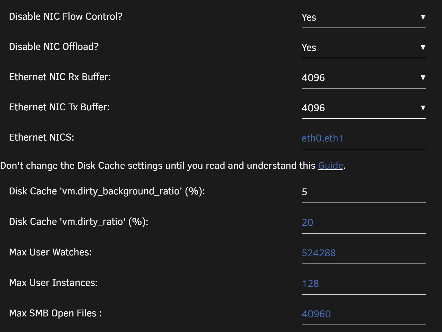

Understood, but I've used this same CPU since the beginning and I know at one point for a long time, I was getting at least 900 MB/s. Hence my confusion. I just haven't been doing large transfers transfers for a while. I will go into the bios and confirm all settings are correct. I will also adjust the performance settings in Tips & Tweaks to see if that charges anything.

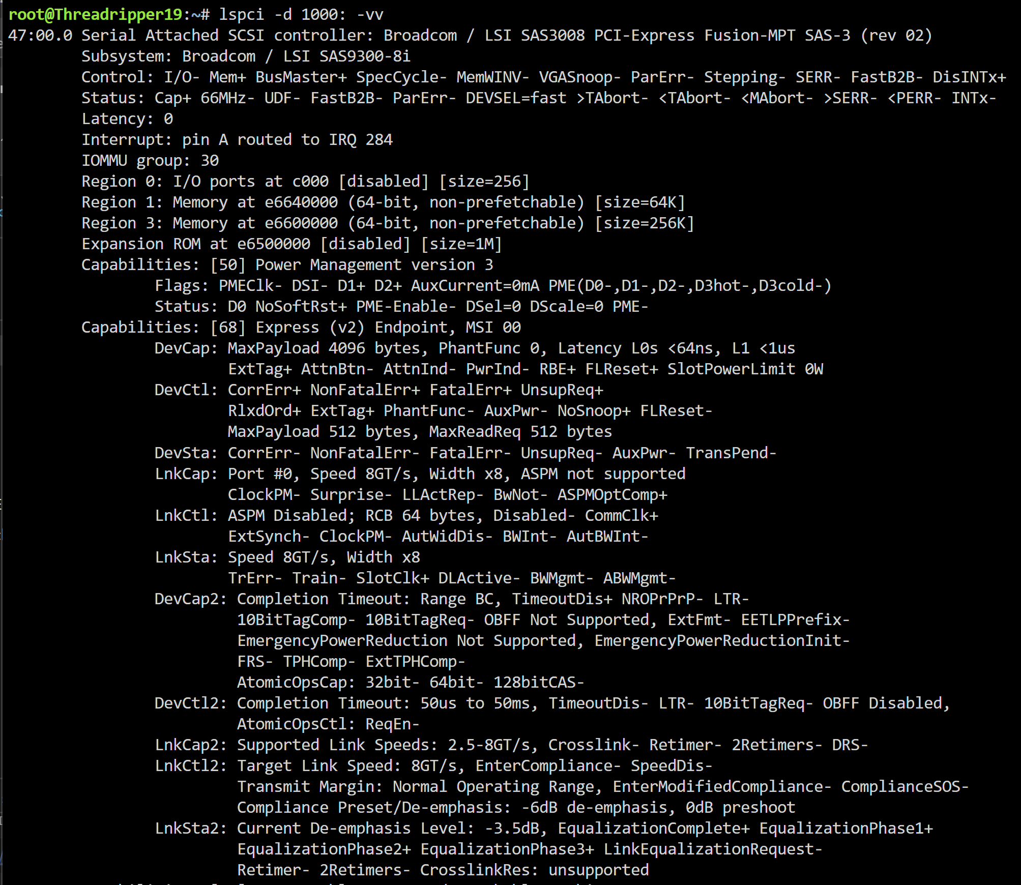

I saw a post where @JorgeB suggested to verify the output of lspci -d 1000: -vv to get the HBA speed/width. I am getting the full 8GT/s and Width of x8. So now, I really have no idea why I can't write to an NVME drive above 450 MB/s.

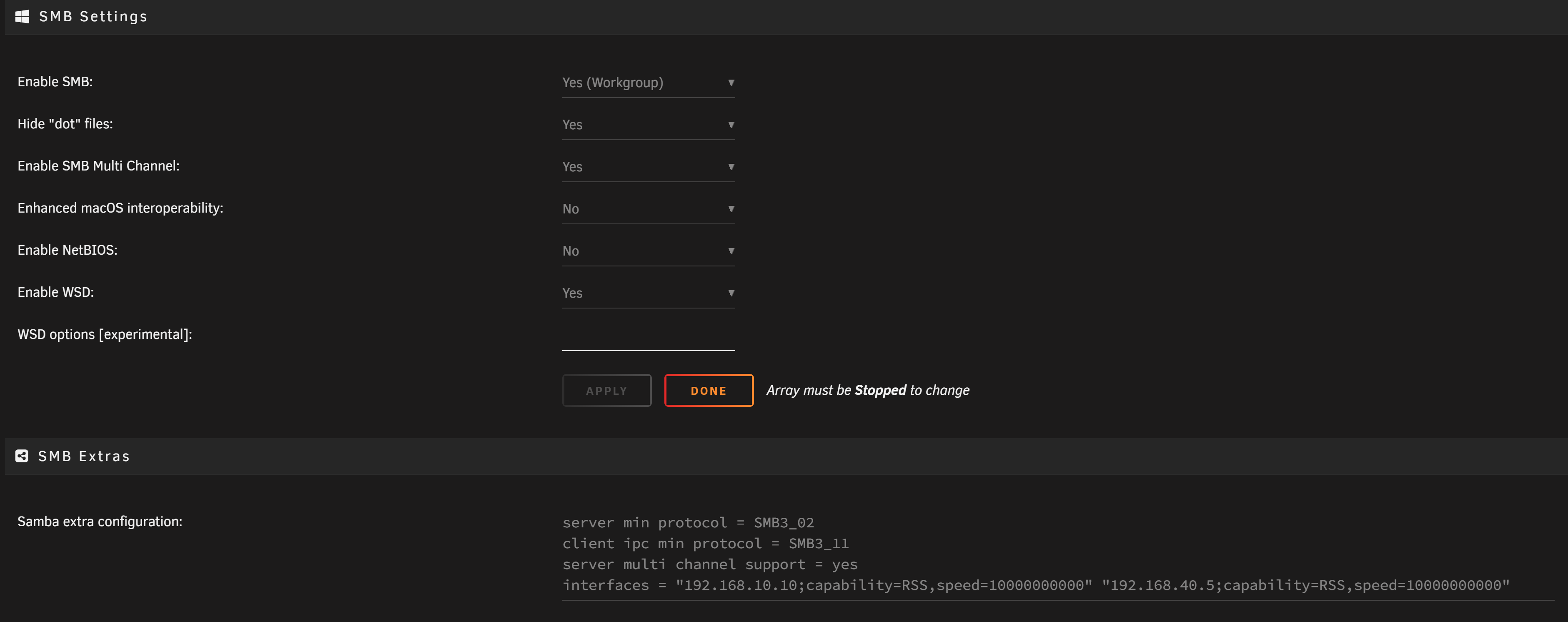

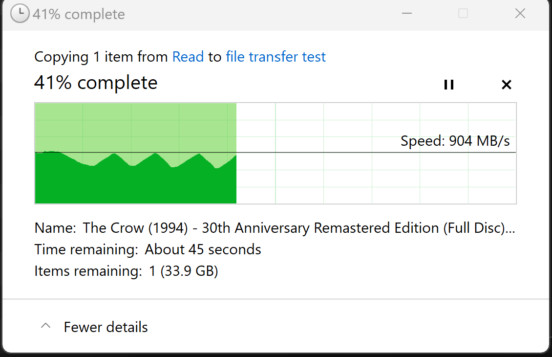

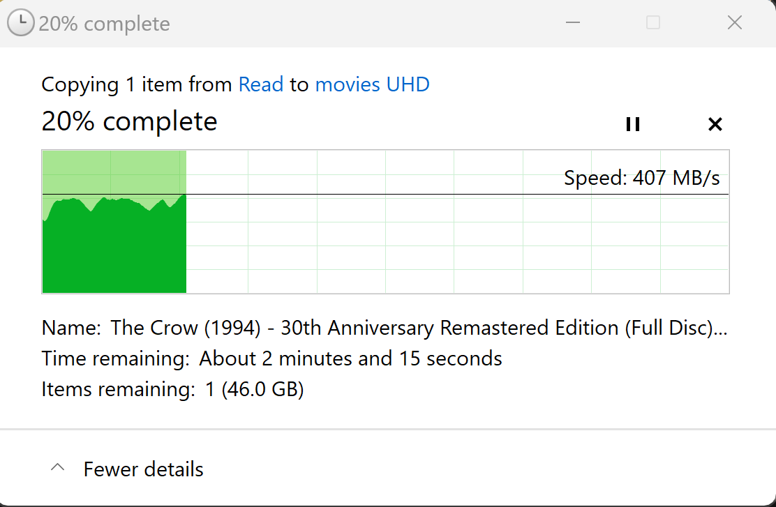

Thanks for looking. I made a new public share called 'file transfer test' on the array cache nvmes. It is shown as 'Exclusive'. Here is the file transher speed: You can see the speed is oscillating between 920 MB/s and 600 MB/s. Now the question is why the oscillating? And will I need to stop using the Array and change over to using Pools? I would be fine with using the Array and have the transfer speed oscillate, but I don't want to go through the hassle of switching to Exclusive shares. Was there an unRAID version change that caused this slow array write speeds?

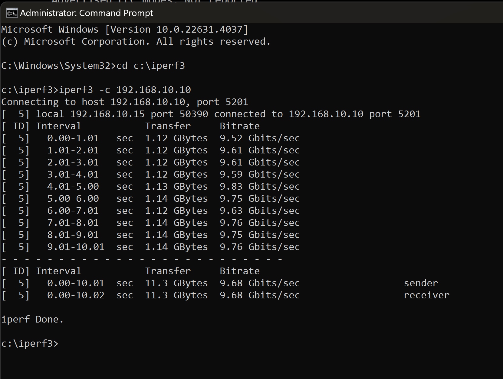

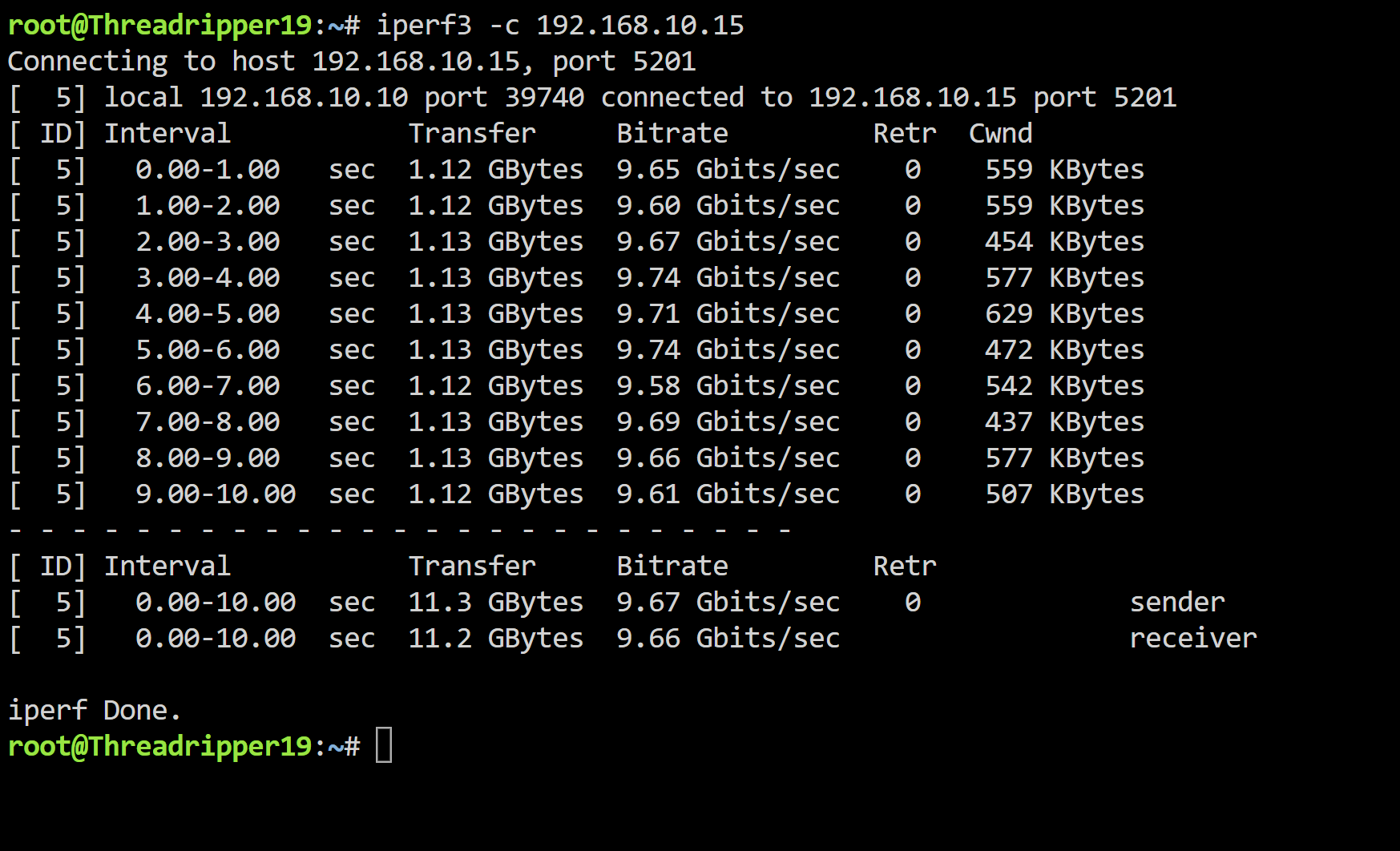

I'm at a loss as what else to try for getting good SMB transfers from my Windows 11 pc to unRAID 6.12.11 using the following: Windows 11 intel x520 t1 running on x16 slot MTU set to 9000 Threadripper 3960x Gigabyte TRX40 Designare 64 GB Corsair Dominator Platinum ram at 3600 speed Samsung 980 Pro nvme unRAID intel x540 t2 running on x16 slot MTU set to 9000 Threadripper 3960x Asus ROG Zenith II Extreme Alpha 64 GB ECC ram nvme cache drives are Corsair Force MP600 1 TB and Sabrent Rocket 4.0 1 TB unifi network gear UDMP USW Pro Aggregation Jumbo Frames enabled Win11 and unRAID machines are connected to USW Pro Aggregation through rj45 sfp+ modules from Ubiquiti I have tried different switch ports, different ethernet cables, different sfp+ modules, different nic adapter settings. I finally got iperf3 to show full 10 GbE speeds after disabling Interruppt Moderation. I can't, however, get my SMB transfers of movie files from my Win11 nvme drive to unRAID above 450 MB/sec. I'm attaching screenshots of relavent info you might ask for. I've gotten 900 MB/sec in a previous version of unRAID, but I don't remember which version. Any help is appreciated. threadripper19-diagnostics-20240827-2126.zip
