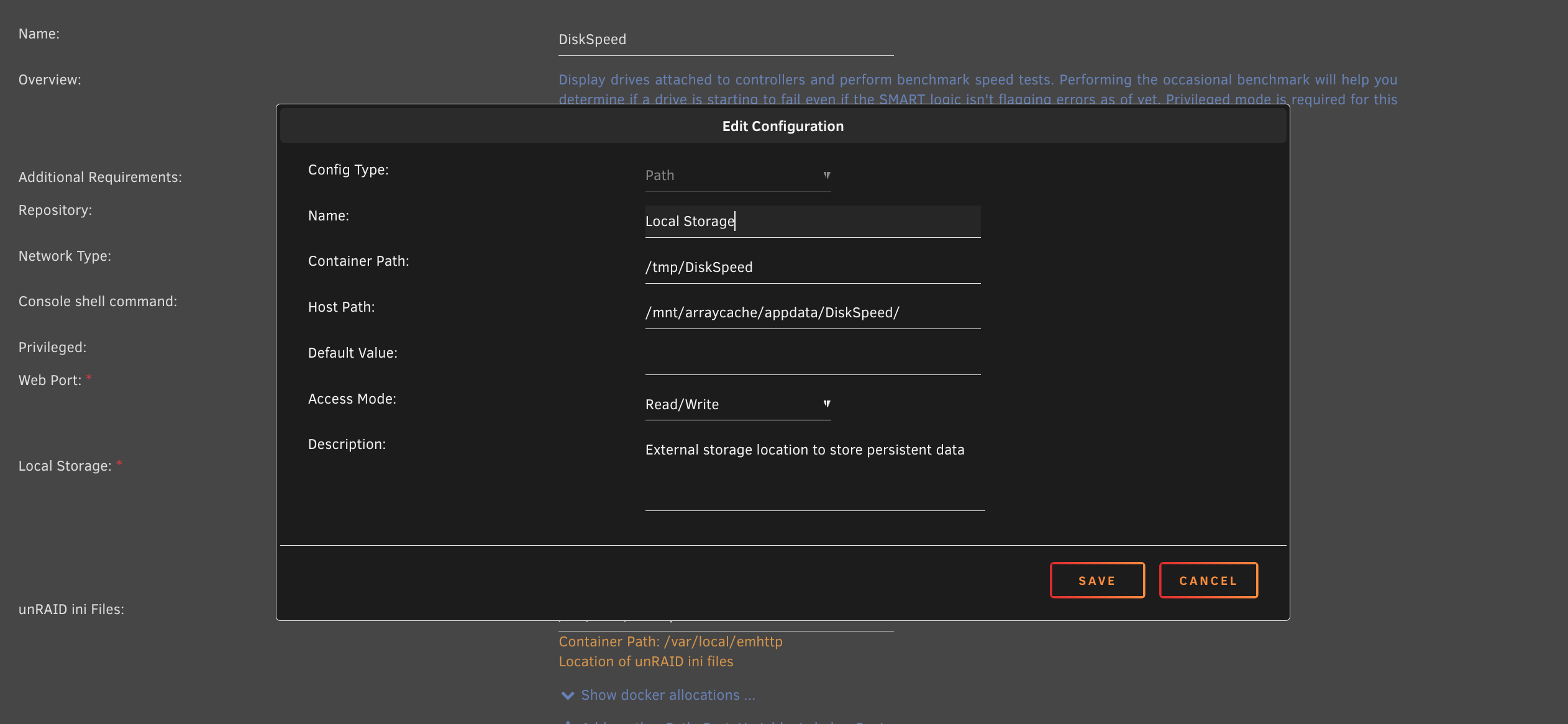

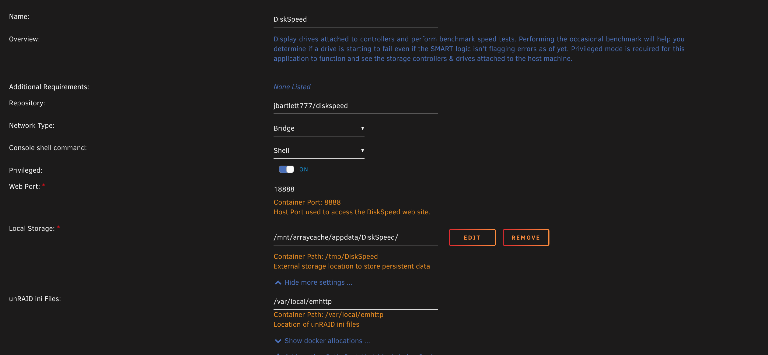

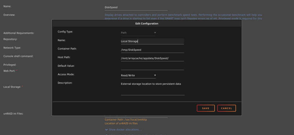

I deleted the DiskSpeed directory, edited the docker image and saved it. It did create a new DiskSpeed directory. I then opened the webgui and the same error popped up: I'm attaching diagnostics. threadripper19-diagnostics-20220927-1314.zip
DiskSpeed, hdd/ssd benchmarking (unRAID 6+), version 2.10.10
I updated DiskSpeed then applied those lines of code. After starting the docker, it still won't start. Here is the error: Here is the docker logs: I also attached the diagnostics. I did not restart my unRAID server during this. If that needs to be done, let me know. Thanks for the help. threadripper19-diagnostics-20220926-1925.zip

I'm unable to use this docker after changing my appdata default location from mnt/user/appdata to mnt/arraycache/appdata. I've uninstalled and reinstalled the docker, including deleting its appdata folder in unraid. When starting the docker, it stays on the 'Scanning Hardware Spinning Up Hard Drives' screen for a long time then displays this error: DiskSpeed - Disk Diagnostics & Reporting tool Version: 2.9.5 Scanning Hardware 22:32:41 Spinning up hard drives Lucee 5.3.7.47 Error (application) Message Error invoking external process Stacktrace The Error Occurred in /var/www/Spinup.cfm: line 137 135: <CFFILE action="write" file="/tmp/DiskSpeedTmp/spinup.sh" mode="766" output="#spinup#" addnewline="NO"> 136: </cflock> 137: <CFEXECUTE name="/tmp/DiskSpeedTmp/spinup.sh" timeout="0" /> 138: <CFELSE> 139: <cflock name="FileWrite" type="exclusive" throwontimeout="true" timeout="10"> called from /var/www/ScanControllers.cfm: line 257 255: </CFOUTPUT> 256: <CFFLUSH> 257: <CFINCLUDE template="Spinup.cfm"> 258: 259: <CFIF FileExists("#PersistDir#/storage.json")> called from /var/www/ScanControllers.cfm: line 250 248: <cfexecute name="/bin/ls" arguments="-l /sys/block" variable="BlockDevices" timeout="90" /> 249: <CFFILE action="delete" file="#PersistDir#/ls_sysblock_exec.txt"> 250: <CFFILE action="write" file="#PersistDir#/ls_sysblock.txt" output="#BlockDevices#" addnewline="NO" mode="666"> 251: 252: <CFOUTPUT> Java Stacktrace lucee.runtime.exp.ApplicationException: Error invoking external process at lucee.runtime.tag.Execute.doEndTag(Execute.java:259) at spinup_cfm$cf.call(/Spinup.cfm:137) at lucee.runtime.PageContextImpl._doInclude(PageContextImpl.java:945) at lucee.runtime.PageContextImpl._doInclude(PageContextImpl.java:837) at lucee.runtime.PageContextImpl.doInclude(PageContextImpl.java:818) at scancontrollers_cfm$cf.call_000005(/ScanControllers.cfm:257) at scancontrollers_cfm$cf.call(/ScanControllers.cfm:250) at lucee.runtime.PageContextImpl._doInclude(PageContextImpl.java:945) at lucee.runtime.PageContextImpl._doInclude(PageContextImpl.java:837) at lucee.runtime.listener.ClassicAppListener._onRequest(ClassicAppListener.java:64) at lucee.runtime.listener.MixedAppListener.onRequest(MixedAppListener.java:43) at lucee.runtime.PageContextImpl.execute(PageContextImpl.java:2416) at lucee.runtime.PageContextImpl._execute(PageContextImpl.java:2406) at lucee.runtime.PageContextImpl.executeCFML(PageContextImpl.java:2381) at lucee.runtime.engine.Request.exe(Request.java:43) at lucee.runtime.engine.CFMLEngineImpl._service(CFMLEngineImpl.java:1170) at lucee.runtime.engine.CFMLEngineImpl.serviceCFML(CFMLEngineImpl.java:1116) at lucee.loader.engine.CFMLEngineWrapper.serviceCFML(CFMLEngineWrapper.java:97) at lucee.loader.servlet.CFMLServlet.service(CFMLServlet.java:51) at javax.servlet.http.HttpServlet.service(HttpServlet.java:733) at org.apache.catalina.core.ApplicationFilterChain.internalDoFilter(ApplicationFilterChain.java:231) at org.apache.catalina.core.ApplicationFilterChain.doFilter(ApplicationFilterChain.java:166) at org.apache.tomcat.websocket.server.WsFilter.doFilter(WsFilter.java:53) at org.apache.catalina.core.ApplicationFilterChain.internalDoFilter(ApplicationFilterChain.java:193) at org.apache.catalina.core.ApplicationFilterChain.doFilter(ApplicationFilterChain.java:166) at org.apache.catalina.core.StandardWrapperValve.invoke(StandardWrapperValve.java:202) at org.apache.catalina.core.StandardContextValve.invoke(StandardContextValve.java:97) at org.apache.catalina.authenticator.AuthenticatorBase.invoke(AuthenticatorBase.java:542) at org.apache.catalina.core.StandardHostValve.invoke(StandardHostValve.java:143) at org.apache.catalina.valves.ErrorReportValve.invoke(ErrorReportValve.java:92) at org.apache.catalina.valves.AbstractAccessLogValve.invoke(AbstractAccessLogValve.java:690) at org.apache.catalina.valves.RemoteIpValve.invoke(RemoteIpValve.java:747) at org.apache.catalina.core.StandardEngineValve.invoke(StandardEngineValve.java:78) at org.apache.catalina.connector.CoyoteAdapter.service(CoyoteAdapter.java:343) at org.apache.coyote.http11.Http11Processor.service(Http11Processor.java:374) at org.apache.coyote.AbstractProcessorLight.process(AbstractProcessorLight.java:65) at org.apache.coyote.AbstractProtocol$ConnectionHandler.process(AbstractProtocol.java:868) at org.apache.tomcat.util.net.NioEndpoint$SocketProcessor.doRun(NioEndpoint.java:1590) at org.apache.tomcat.util.net.SocketProcessorBase.run(SocketProcessorBase.java:49) at java.base/java.util.concurrent.ThreadPoolExecutor.runWorker(ThreadPoolExecutor.java:1128) at java.base/java.util.concurrent.ThreadPoolExecutor$Worker.run(ThreadPoolExecutor.java:628) at org.apache.tomcat.util.threads.TaskThread$WrappingRunnable.run(TaskThread.java:61) at java.base/java.lang.Thread.run(Thread.java:834) Timestamp 9/23/22 10:37:45 PM EDT Here is the log: My Plex docker works completely fine with zero issues after changing the appdata default location. Could anyone tell me what the problem is. I'm attaching my diagnostics and a screenshot of the docker edit screen. Thanks threadripper19-diagnostics-20220923-2249.zip
