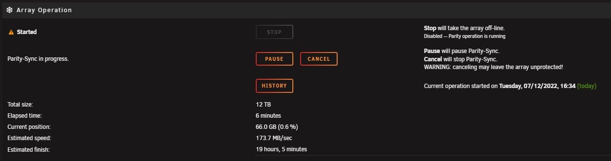

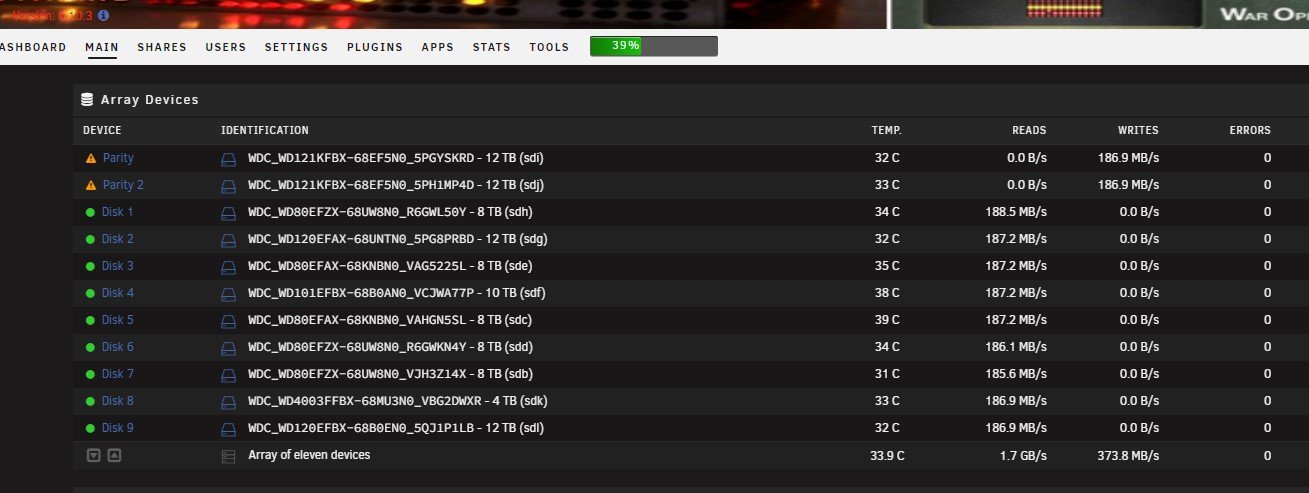

BIOS changes that reverted: -Global C-States to Auto from Enabled -IOMMU to Auto from Enabled Parity-Sync speeds back to normal 165~185MB/sec. I'll leave well enough alone now. Any issues with leaving those two settings to Auto? threadripper19-syslog-20220712-2109.zip

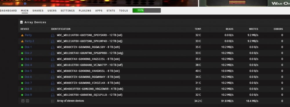

Just rebooted and started Parity-Sync after making those BIOS changes and what do you know, 10-14MB/sec writes! So there's obviously something wrong with the BIOS. I'm going to revert the BIOS changes I made and see if the performance comes back. Hopefully it does. I also just realized I attached the syslog, not the diagnostics to my previous post. Sorry. threadripper19-syslog-20220712-2109.zip

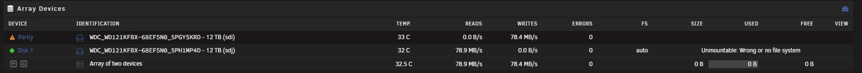

@Vr2Io Testing old parity disks with one as Parity and one as a Data disk: No change. I did see 212MB/sec. for the first second, but it quickly fell off to ~80-100MB/sec. I'm definitely going to contact Asus and see how they can compensate me.

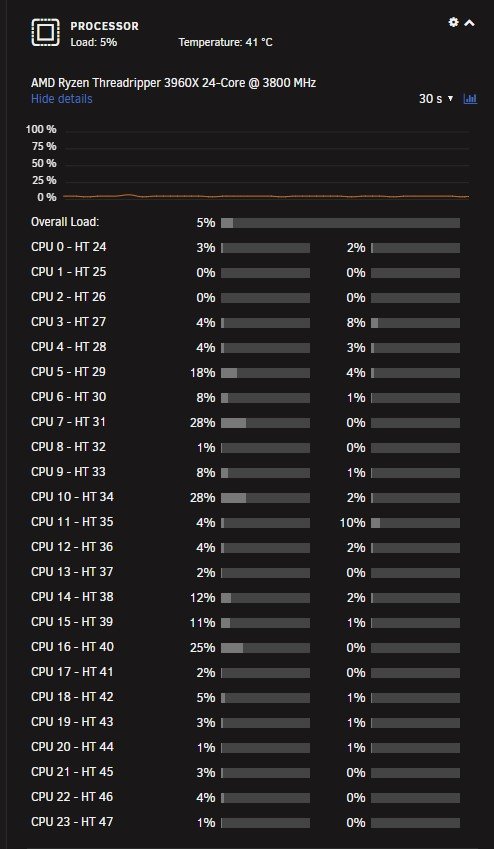

Well it somewhat worked, though I'm only getting around 60MB/sec. It occasionally spikes up into the 80MB/sec range. CPU usage is like before: This still isn't anywhere near the 180MB/sec. I should be seeing. What are your thoughts on this?? threadripper19-diagnostics-20220705-2234.zip

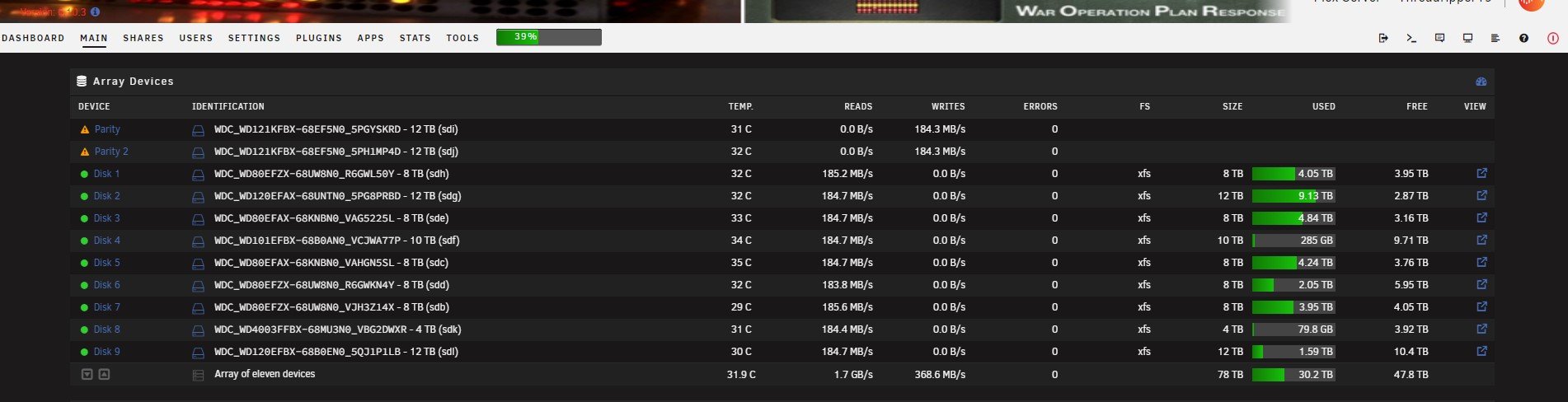

After rebuilding my server and setting everything up, I finally added my two WD Red Pro disks back as Parity. The first time I tried adding the two parity disks, it was running at 10MB/sec. I canceled that, rebooted my server and tried again. This time the performance is worse. It's currently running at 8MB/sec. I ran all disks through the DiskSpeed docker and all disks looked great. I know some disks are old, but I've been able to transfer data to my array at the normal 110-120MB/sec. I canceled the Parity-Sync so I could grab the DiskSpeed graph. After stopping my array, setting my two parity drives, and starting the array, the speed is still slow at 8.7MB/sec. Anyone have an idea of why the sync is so slow? On version 6.10.3. All plugins updated. Two parity drives are WD Red Pro's. Array disk are all WD with a mix of red, red plus, and pro. threadripper19-diagnostics-20220704-2135.zip
