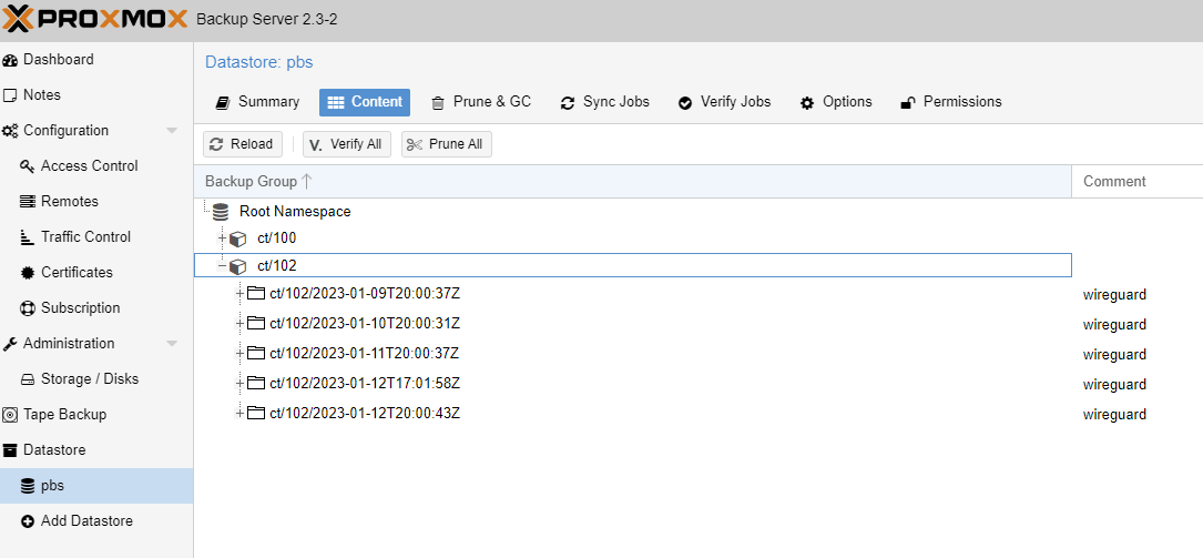

I posted a screenshot of my pbs Datastore in my answer above in the spoiler but I can post another one. You look for something special? I can also delete the Datastore, my backups are not really necessary for me system.

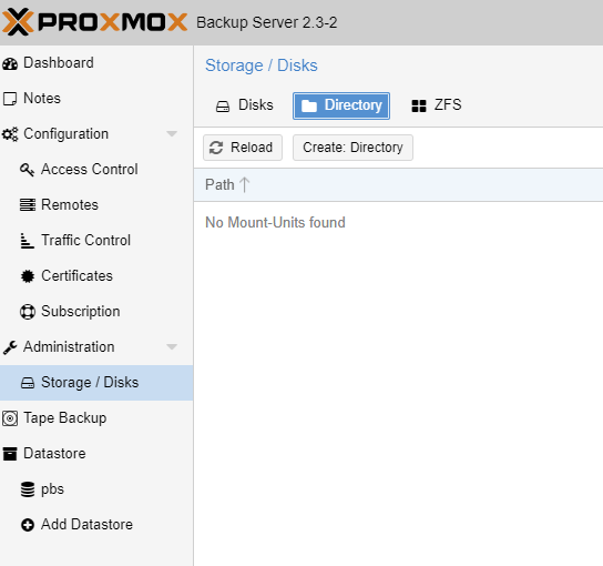

It looks like i mounted my backups folder (datastore) directly in the docker.img. The docker console shows # ls backup backups bin boot dev etc home lib lib64 media mnt opt proc root run runit sbin src srv sys tmp usr var And here is what my Storage / Disk tabs looks like Can anyone help me to mount the right folder in my backup share? I don´t get it. Thanks

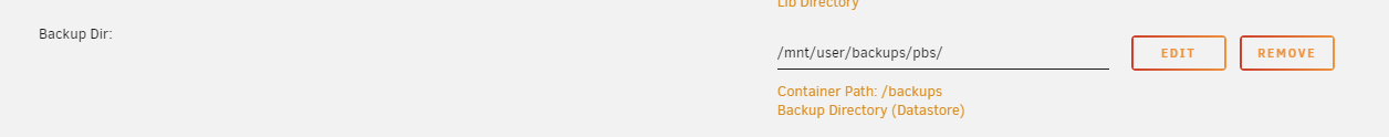

Hello everyone, first thanks for the container 👍 But I also have a question. I set the Backup Dir to /mnt/user/backups/pbs/ that´s the share where all my backups live In the container the added a Datastore named pbs with the \backups path like in the Backup Dir discription at the container settings. Backups work fine but I can´t find the backup files in /mnt/user/backups/pbs/ folder it just showes an empty folder. Can anyone help me to find the files or tell me what I did wrong? Thanks a lot
