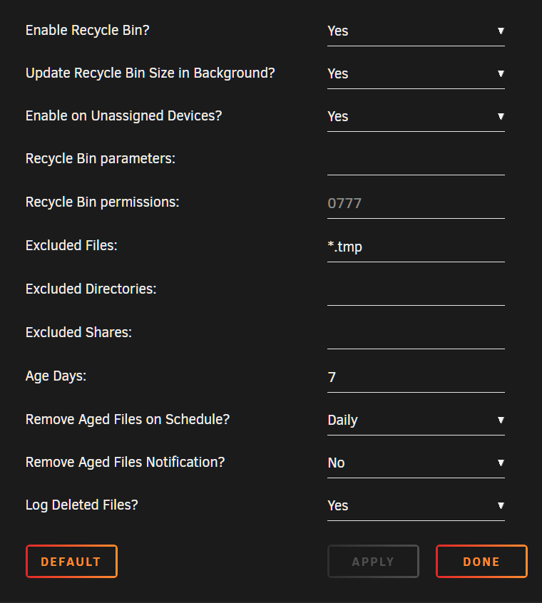

  5. Hello dlandon, I just installed the plug-in, however, it only works for Unassigned Share. Could you take a quick look at my diagnostics data? I also included a screenshot of the settings. I really appreciate what you are doing here. milkyway-diagnostics-20230425-1717.zip

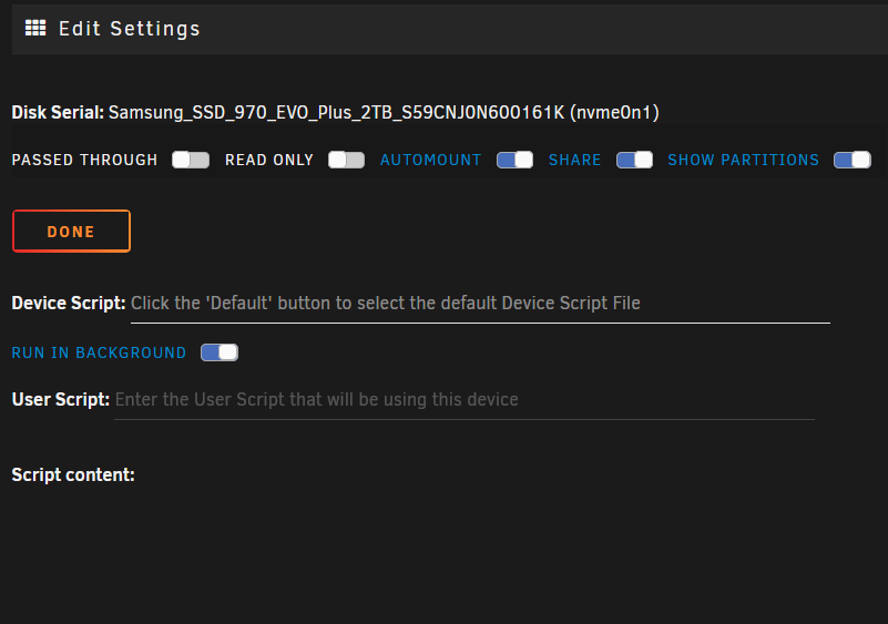

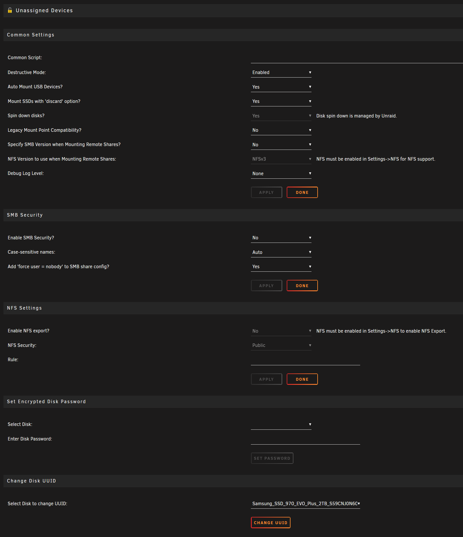

  10. First of all, I thank you for the great plugin. Since last update I cannot mount one of unassigned drive. The update was on December 7. I think there was another updated I installed but I didn't restart the Unraid Server. Anyhow, after restart, the drive was not auto-mounted. This is the log from syslog. Dec 8 15:16:27 MilkyWay unassigned.devices: Error: Mount point 'vm_storage' - name is reserved, used in the array or by an unassigned device. Dec 8 15:16:27 MilkyWay unassigned.devices: Disk with serial 'Samsung_SSD_970_EVO_Plus_2TB_S59CNJ0N600161K', mountpoint 'vm_storage' cannot be mounted. I updated Mount Point name to something different, virtual_machine, vm_image, and so on. But it does not work. I also tried setting "Legacy Mount Point Compatibility?" to Yes Any ideas? FYI, here's what I have.
