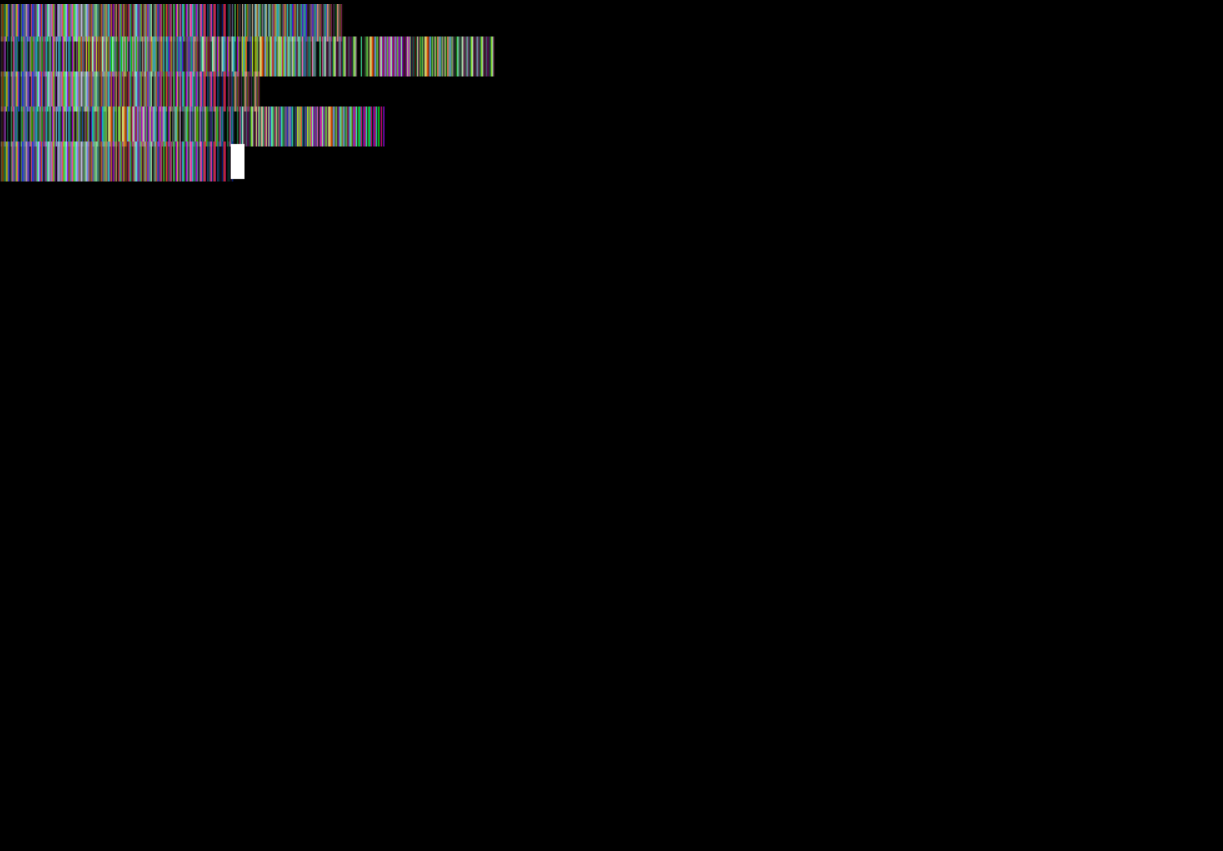

  4. /media is the share that I am trying to copy to. I can copy to some folders but not others. This share is split over two data disks. I did try running the command that you suggested but it is a bit hard to see the output through the multicoloured bars in the Unraid terminal. No matter which PC I use I get the bars in the terminal.

  13. Thanks! How do I edit the /boot/config/go file? Is it using the terminal in the Unraid GUI? (I hope not since any text there is covered by a multicoloured blur for some reason in Unraid 6.9.2).
