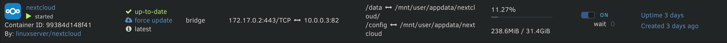

  2. Is this a next cloud specific thing or for all unraid containers. Do I run the manual occ update?
  3. I'm currently on nextcloud 19.0.1 and for some reason my docker container wont prompt me to update, and when I try force update it reinstalls 19.0.1. I can ping hub.docker.com from both unraid and the nextcloud docker container so I don't believe it's an network error. What can I do for troubleshooting in terms of why the docker updater isnt pulling the latest image?
