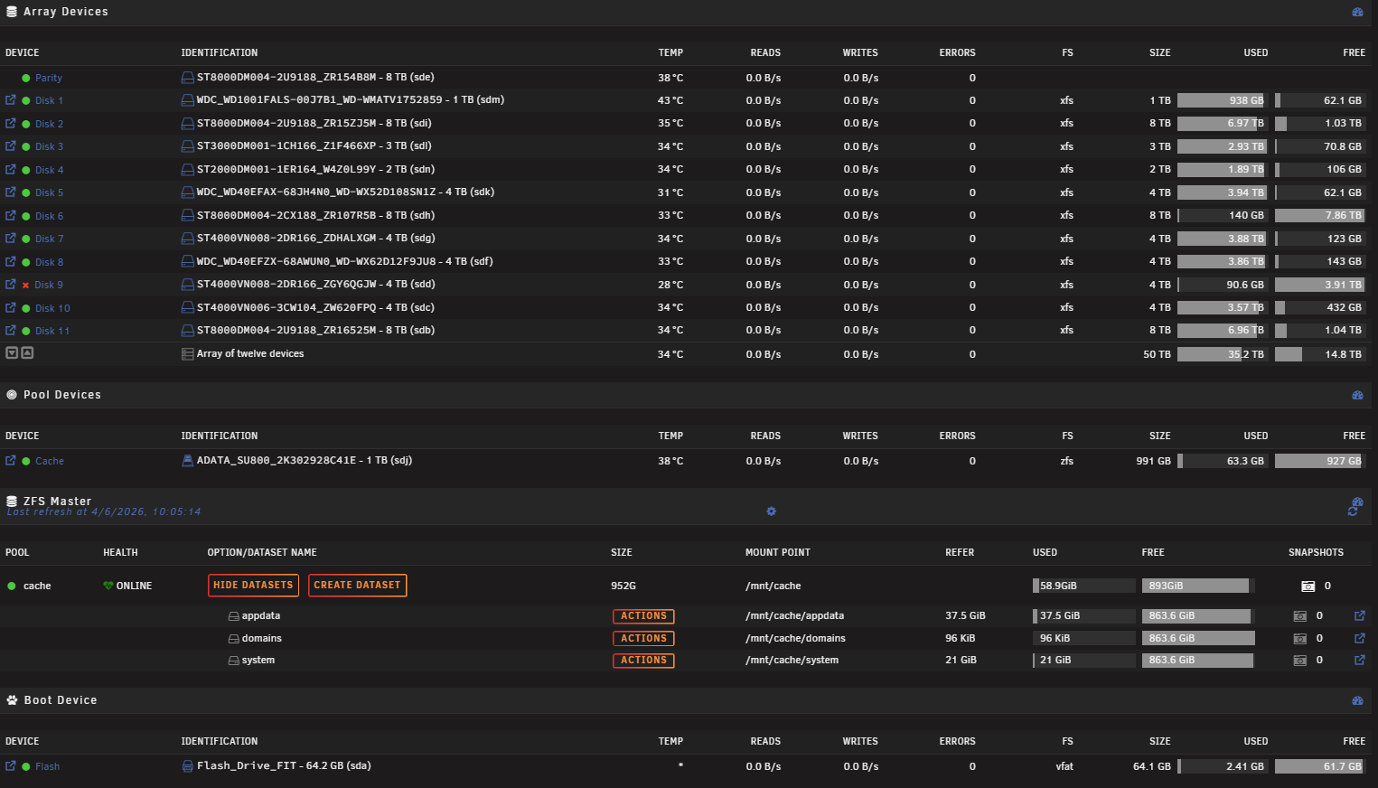

The parity sync is completed and array seams to work normally. See latest Diagnostics file attached. Now I need to restore my data from the backups. I guest the easiest would be to copy the backups from my PC to the unRAID Shares over the network. unraid-diagnostics-20260410-0915.zip

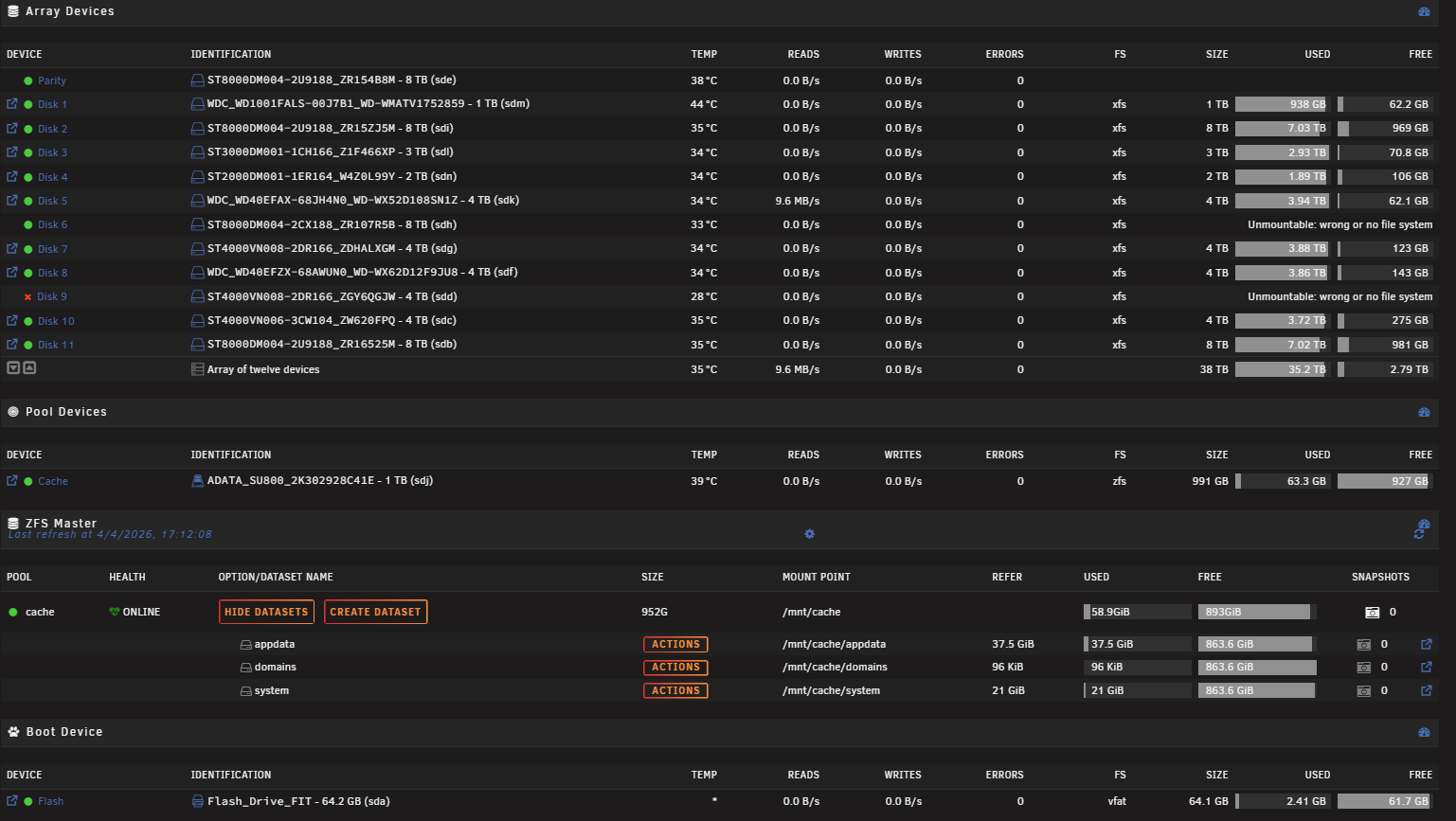

Thanks trurl. I ran the file system check on both disks using the GUI. Both were showing a long list of errors, so I clicked the FIX button. For disk 9 only, the ZERO LOG button appeared and I used it. At the end of the process, I got the message "File system corruption fixed" for both disks. I stopped the array and restart in normal mode. Now the disk 6 and 9 are showing almost empty, and disk 9 is being emulated (red "X" in the GUI). I have no access to files on either of these disks through the Unraid shares. What should I do next?- Filesystem Corruption (XFS) on Multiple Disks (6 & 9) Following Rebuild

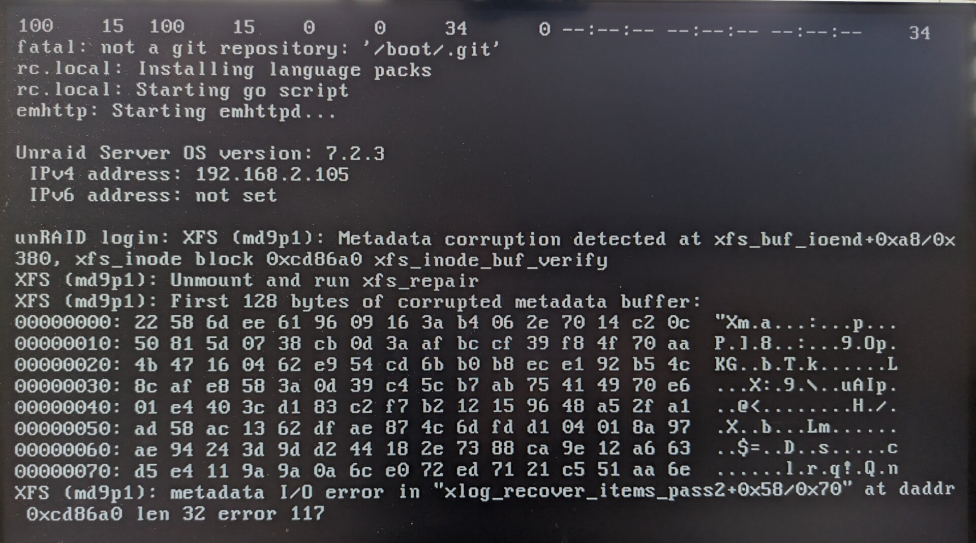

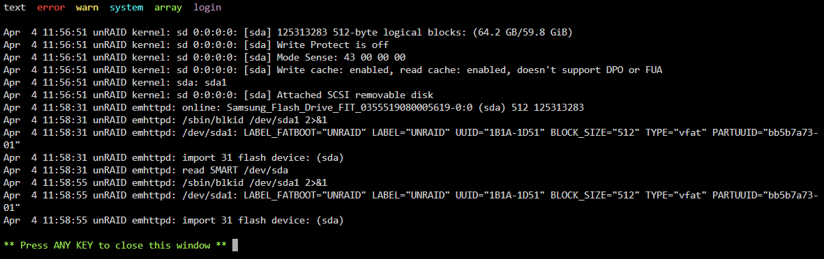

Description of Issue: I recently completed a rebuild of Disk 6 from Parity. Following the subsequent reboot, both the newly rebuilt drive (Disk 6) and an existing drive (Disk 9) are showing as "Unmountable: Unsupported or no file system. Current Array Status: The array is started, but: Disk 9 is being emulated (red "X" in the GUI). Both Disk 6 and the emulated Disk 9 are listed as unmountable. I currently have no access to files on either of these disks through the Unraid shares. Console Corruption Errors: The physical console displays critical XFS metadata corruption errors for Disk 9 (md9p1): XFS (md9p1): Metadata corruption detected at xfs_buf_ioend... XFS (md9p1): Unmount and run xfs_repair XFS (md9p1): metadata I/O error in "xlog_recover_items_pass2..." Hardware Configuration: The two affected disks are on separate controllers: Disk 6: Connected via an LSI SAS HBA card. Disk 9: Connected via the onboard SATA port on the motherboard. Boot Flash: Samsung Flash Drive FIT (Logs show normal initialization as sda, despite intermittent -71 enumeration errors during boot). Troubleshooting Steps Taken: External Verification: I pulled the physical Disk 9 and connected it to a Windows machine via SATA dock. DiskInternals Linux Reader confirmed the data is intact and readable, but Unraid cannot mount the emulated version. Services: Plex Media Server is down as a result. OS Version: 7.2.3 Questions for the Community: What is the safest way to proceed? Thanks in advance for your help! unraid-diagnostics-20260404-1632.zip- Unsupported or no file system. Emulated drive is missing data.
