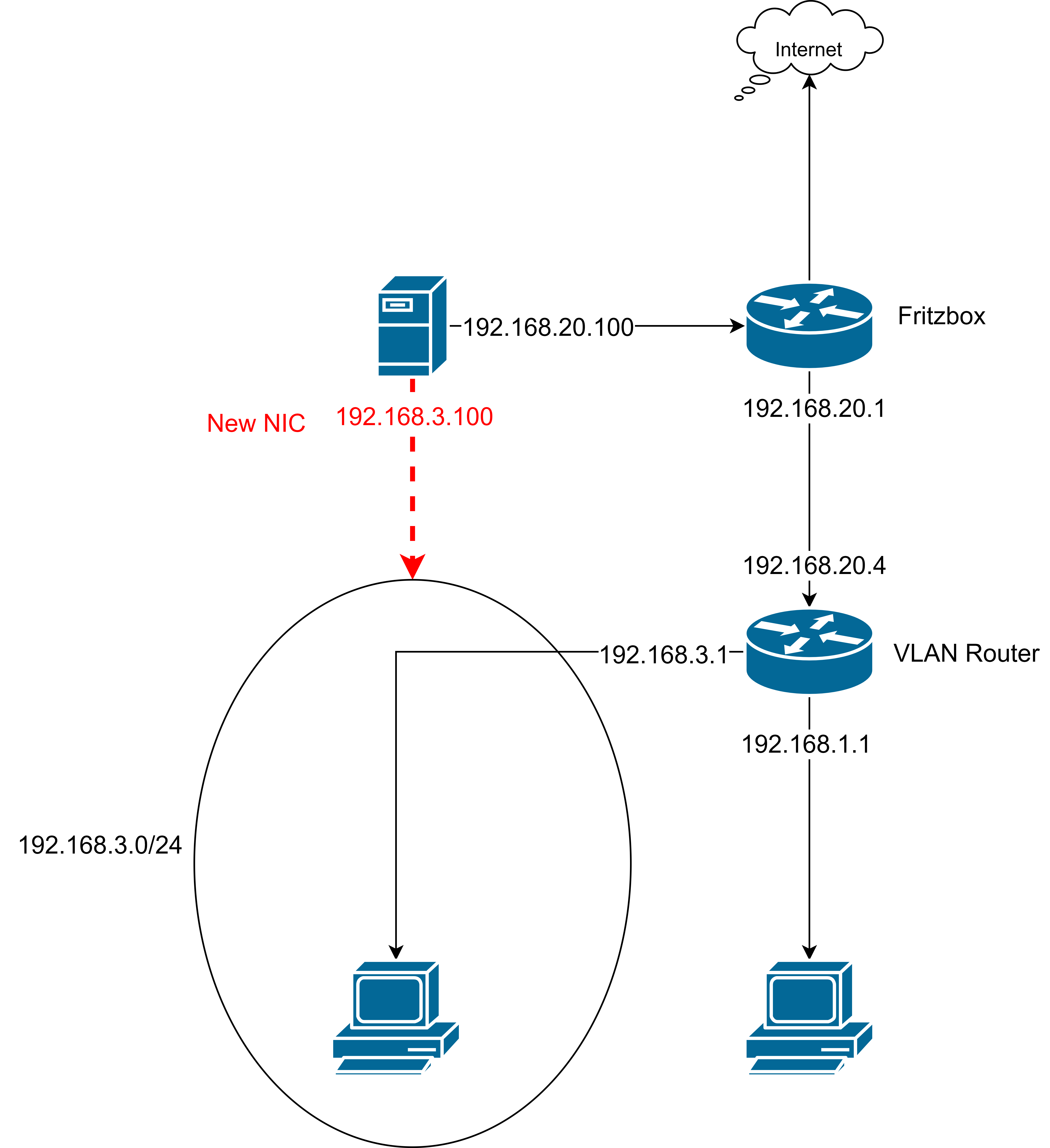

Hello Everyone, Right now i have routes from/to my Server to reach everything in the 192.168.3.0/24 Subnet. Since broadcasts are not able, but would be convenient for selected services (e.g. Home Asisstant), i thought i could connect a new NIC directly to the 192.168.0.3/24 Network. Sadly this doesn`t work, because request from the network reaching the "old" port x.x.20.100 are going out on the new NIC. This obvious makes sense because it is connected directly to the network, but leads to asymmetrical routes. Is it possible to send traffic back from the same interface it came in? Don´t route between the interfaces? Or maybe any other way to achive this ?

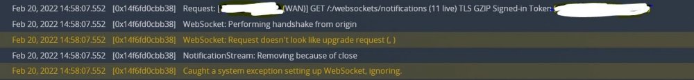

So, i solved those errors with trial and error, but actually have no clue what the hell i did. Could somebody enlighten me ? Did i proxy the plex websockets? why does no one else has these problems ? I added the following lines into the plex.conf: proxy_set_header Upgrade $http_upgrade; proxy_set_header Connection "Upgrade";

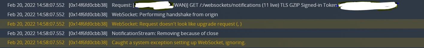

Hello, i am having a lot of error messages in my error.log and have no clue what it could mean. I looked it up in google, but this didnt really help much. As far as i can tell everything works, but these errors are new / i never noticed them. Tried increasing the timeout which didnt help. Error Log example: 2022/02/20 14:40:31 [error] 634#634: *10069 upstream prematurely closed connection while reading response header from upstream, client: xxxxxxx, server: plex.*, request: "GET /:/websockets/notifications?X-Plex-Token=xxxxxxxx-Plex-Language=de-de HTTP/1.1", upstream: "https://192.168.3.100:32400/:/websockets/notifications?X-Plex-Token=QR-xxxxxxxX-Plex-Language=de-de", host: "xxxxxxx" Proxy Config: client_body_buffer_size 128k; #Timeout if the real server is dead proxy_next_upstream error timeout invalid_header http_500 http_502 http_503; # Advanced Proxy Config send_timeout 5m; proxy_read_timeout 240s; proxy_send_timeout 240s; proxy_connect_timeout 240s; # TLS 1.3 early data proxy_set_header Early-Data $ssl_early_data; # Basic Proxy Config proxy_set_header Host $host; proxy_set_header X-Real-IP $remote_addr; proxy_set_header X-Forwarded-For $proxy_add_x_forwarded_for; proxy_set_header X-Forwarded-Proto https; proxy_set_header X-Forwarded-Host $host; proxy_set_header X-Forwarded-Ssl on; proxy_redirect http:// $scheme://; proxy_http_version 1.1; proxy_set_header Connection ""; #proxy_cookie_path / "/; HTTPOnly; Secure"; # enable at your own risk, may break certain apps proxy_cache_bypass $cookie_session; proxy_no_cache $cookie_session; proxy_buffers 32 4k; proxy_headers_hash_bucket_size 128; proxy_headers_hash_max_size 1024; Plex Config: server { listen 443 ssl; listen [::]:443 ssl; server_name plex.*; include /config/nginx/ssl.conf; client_max_body_size 0; proxy_redirect off; proxy_buffering off; # enable for ldap auth, fill in ldap details in ldap.conf #include /config/nginx/ldap.conf; # enable for Authelia #include /config/nginx/authelia-server.conf; location / { # enable the next two lines for http auth #auth_basic "Restricted"; #auth_basic_user_file /config/nginx/.htpasswd; # enable the next two lines for ldap auth #auth_request /auth; #error_page 401 =200 /ldaplogin; # enable for Authelia #include /config/nginx/authelia-location.conf; include /config/nginx/proxy.conf; resolver 127.0.0.11 valid=30s; set $upstream_app 192.168.3.100; set $upstream_port 32400; set $upstream_proto https; proxy_pass $upstream_proto://$upstream_app:$upstream_port; proxy_set_header X-Plex-Client-Identifier $http_x_plex_client_identifier; proxy_set_header X-Plex-Device $http_x_plex_device; proxy_set_header X-Plex-Device-Name $http_x_plex_device_name; proxy_set_header X-Plex-Platform $http_x_plex_platform; proxy_set_header X-Plex-Platform-Version $http_x_plex_platform_version; proxy_set_header X-Plex-Product $http_x_plex_product; proxy_set_header X-Plex-Token $http_x_plex_token; proxy_set_header X-Plex-Version $http_x_plex_version; proxy_set_header X-Plex-Nocache $http_x_plex_nocache; proxy_set_header X-Plex-Provides $http_x_plex_provides; proxy_set_header X-Plex-Device-Vendor $http_x_plex_device_vendor; proxy_set_header X-Plex-Model $http_x_plex_model; } } Errors in Plex:

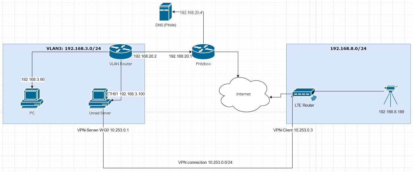

Update: I narrowed it down to the VLAN Router. Somehow it doesn't route correct. I set a route directly on my windows pc and can now connect to the devices on the .8.0 net. So for anyone reading this, a Server to Server connection is not mandatory if you want to connect devices from between all networks.

Maybe this network drawing helps. So, 192.168.8.0 (client) can connect to 192.168.3.0 (server) but not the other way around. Since the client is an LTE Router (Gl-AP 1300, Openwrt) its not that easy to let it work as a server. (Carrier-grad NAT for IPv4) Also beeing new to Openwrt doesnt really help. I set folllowing static routes on the VLAN router: - DestIP 192.168.8.0/24 GW 192.168.3.100 - DestIP 10.253.0.0/24 GW 192.168.3.100 The routes for Unraid where set automaticlly and are: - 192.168.8.0/24 wg0 - 10.253.0.3 wg0 I did not set any routes on the LTE Router. Allowed IPs on -Client Side 0.0.0.0/0 -Server Side 10.253.0.3, 192.168.8.0/24 I did not touch any Firewall settings.

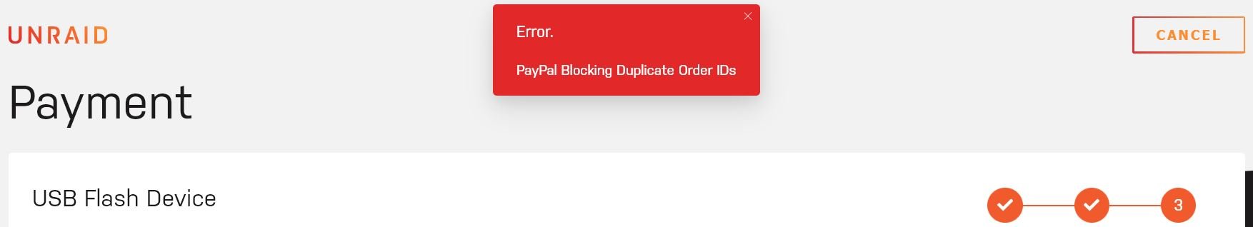

Hello, i cant upgrade my key with paypal. I'm getting the error "PayPal Blocking Duplicate Order IDs" Is it an Error on my Side? Paypal side? Lime Side?
